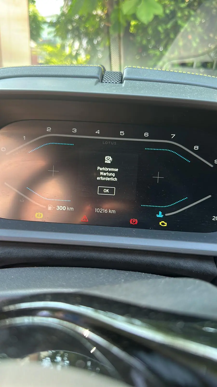

Parking brake service message & wont start - how many others with this issue

I'm not sure why the last update seems to trigger this more often for you guys, but the bug existed as early as the 4th of April. Interestingly enough it never happened again for me. However I hit the known ESC error just today - didn’t see that for about 8k km either, so might mean nothing..
Sorry already lost the overview of all the errors 😂
The ESC error I hit yesterday is exactly the same and it’s just happened again. Also after the latest update so yeah - count me in hahahaha haha ha ha..
I also have this problem. Car has been with the dealer for over 4 weeks. Problem was created by the software “upgrade”. They have told me today they are awaiting a solution from Lotus UK with no idea of when it might be resolved. I have had the car since May 23 and it has been in the garage about 6 times since. Very similar to the 2 Emiras I had in the past. Lotus are now paying for my hire car but I’m starting to lose patience.
