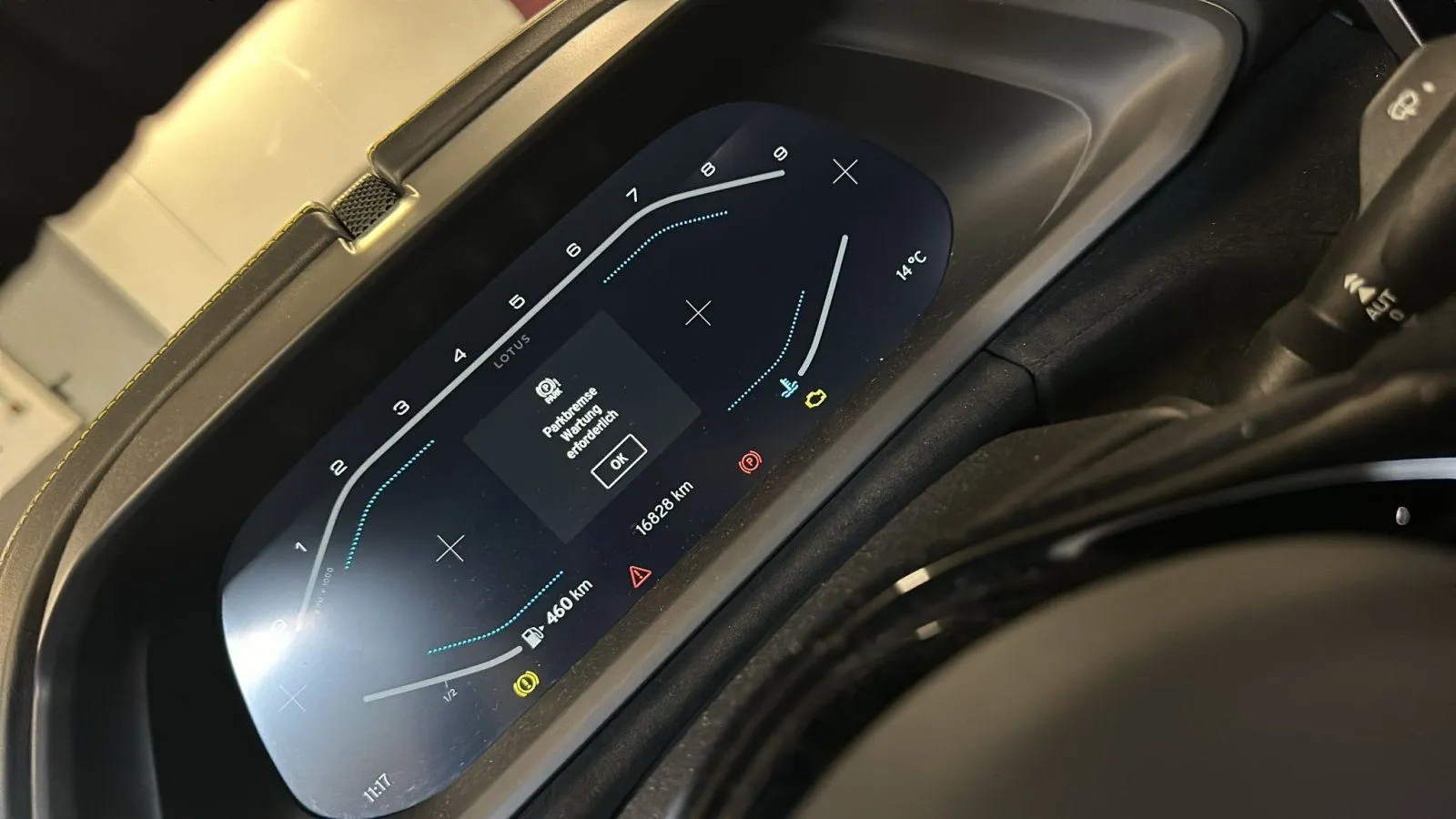

Parking brake service message & wont start - how many others with this issue
What message are you getting on the display when it won’t start
I don't get any message. It just doesn't start.
There seem to be so many different versions of the issue (or different but similar ones). Mine had parking brake error message before it every time. Now fine having gone back to previous software version
Always getting the parking brake error

Without getting out:
  1. Open door
  2. Close door
  3. Lock
  4. Wait 2mins
  5. Unlock
  6. Wait a few seconds until the display activates
  7. Open door
  8. Close door
  9. Should start now 🎉
No error messages but the engine warning light comes on.
