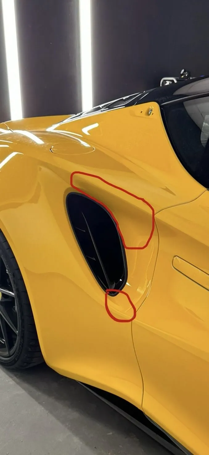

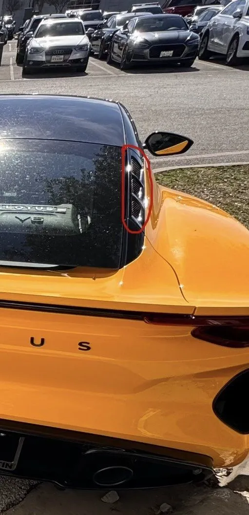

For those that did full body PPF. Do you mind sharing pictures of these areas? I’m curious to see how other installers are approaching them

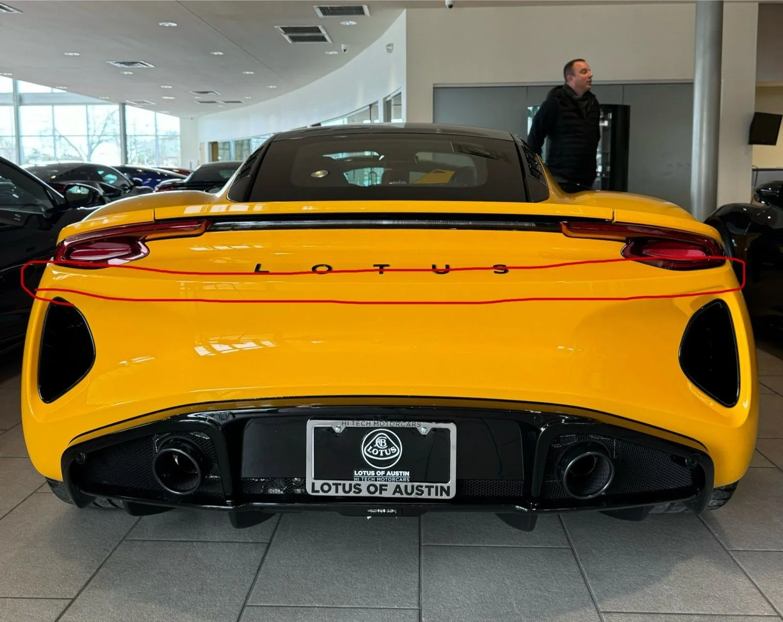

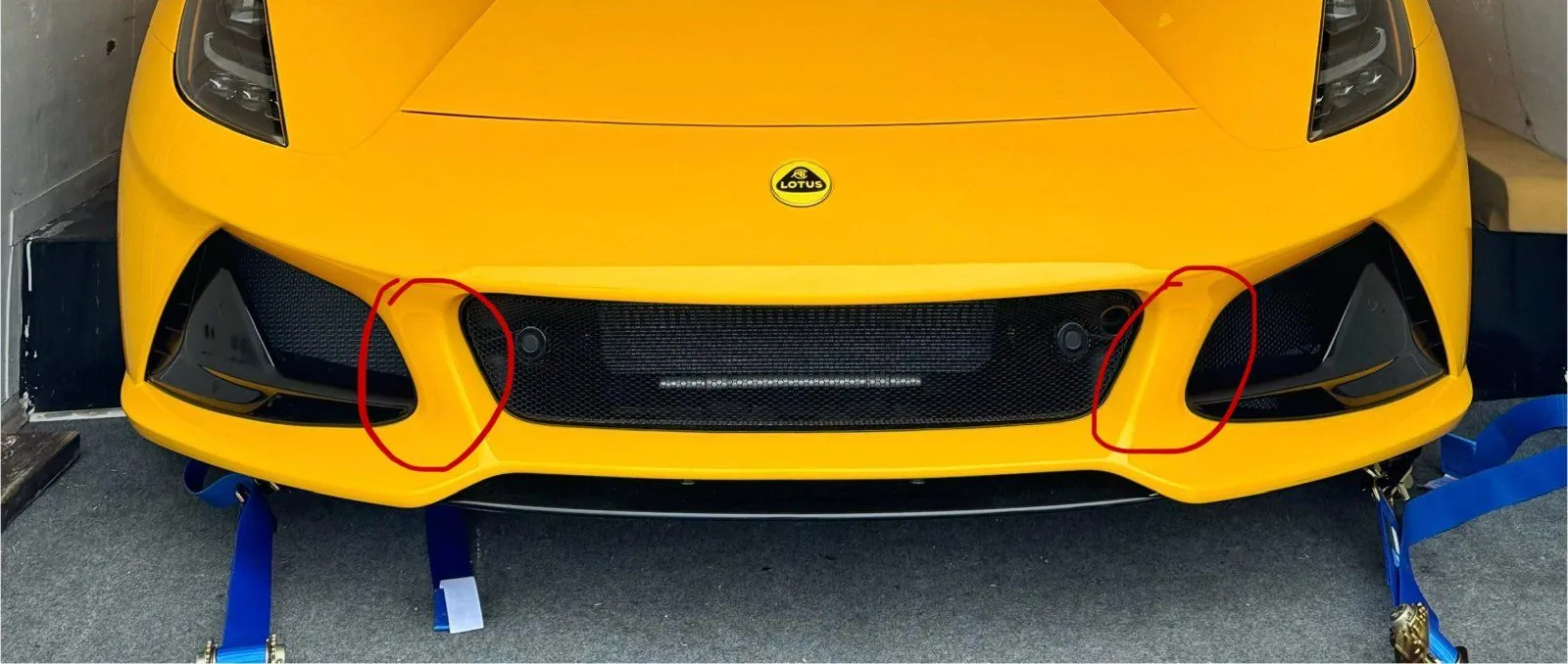

My PPF installer has had my car for several weeks (long story). I've been there to check in a few times, and he showed me a few things. He is using Xpel. The rear bumper is two pieces and is split at the line you have in red. The upper part with the Lotus emblem is separate from the lower part. I was not expecting that, but it is shown in their online description of their kit (link below).
On the side section by the scoop, there is a cut out relief, and then a small pie shape piece is installed. Not ideal, but the installer thinks the film may lift there without it.
If you look at the Xpel website, there appears to be a number of relief cuts in the front bumper area. My guy has not gotten to that section yet, but it should be interesting.
