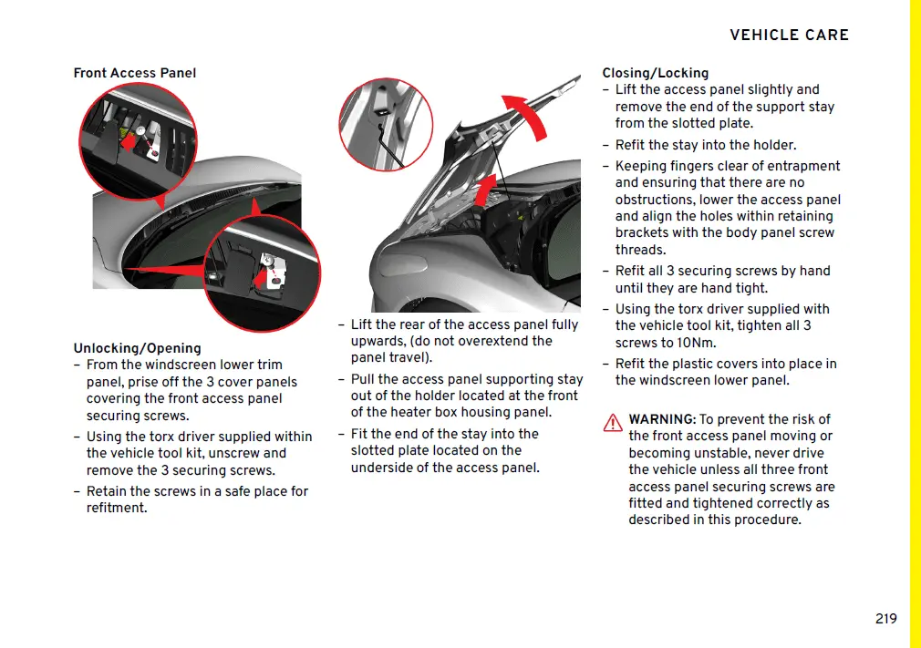

Possibly stupid question: anyone know if the "frunk that's not a frunk" cover has to be removed to do PPF on the front of the car? Was this an issue? Maybe fretting too much but concerned about aftermarket installers trying to open that cover without special knowledge.
Doesn't have to be fully removed off it's hinges, but the installer will need to tilt it up to apply PPF to the overlapping areas on both sides.
Just provide them with a copy of the appropriate page from the manual, should give them all the knowledge they need.

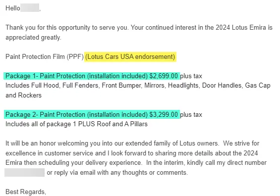

My dealer has provided me with some details regarding a "Lotus approved" PPF option for the front of the car, or optionally the front plus the roof. He says it's the same service (from the same vendor) that was available for the Evora GT.
I'm wondering if this is a genuinely high-quality option from a detailing perspective, or if it's simply a "get it done" me-too sort of service that Lotus happens to be granting approval on. Does anyone on the forum who bought an Evora GT have any feedback on this?
I believe all Evora GT’s had PPF done before they arrived at dealerships and the cost was bundled into the MSRP.
Panel coverage was very similar to Package 1, minus door handles and gas cap. Mine is holding up just fine after 3 years. Installation is a template cut and edges are not wrapped.
