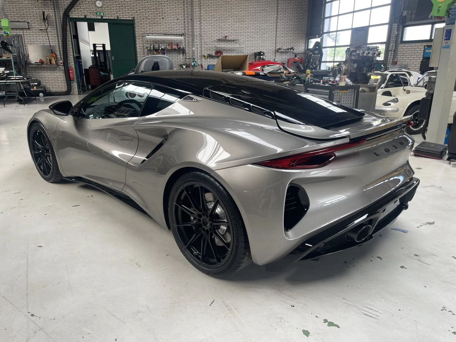

Another box ticked. PPF needs to dry a long time, so that all fluids have evaporated from underneath the film. Today the ceramic glass coating has been applied. Car is out in the sun to dry/harden the coating. Paint was fully polished before coating. The paints on the Emira from Lotus are not what they should be, way too soft and the paint easily scratches, hence my desire to polish and protect it with a ceramic glass coating. Including the black roof.
Car in the sun looks stunning. The coating definitely adds depth to the overall paint and presence. First time I saw the car outside. So in love with it! Looks like a 300k euro car now ;-)

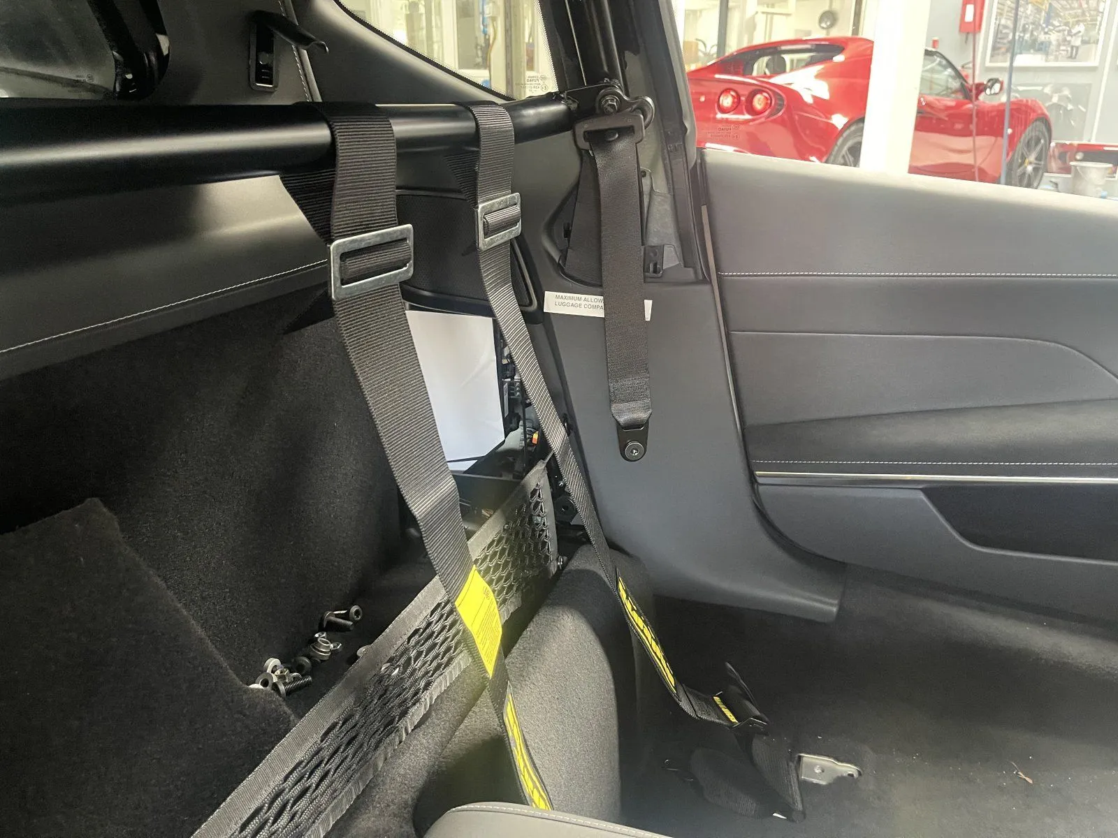

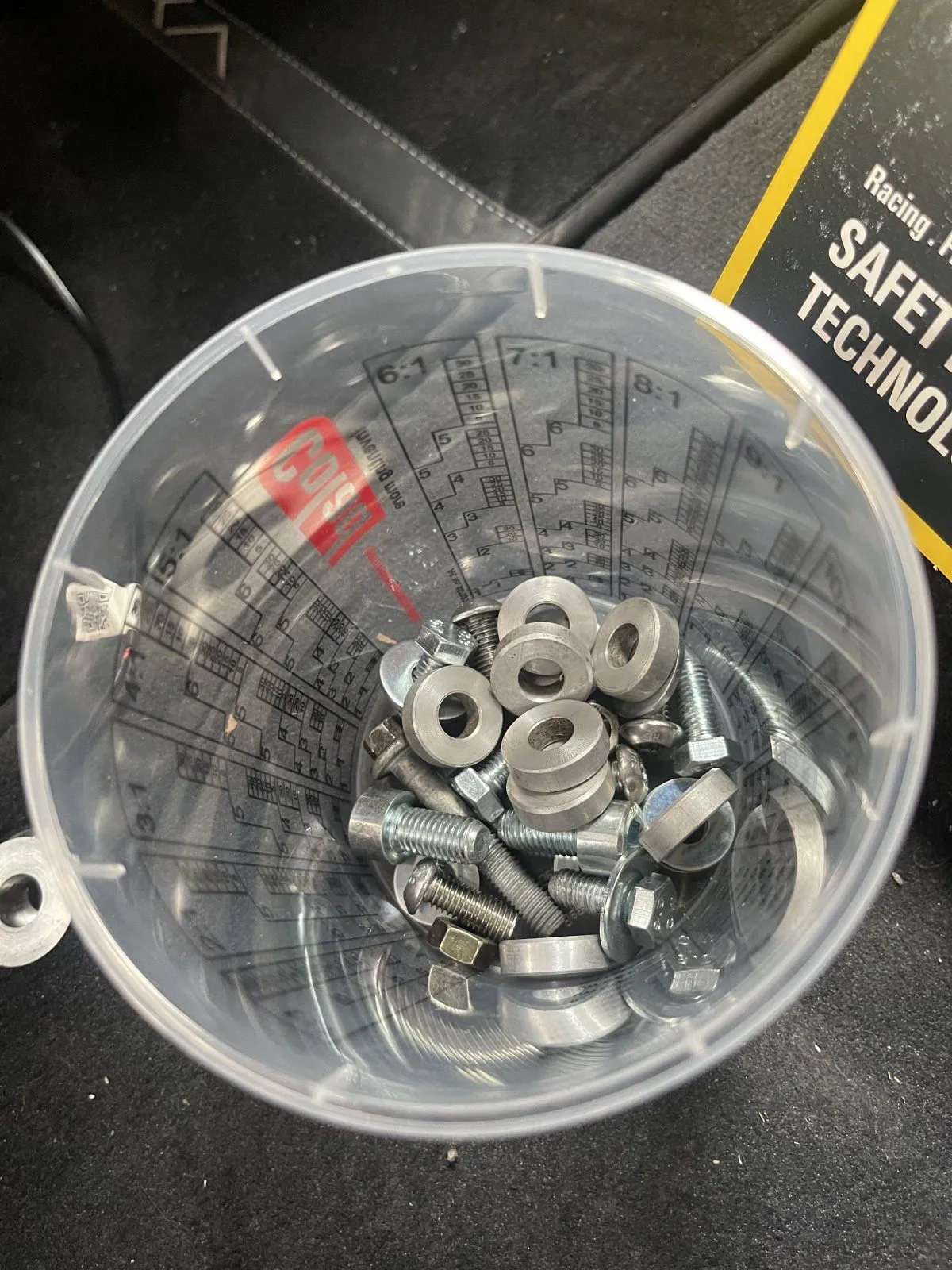

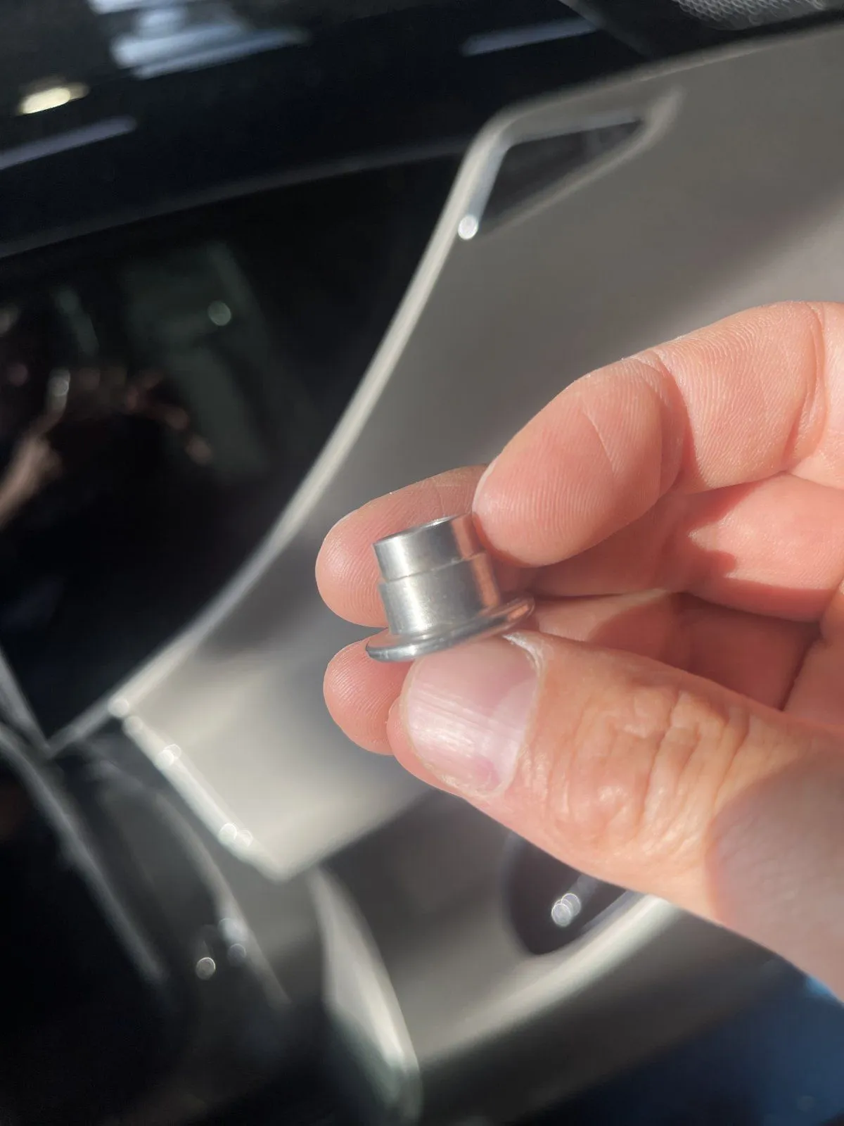

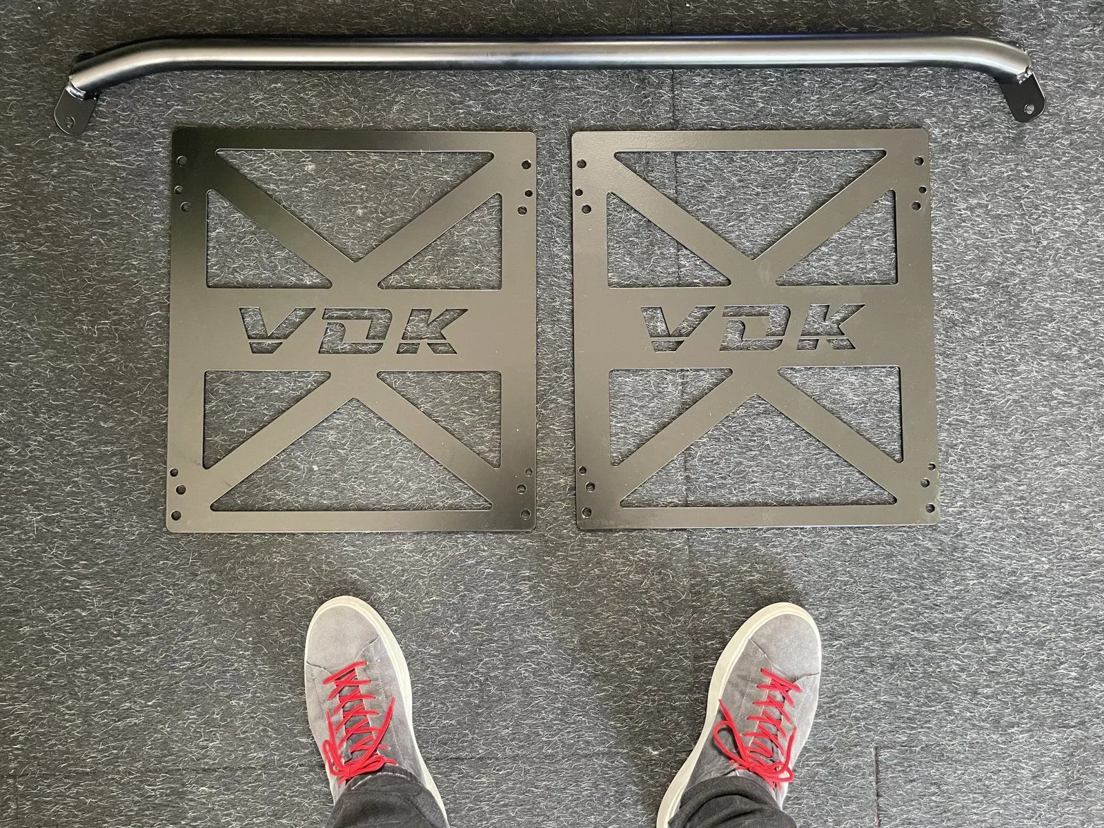

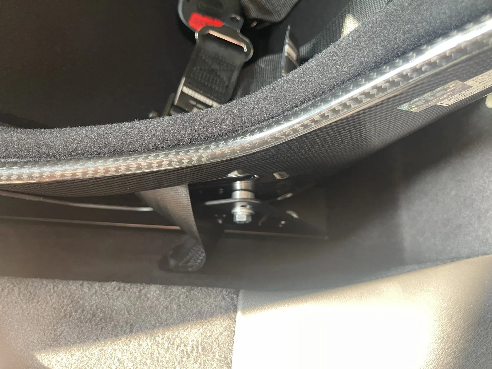

Today the custom made bar went in for the Schroth harnesses. Accordingly we also planned to keep the original belts in case we want to hop in quickly to get groceries around the corner ;-). However this also requires to make new fixing points on the Recaro seat brackets, as the original points are on the original seats. So it needs some further figuring out.

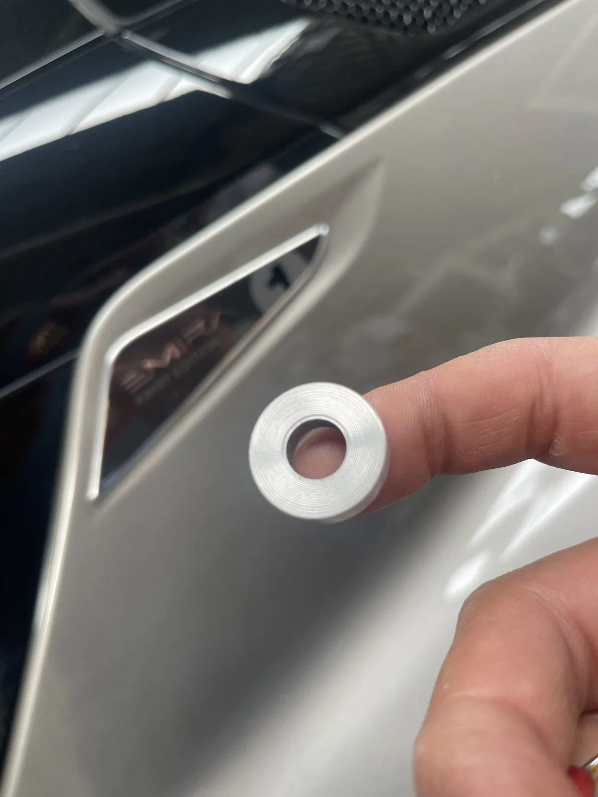

VDK also manufactured aluminium bushings to play around with seat height and angle.

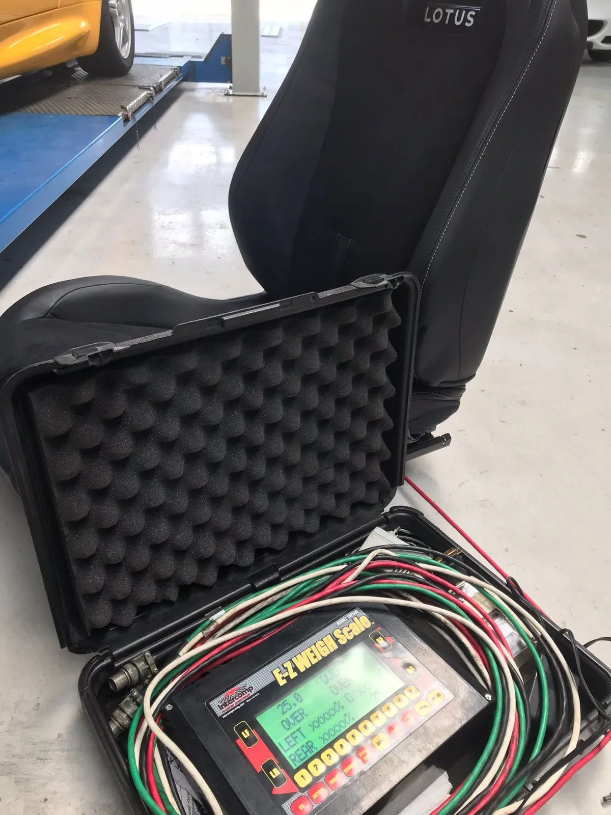

Finally...we weighted the original seats and they come in at 25kg. Less than I expected, as the feel like 40kgs, but hey we are saving 2, so all in all it will be a massive weight saving on seats!
Patience...patience...patience...

Wow. For a 12-way electric seat, that's less than I would have guessed. I was thinking somewhere between 65-75 lbs each, not 55 lbs.
Indeed...when I picked them up I assumed at least 35kgs. Still at 25kgs they ARE very heavy. Don't think the standard seats are great either...to small for tall people (I am 1.90m) and they don't offer a lot of 'experience' in terms of how they hold you.

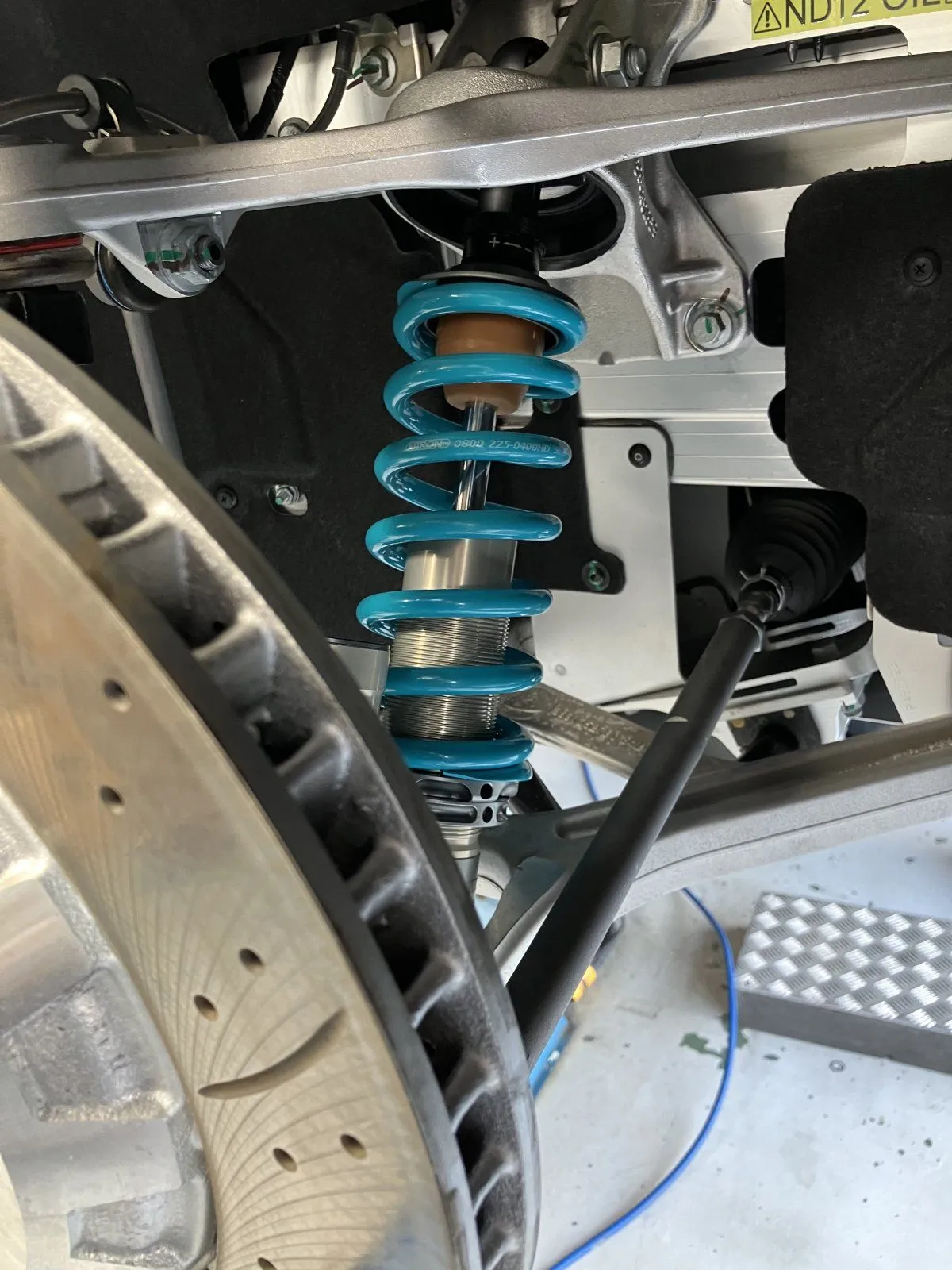

With the wheels off we took some photos of the Nitrons.
Front...actually almost at the lowest position possible:
Rear:

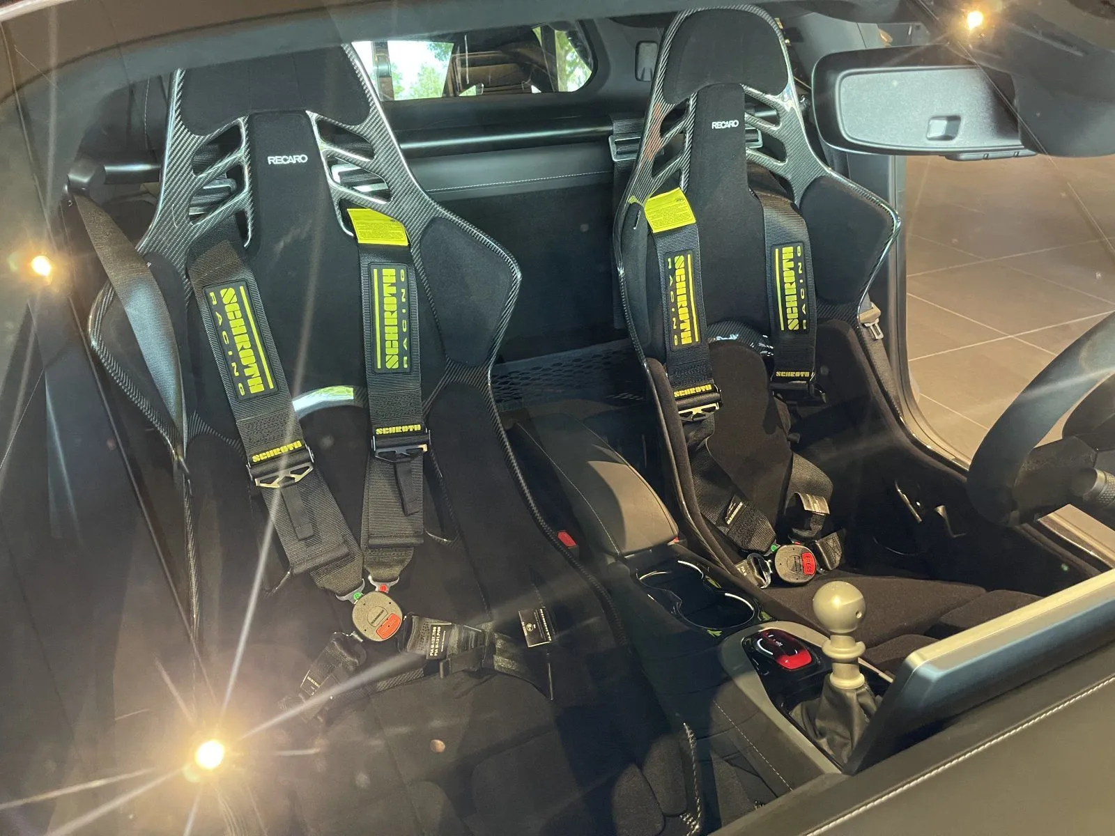

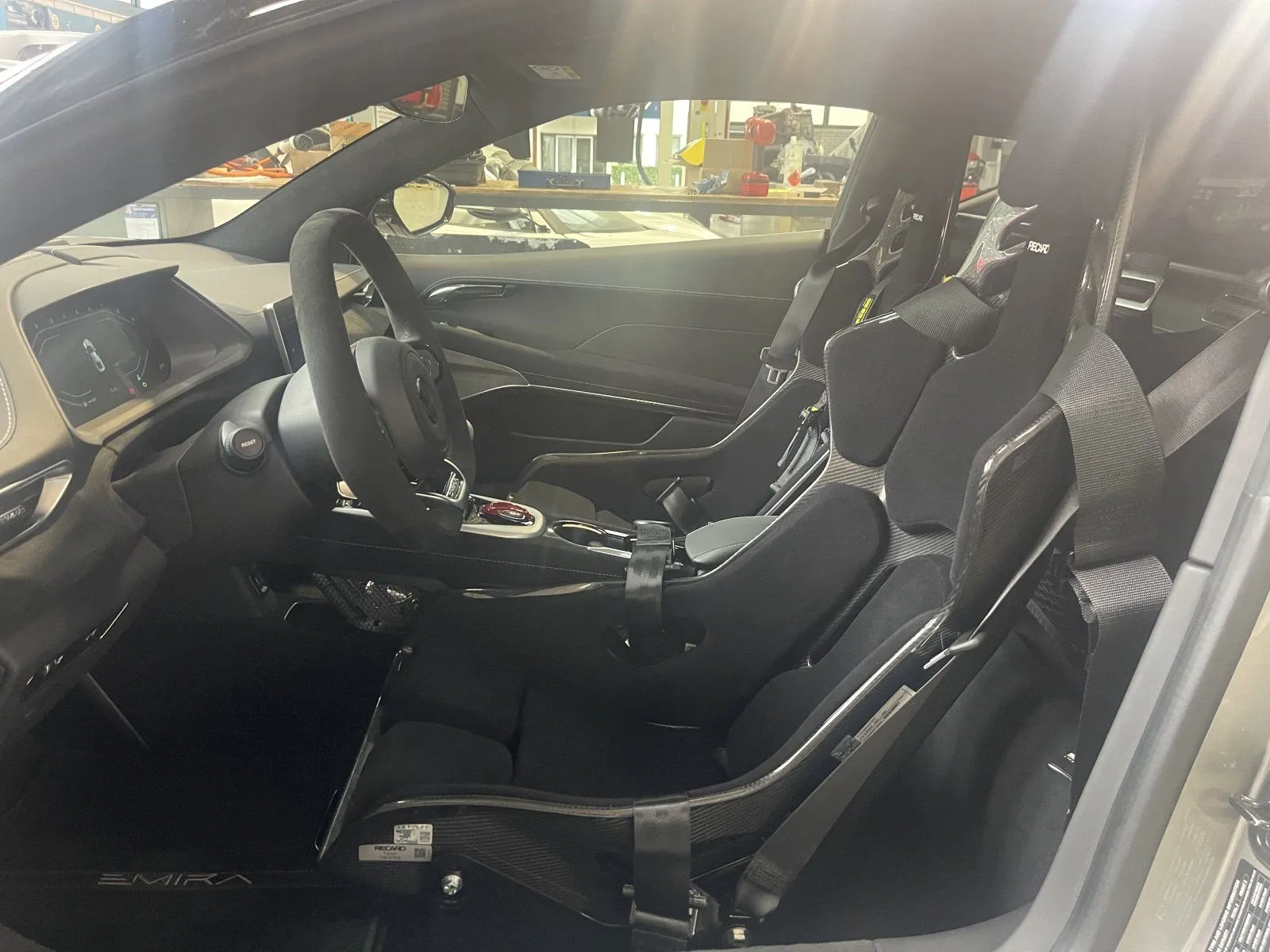

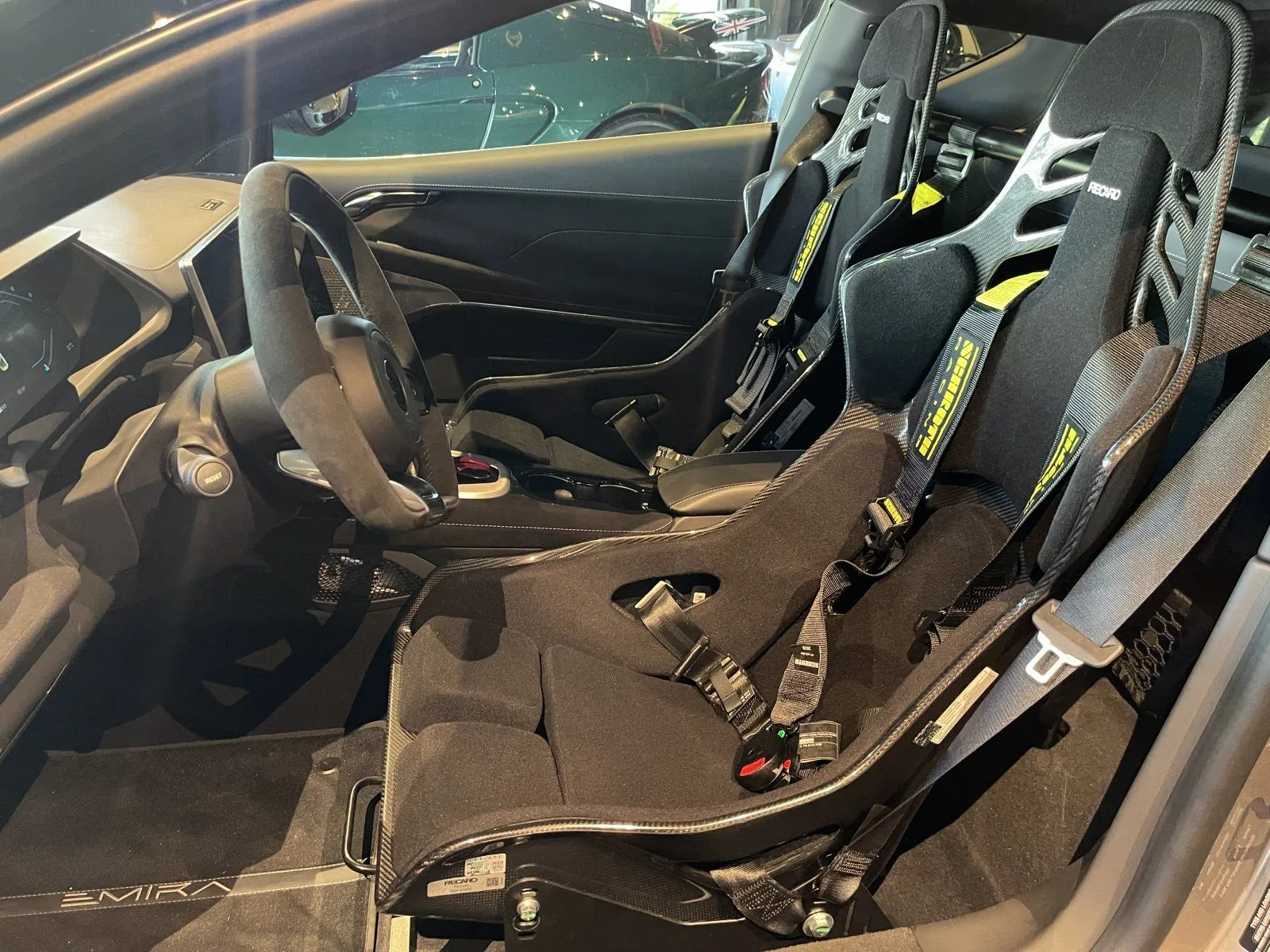

Interior finished, with the seats and harnesses in...looks MEGA! So happy with the outcome. Yesterday we also tinted the side windows in a darker shade. Although I think we could have gone darker.

It's been a lot of work! Lots of custom fabrication.
Van der Kooi Sportscars - VDK - https://vanderkooisportscars.nl can now officially supply:
- CNC watercut seatframes for the Recaro Podium seats
- Harness bar for Emira.
- Bushings for seat fitment and to maintain original belts as well.

View attachment 28257View attachment 28258View attachment 28259View attachment 28260View attachment 28261View attachment 28262View attachment 28263
Looks awesome! Seat position feel good? Much different from the stock seats height wise?
Seats look great! A bit challenging to get in and out for daily but I'm sure they add to the experience. Congratulations!
Looks incredible. Great work!
Any reason you didn't go with 6 point belts seeing as though you had to fab the bottom bracket anyway?
As I intend to use the car mostly, as in 99% on the street…I felt no need for the 6p belts. I have them in some of my other cars and find them less comfortable vs the 4p belts.
Also you may have seen that we use the Schroth belts with the different buckle than what may have expected…for 2 reasons:
1. Schroth was very hard to get hold off, these were actually the only ones we could get our hands on in time.
2. The other type buckle which you need to twitch on the 6p belts are metal and will damage the carbon seats much easier
3. These are the recommended streetlegal belts from Schroth:
https://www.schroth.com/en/racing/street-legal/details/show/profi-ii-fe-asm-2/
I plan to add some shoulder pads for comfort…and if they don’t work can always upgrade to 6p.
Time will tell.
