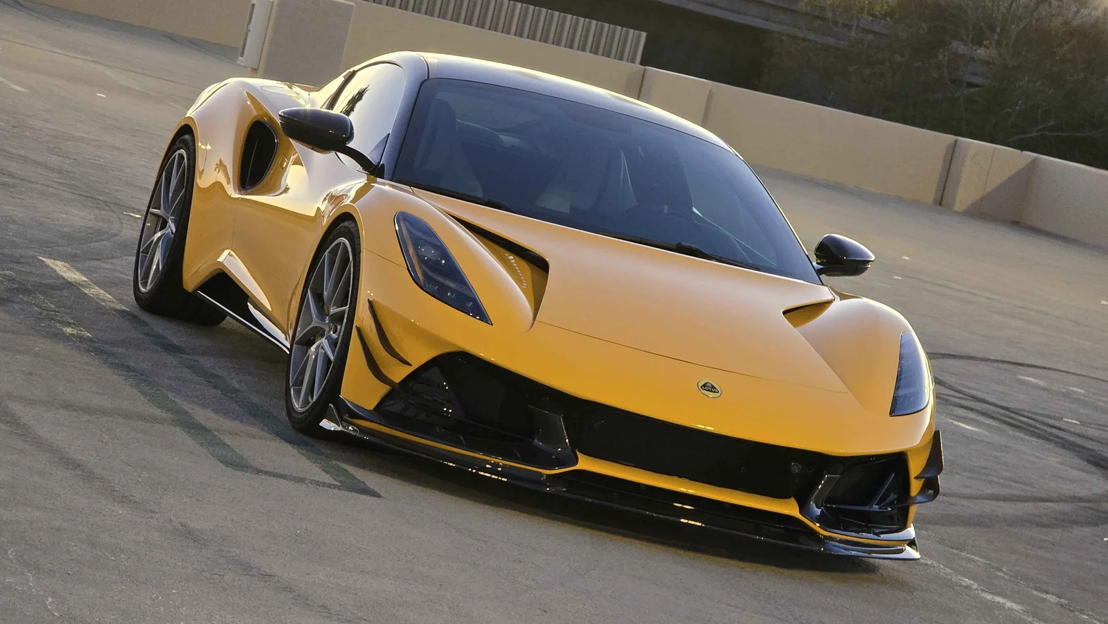

I know this isn't going to be for everyone as this style splitter (and their Aero accessories) has most people divided, but I just finished installing this over the weekend and wanted to share.
The carbon trim and canards are also from MONOTEK.
Please excuse any bubbles you see on the splitter, as I JUST freshly finished installing the PPF on it, still waiting for all the bubbles to dry up and popping any remaining.
I do have some install pics if anyone actually wants them, but I drilled an additional 5 holes on each side of the splitter, and used 4 OEM holes on each side of the bumper with M6 rivnuts and screws, the rest of the hardware is just reusing whatever OEM that was already on the car, and 1 strip of 3M VHB closer to the front to add some adhesion. No drilling required on the car's side at all, overall it's now secured by a total of 16 screws and bolts + VHB tape, it's not going anywhere. The OEM aero trim (infront of the wheel well on the newer vehicles) and the metal puck is retained and still fits just fine without modification.
Now the front sits pretty low, the car is dropped about 1" all around on GRP kit. Not a lot of people have these outside of CN it seems, I've only seen maybe one or two online (that's not from CN), and never seen them in person.
This front splitter looks so much better without a front plate!

Looks pretty good. Now you need side skirts, a rear diffuser and a rear wing:cool:

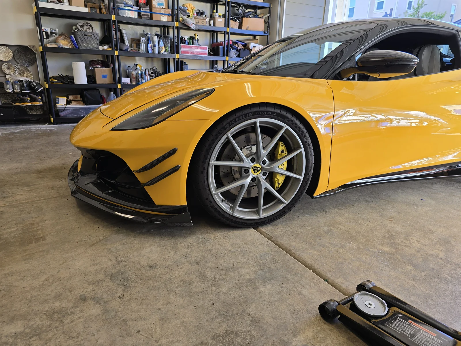

View attachment 73464View attachment 73463
Love the front splitter. I am waiting for mine from a different company. I agree with a few of the other people here. Get the Side Skirts as well. The side of the car has always felt a little unresolved to me, and the side skirts finish the sides of the car beautifully. Combo with the front splitter is stunning in person and just the right amount of aero IMO.

I will get side skirts for sure sometime, one thing at a time haha. Trying to spread out my spendings on the car.
And you are right, with such mod heavy on the front, it definitely needs sides and rear to completely round it out.
Though Im probably not going to go with monotek for the sides and rear.
I went with GRP. The Gloss Black matches the factory gloss back bits. Car looks great though
