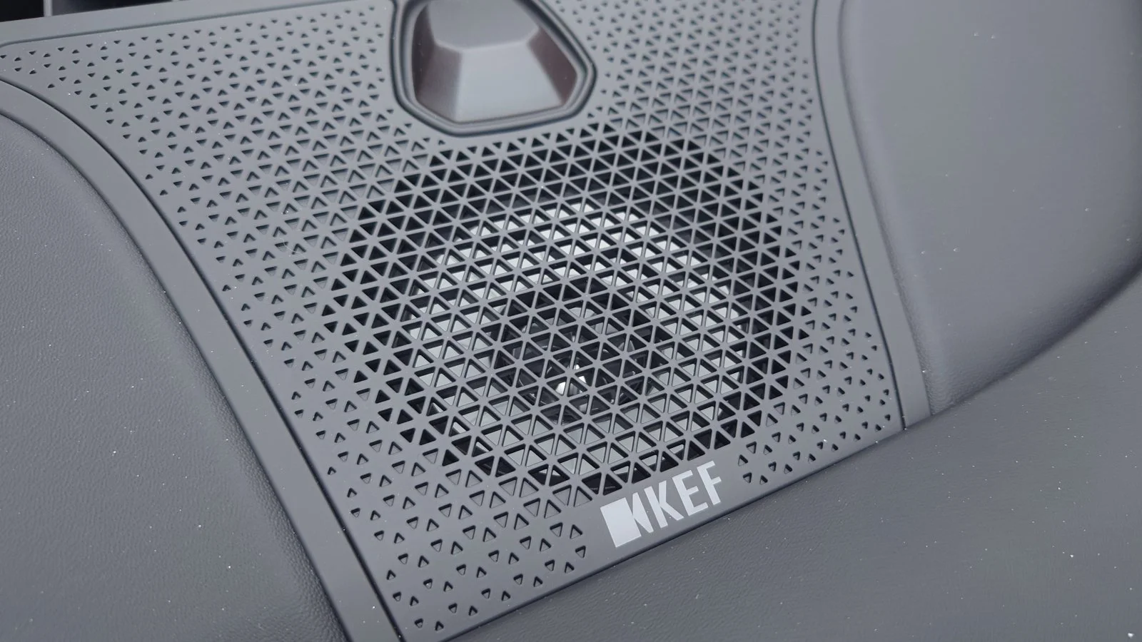

Even though there seems to be 3-inch KEF UNI-Q drivers in each door panel, it is a little doubtful whether the third 3-inch UNI-Q driver at the center of the dashboard, near the windshield, is really mounted (maybe some cars have got it, while others have not)?
There definitely is a centre driver mounted in the dash, in my car at least. With FEs all having the same system I can't see that any wouldn't have it!

Also, like I mentioned in my initial write-up in this thread, the audio in the demo Emira V6 FE really sounded broken (I had the car for three hours total, and I drove it on regular streets as well as highways). I did not raise this issue with the importer/retailer since this is not my particular car; but I made it quite clear to them that the audio quality “sucked”, and that when my own car arrives, I intend to do something about it.
Like I have written in other posts herein; I am actually a (home) audio professional, and I do know sound quality and differences in sound quality both in home audio and car audio. I am not at all looking at anything extreme or excessive. Rather the contrary. I am looking for something that is clear and focused, and at the same time well-balanced.
Unfortunately I will only be able to say more after my own car arrives. It has been built, and I have received the “VIN NUMBER”, but the car has to be shipped half-way around the world and go through various inspections. So my impression is that it is still several months away from reaching me.
PS. Thank you PsymonR for confirming that there is indeed a centre driver. This has in fact been rather unclear depending on who I asked 😉
All the FE cars I've seen have a 3rd UNI-Q driver at the center. I have not seen *ANY* cars that do not have this third driver.
There seems to be no drives mounted in the pillars left and right of the windshield (these locations are for tweeters of the base system on no -FE cars.) However, one question is what would happen if additional 3-inch UNI-Q drivers were to be added in these available spaces on an FE-edition car? (Possibly additional DSP tuning would be required? And also some separate volume adjustment?)
I am not sure what the purpose of those additional drivers would be. The existing drivers in the front doors and center dash do a great job covering the midrange and highs, generating one of the best sound stages in terms of width and placement that I've heard in an automotive environment. It's really remarkable how good it is in this regard and I don't see how additional drivers would help. The sound stage height is dead in front of the listener. There is no hint of it being low. The existing system also gets plenty loud without stress or distortion.
