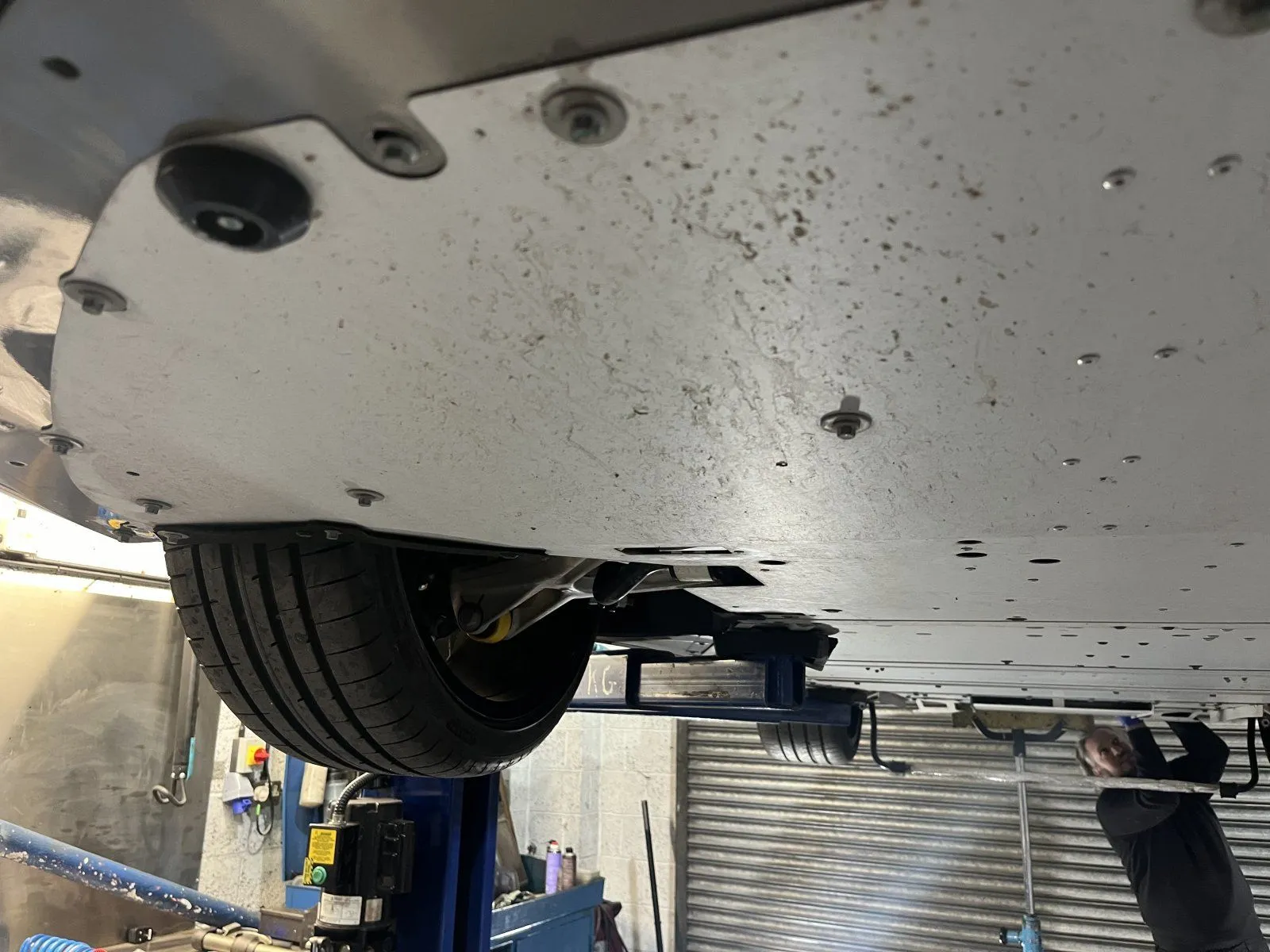

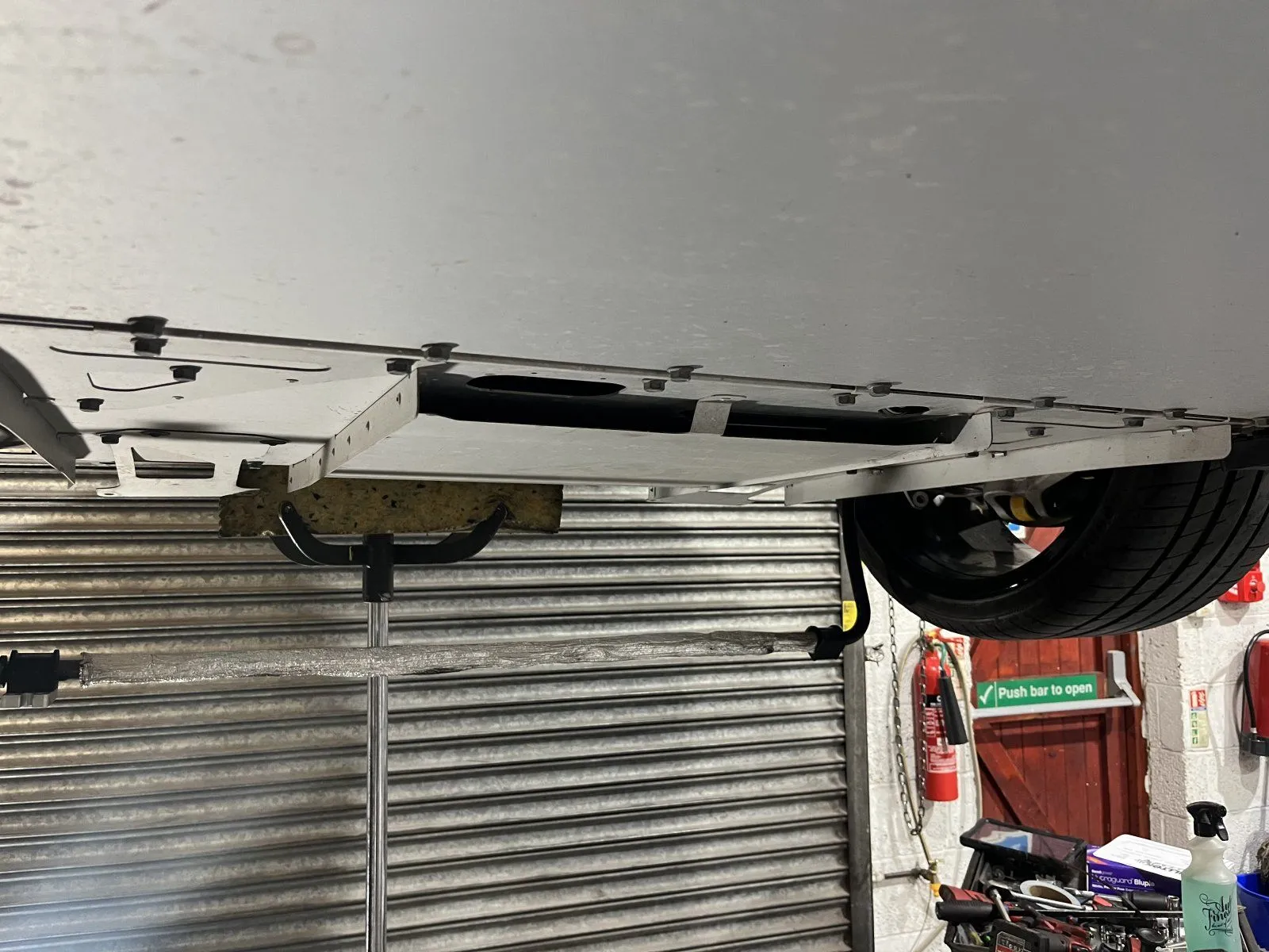

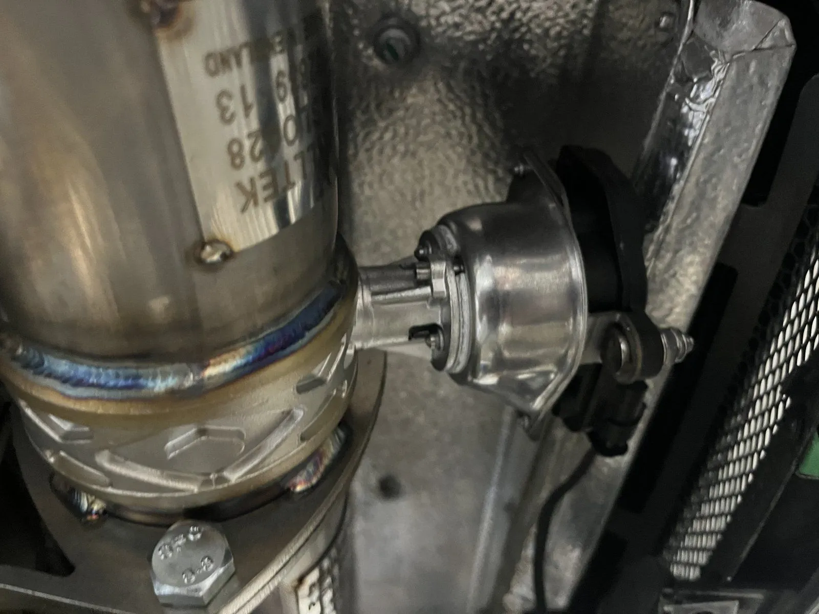

Ok guys today I had the Milltek exhaust fitted, including the GPF bypass pipe and it sounds amazing. When the valves are closed it sounds on par with valves closed oem and when open it’s like a new engine.
Regal Autosports fitted it and did some filming to record oem sounds and next week when it goes back in for Nitron coil overs they will record the new exhaust sounds. Often they sound a bit better after doing some miles after settling down for some reason, buts let’s see.

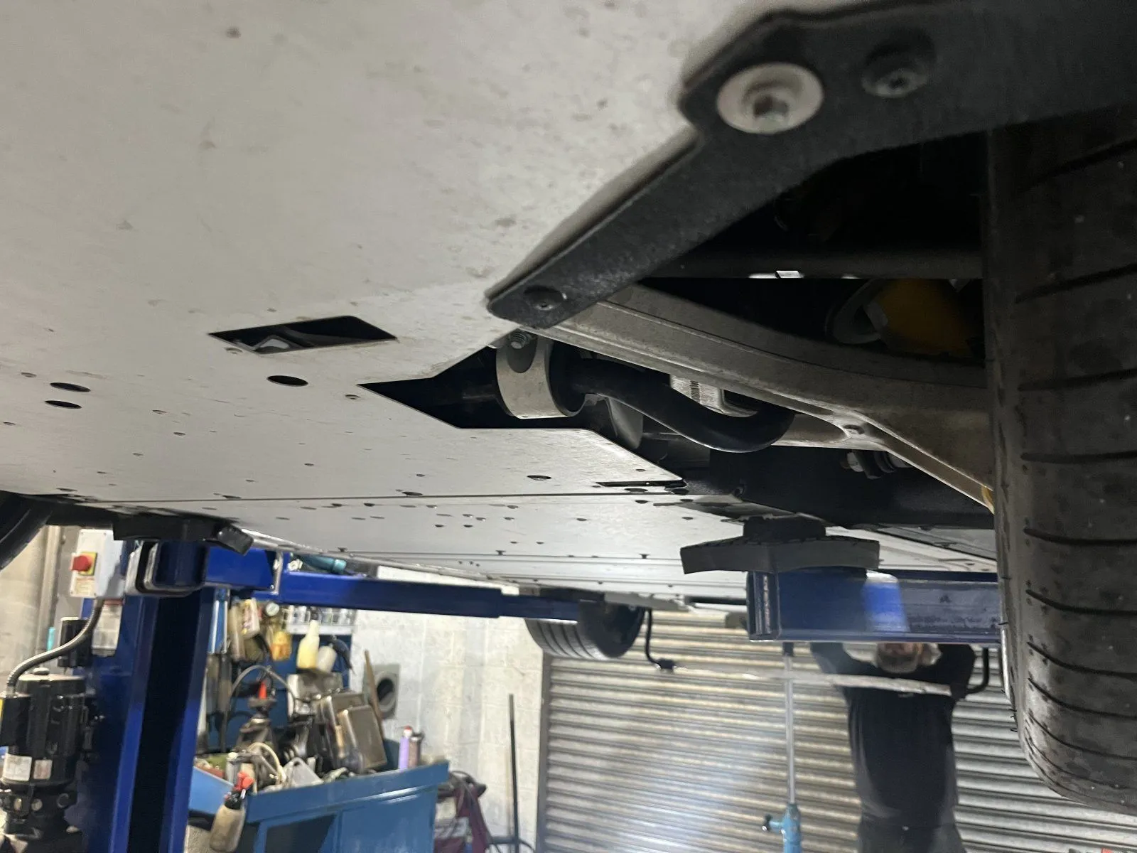

It was impressive to see the Emira when on the lift because the aero and under body aluminium covers are way better than it should be for the purchase price.

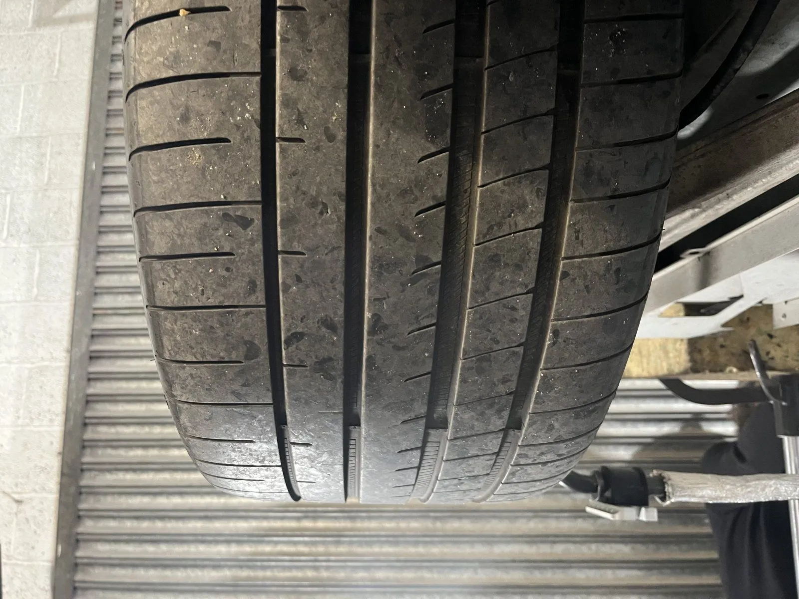

I couldn’t resist a picture of those 295 wide tyres. 😁👍🏻

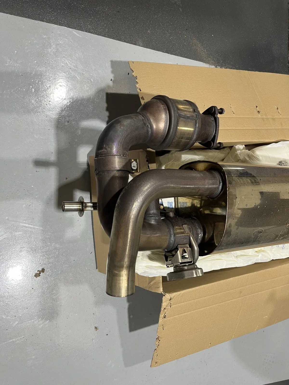

This is what everyone is referring to as the third cat unless I’m mistaken. One thing I definitely not be doing is removing the other main cats, although I’d like to see if there is a diagram of the oem set up and research if 200cell sports cats are an option.
Since when does the Emira have a gas particulate filter? And if it does exist, where is it in the exhaust?
Milltek are to blame for this confusion by calling their pipe an OPF Bypass.
Which is very surprising as you would hope that they, if anybody, should know the difference between a catalytic converter and a OPF/GPF!

The Emira has the “3rd cat” where the 90 degree link pipe is and the silencer has two outlets rather than one.
I am trying to understand where the 2 main cats go because on the picture the cat look like they are part of the manifold and the uprated manifold for the Emira don’t have a cat on them.
After driving mine for the last 2 days I think the Miltek exhaust with the gpf delete is loud enough and may be too loud with performance cats as well as getting th Y pipe and manifolds in the future.
