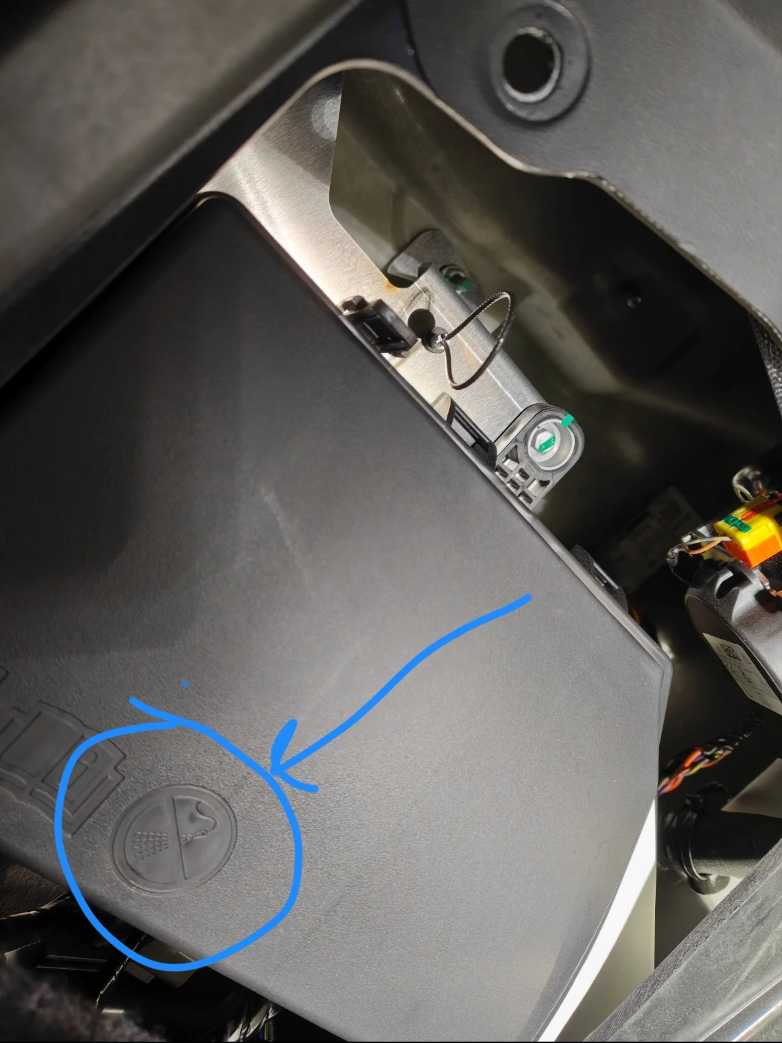

Save this picture in your phone just in case. (Or just burn it in your mind)
This is in the Owners Manual but here is a real world picture.

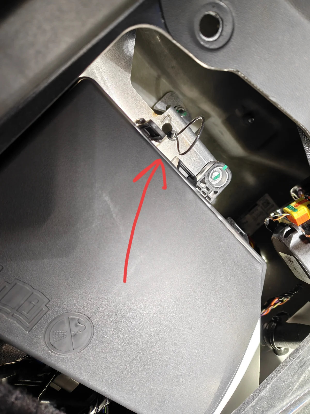

1. Remove PITA panel behind LH seat (driver's side seat for US spec)
2. Look for wire loop and pull to release trunk lid. You don't have to yank or pull very hard.
3. You may or may not need a second person to lift the trunk lid while pulling wire loop.
Btw, good reminder to NOT power wash inside the cabin much less the fuse box inside the cabin. LOL
