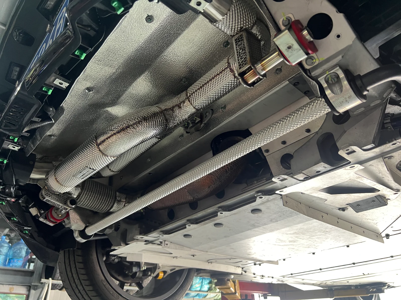

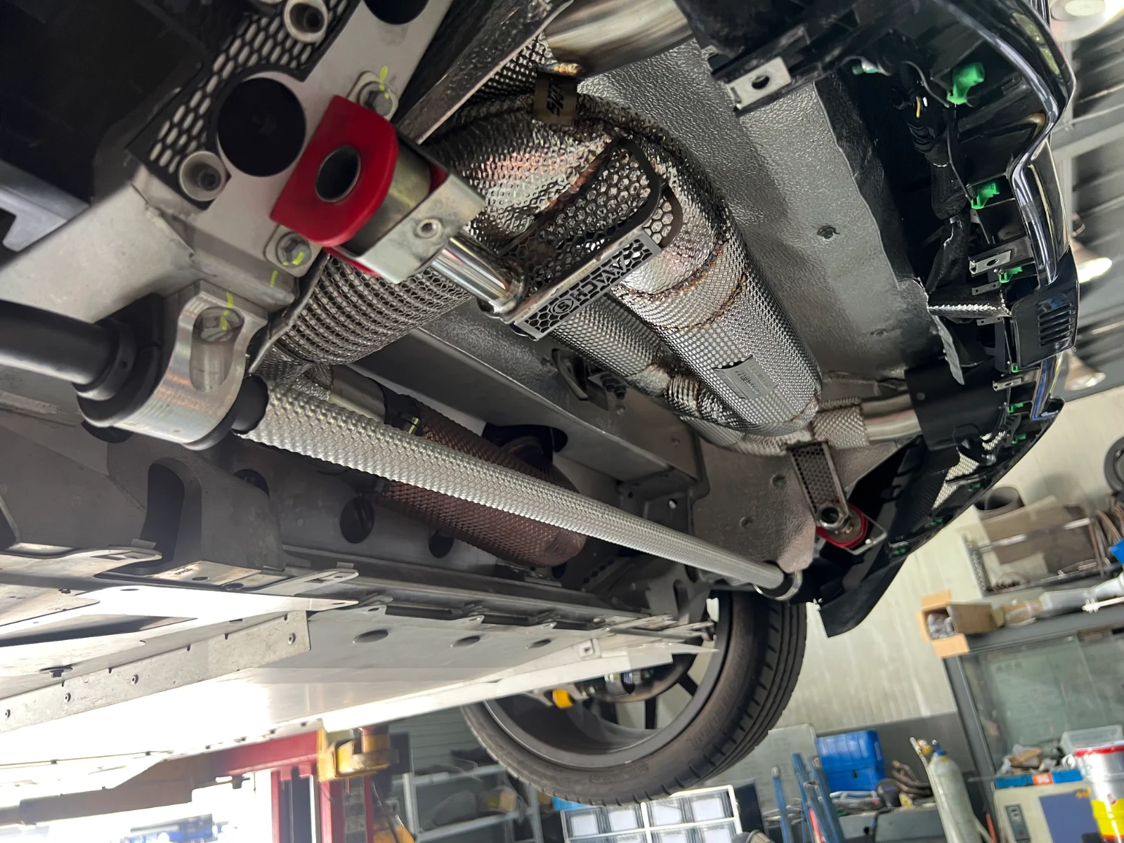

I think Most of the issues I had were down to the low grade cable they used (2 core cable feeding the aftermarket valves was melted and shorted together near the valve). If they had used a proper high temperature cable with additional insulation, I’m sure it would’ve been fine. I’ve now gone with their straight through exhaust and it’s been problem free so far. I think it sounds a bit better than their valved exhaust and it’s lighter. No option to make it quieter with a remote though :)
Most of the issues I had were down to the low grade cable they used. If they had used a proper high temperature cable with additional insulation, I’m sure it would’ve been fine. I’ve now gone with their strait through exhaust and it’s been problem free so far. I think it sounds a bit better than their valved exhaust and it’s lighter.
View attachment 82454View attachment 82455
