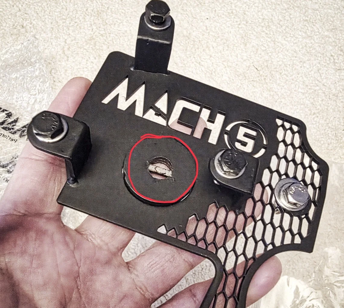

Again very good information thank you! The Mach5 relocation bracket has a notch where the stock valve controller fits into. On my bracket the notch would not line up with the stock controller no matter what, even turning the car on and trying different orientation and valve positions. So it would physically mount into the bracket. We decided to just tap out the little notch on the bracket so that the stock valve motor can just spin freely, and left the Milltek on so that the car would sense everything is fine. Which...I guess many parts of that plan didn't work lol. Does the stock valve controller motor "sense" resistance and need end points like how the bracket is designed? or could you in theory just mount the valve controller anywhere and have it spin freely? We'll take off the Milltek and plug in directly but will need a new M5 bracket the one they sent didn't fit the stock controller -
Hmm that little spinner thing on their bracket should somewhat freely spin. You should be able to orient that bar in the orientation for your valve controller. Also if you unplug the valve while it was during cold start, I think it’s not in the factory idle position. I had that issue one time and when I plugged the valve motor back in not connected to the bracket or exhaust, it reoriented itself once it got power.
That doesn’t sound right on your relocation bracket. The factory valve motor is really critical regards the open and closed position. Whatever it’s mounted to, must have end stops that closely match the original calibration, or else the valve needs to be recalibrated on Lotus diagnostics. I don’t think it needs any mechanical resistance, it’s all about maintaining the end stop angles, from my understanding. I believe the Miltek can bypass that to some extent, but I’ve no experience with the Miltek.
Personally, the M5 bracket seemed to work just fine for me. My problems were pretty much cable/fuse related. So long as the factory valve was connected and powered, I wasn’t getting any errors. Any errors I got, due to blown fuses or whatever, would clear once I fixed the issue and cleared the codes with a basic OBD tool.
I guess there is something wrong with your bracket, or maybe it was assembled wrong. It definitely should have circa 90 degrees range of motion between the end stops, if it’s not like that, it’s gonna generate errors. If the valve motor was run without any end stops, it might mess up the calibration and you might need to get it recalibrated.

Thats what @Kaz and I were discussing, that the valve controller probably test calibrates the valve on start up and if there is no resistance, it think the valve is nonfunctional/broken and throws the codes.
My Mach5 valve relocation kit “notch bar” was in this orientation and my valve controller just fitted right on without issues and i havent blown fuse 13 or thrown any codes for valve actuator malfunction.
I very much doubt any sort of valve misalignment could cause the fuse to blow. The motor is designed to bang into stops, it’s not gonna blow anything from rotating and hitting into stops, even if those stops aren’t where they should be.
