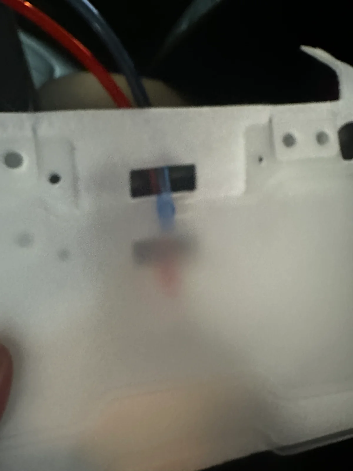

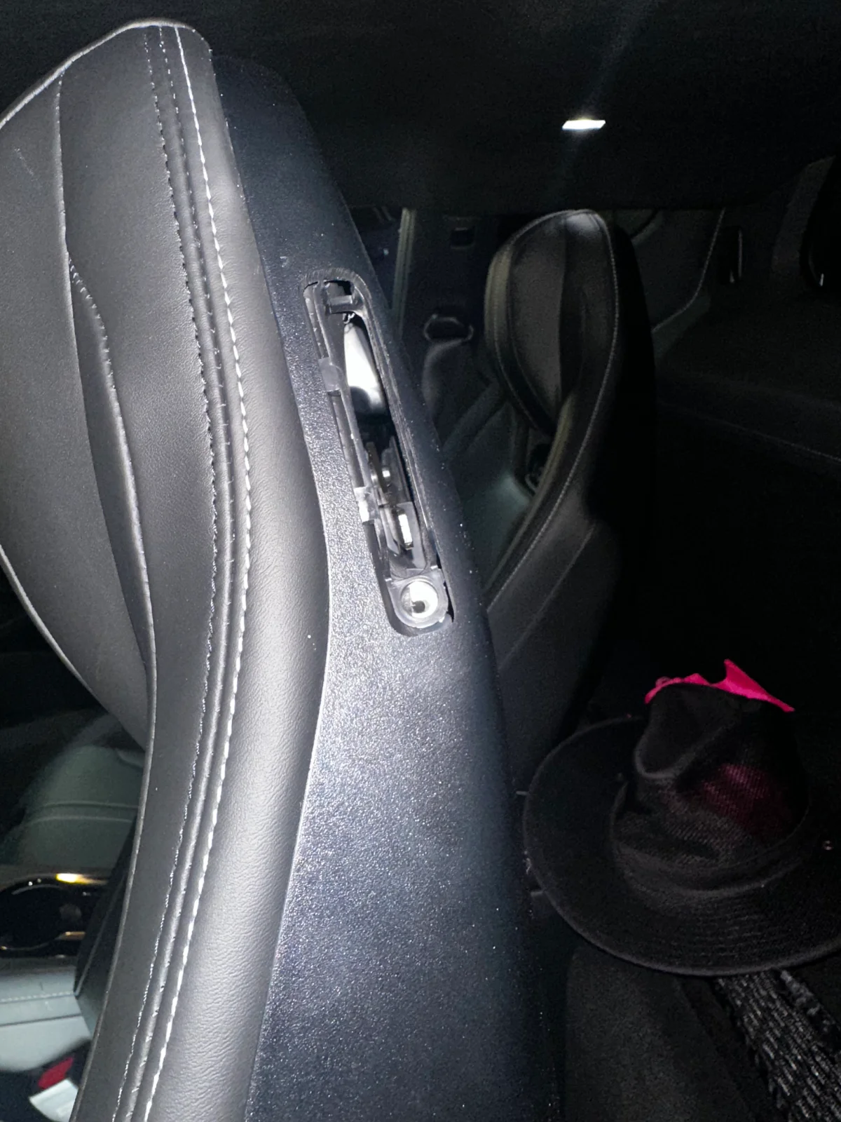

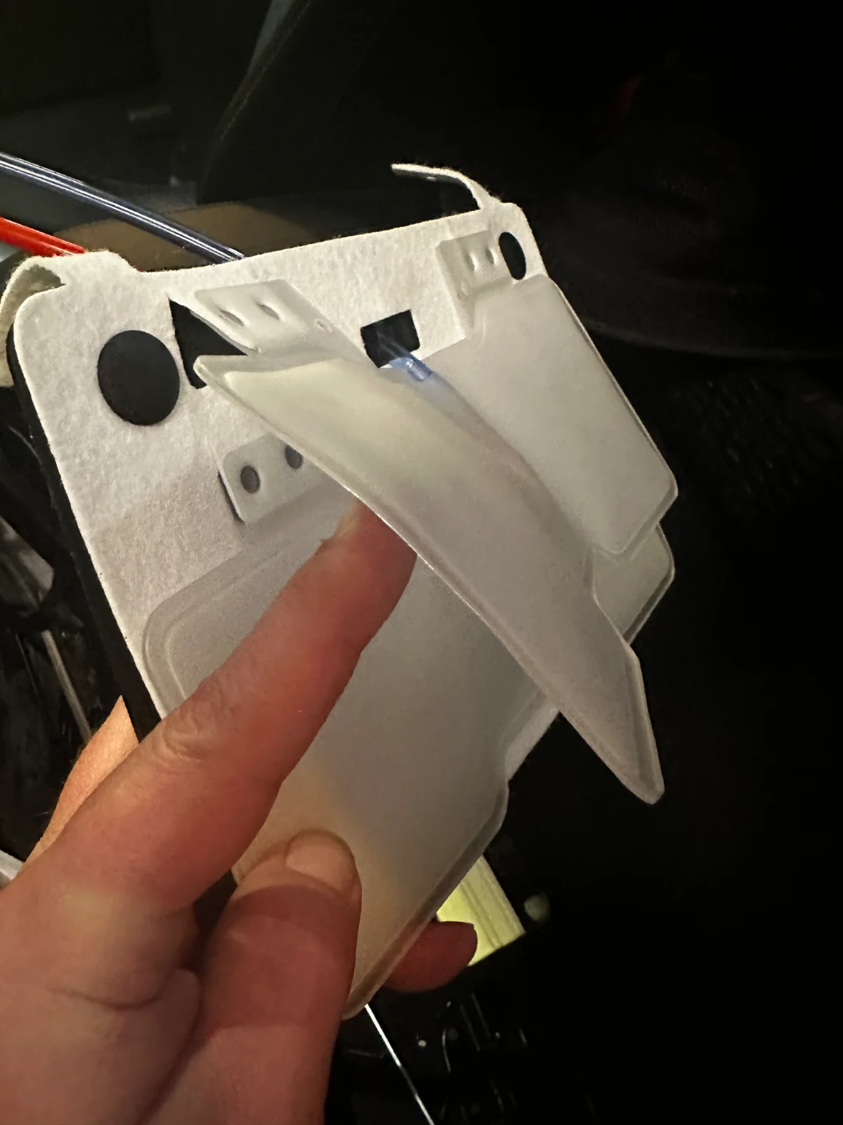

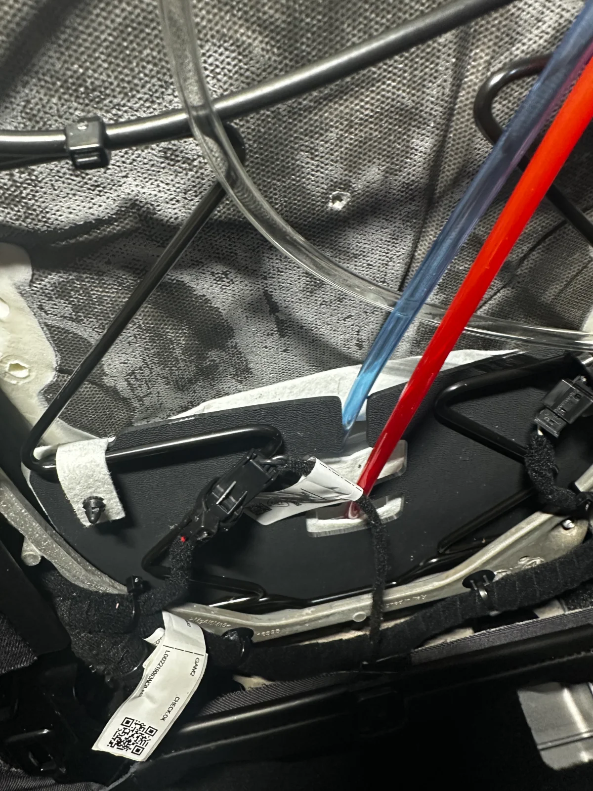

I just fixed this for my seat. It’s obviously incorrectly installed. When you open the seat back up you will see or deduce there are two air bladders stacked on each other, a white felt layer and then a black plastic hardback.
The two bladders are actually folded over like taking a piece of paper and folding it in half. To install correctly I shimmied my hand inbetween the bladder and seat back and gently rolled the upper air bladder upwards - effectively unfolding it. Now the “paper” sits flat instead of folded and there is lumbar adjustment for top and bottom. To me this is obviously correct. You can see the two air bladders connected by a kind of joint. When you lay it flat this joint assures the correct height in the seat back for both air bladders.
Now I was hoping for an incredible change but I didn’t feel it. The default lower lumbar without any inflation is still too pronounced. Now I can inflate a lower and upper lumbar but i actually don’t want either. I just want a flatter seatback and to sit deeper into the seat which is impacted by the factory foam. It’s still fine as the factory foam has crushed down and is now more comfortable than brand new. This new air bladder adjustment does allow me to inflate and create a flat seatback but now I’m pushed farther out of the seat and really feel like I’m on top of the seat and not in it. I still prefer zero air bladder fill upper and lower.
I still think it’s a worthy endeavor in case your experience and adjustment preferences are different.

I just did this also. I flipped the bladder closest to the front of the seat up. Interestingly (or not) the button that should control the lower bladder controls the upper and vice versa. That bladder was in the uppermost position prior while they were folded together so it has always been reversed. Now I'm thinking that maybe the bladder assembly could be installed upside down? I think it could fit the other way but I'm not sure what difference this would make unless the lower bladder (hard to see) is perhaps a different shape. This is an enigma.

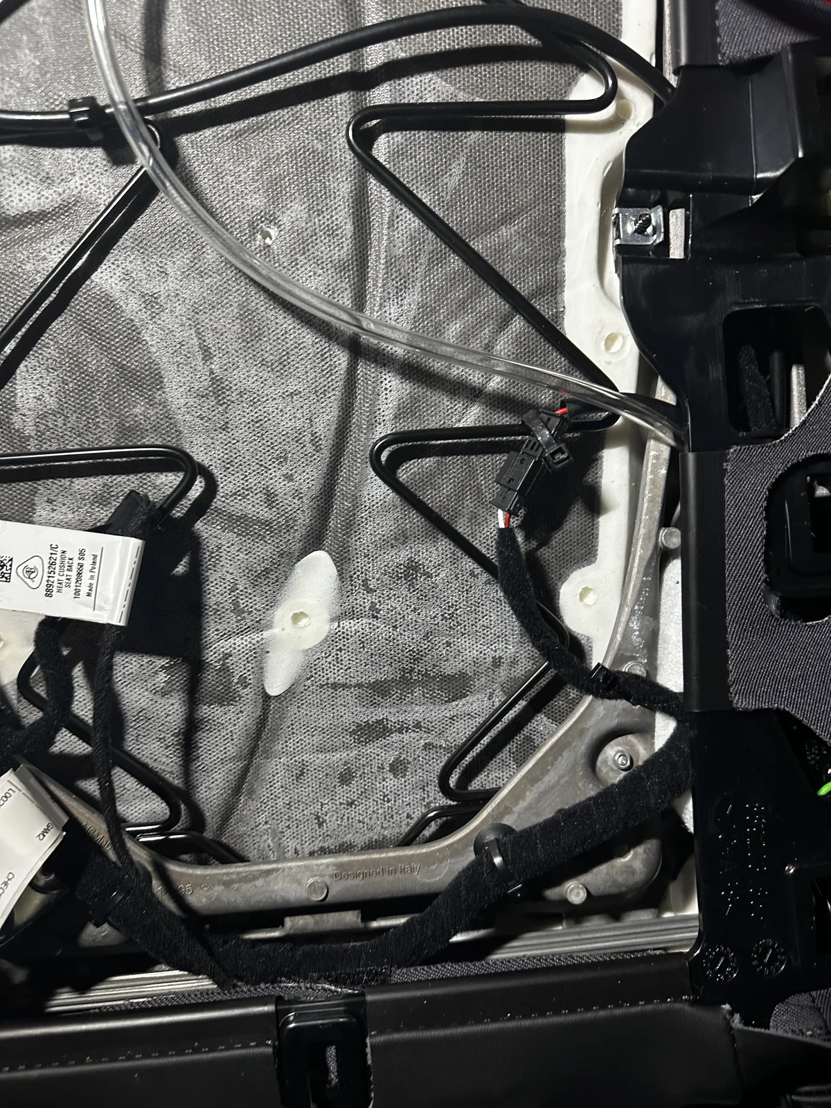

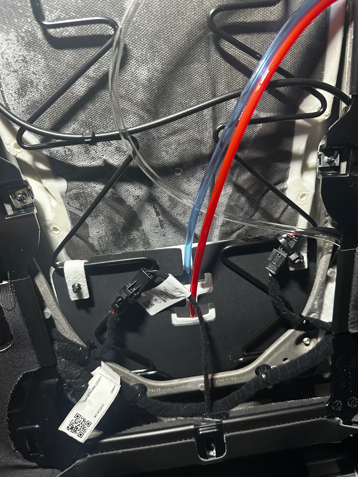

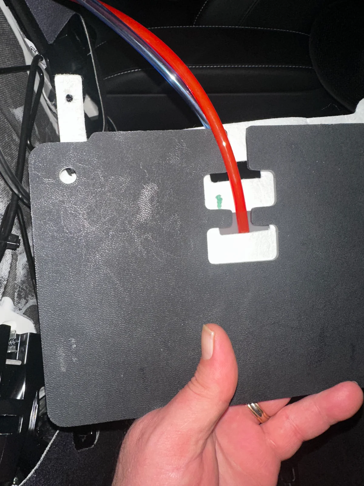

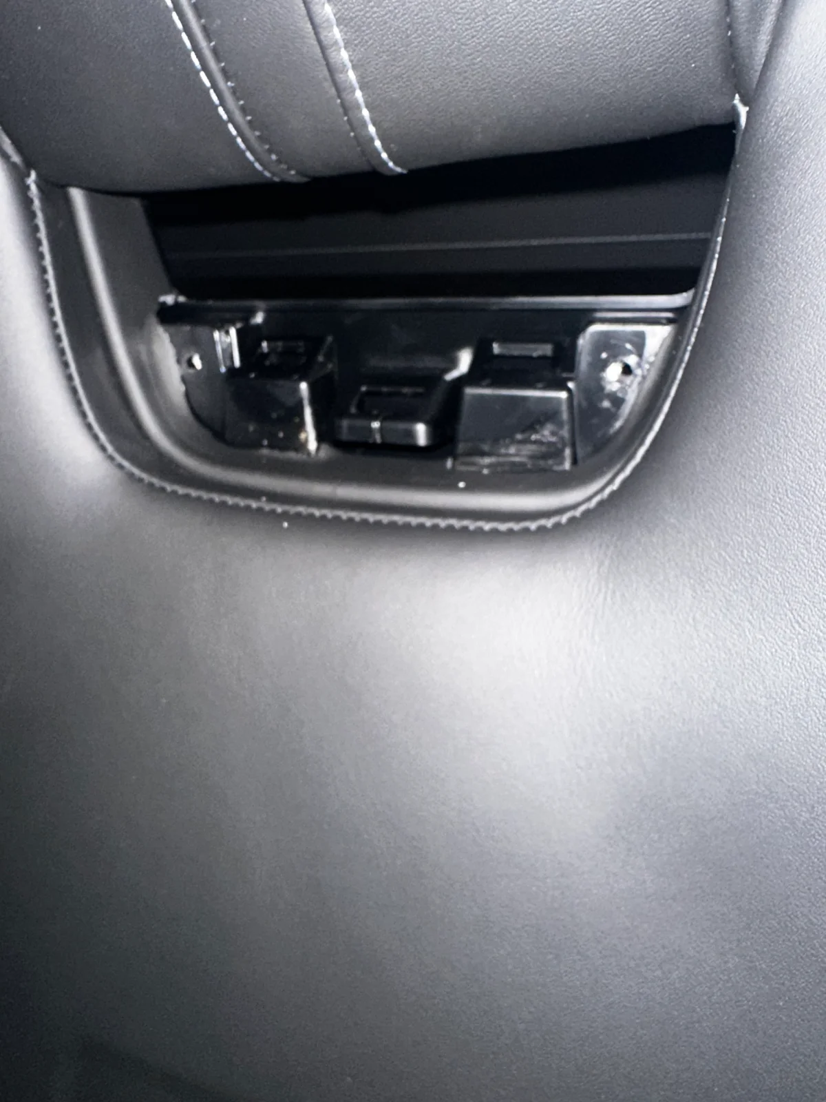

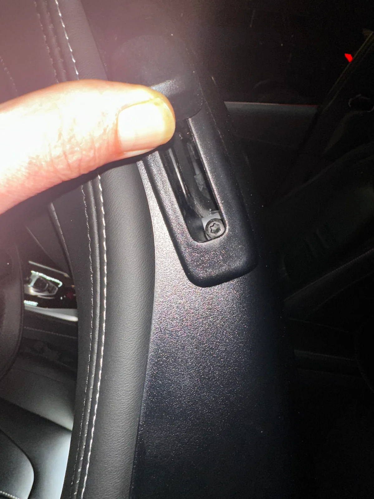

Hey guys, new to the form and just got my Emira on Monday and already had a terrible problem with lower lumbar pain. even driving 20 miles home from dealer. I don’t have back problems besides old guy back pain when working too much, so this is concerning. I followed the instructions listed above and took lots of pictures that I’m going to post so that somebody else taking this on can understand. Some clarifications from previous comments, this looks like an aftermarket add-on that was probably done in factory. Each of the bladders are attached to the felt and the plastic intentionally . Also, if you hit the up button on the lumbar support, it does inflate the lower bladder with the red tube. However, these bladders are only about an inch apart from each other thus no difference when sitting in car. I removed the entire bladder and plastic backing, which wasn’t that hard. Right now they’re just hanging behind my seat and I’m gonna drive it for a week to see but from my short test drive, it felt great.! The bladder is only about 3/8 of an inch with both the plastic and the felt deflated but I think the problem is that the plastic backing is wide beyond the springs in the back of the seat which end up transferring load and also making the springs nonfunctional in the lumbar region. I have owned multiple sports cars in my 54 years, including Porsche, Jaguar, BMW, and previous lotus evora. In all those cars I have never used lumber support. Maybe it’s just me. Some Small additional advice, once you remove the T 25 torque screws, the seat release handle pulls out with a little force in the backing comes off from the bottom up. Use plastic to remove the lotus cover on the seat from the top back, rotating it forward to access the two screws not in the Seat release area. I really appreciate the forum!

Hey guys, new to the form and just got my Emira on Monday and already had a terrible problem with lower lumbar pain. even driving 20 miles home from dealer. I don’t have back problems besides old guy back pain when working too much, so this is concerning. I followed the instructions listed above and took lots of pictures that I’m going to post so that somebody else taking this on can understand. Some clarifications from previous comments, this looks like an aftermarket add-on that was probably done in factory. Each of the bladders are attached to the felt and the plastic intentionally . Also, if you hit the up button on the lumbar support, it does inflate the lower bladder with the red tube. However, these bladders are only about an inch apart from each other thus no difference when sitting in car. I removed the entire bladder and plastic backing, which wasn’t that hard. Right now they’re just hanging behind my seat and I’m gonna drive it for a week to see but from my short test drive, it felt great.! The bladder is only about 3/8 of an inch with both the plastic and the felt deflated but I think the problem is that the plastic backing is wide beyond the springs in the back of the seat which end up transferring load and also making the springs nonfunctional in the lumbar region. I have owned multiple sports cars in my 54 years, including Porsche, Jaguar, BMW, and previous lotus evora. In all those cars I have never used lumber support. Maybe it’s just me. Some Small additional advice, once you remove the T 25 torque screws, the seat release handle pulls out with a little force in the backing comes off from the bottom up. Use plastic to remove the lotus cover on the seat from the top back, rotating it forward to access the two screws not in the Seat release area. I really appreciate the forum!View attachment 71891
Did you remove the bladders all together? What's the verdict now that's it been a little while? Better? I too have a massive issue with the lower back pain after driving for an hr or more. I just deal with it unfortunately.
Thanks for posting this.. I might do the same thing when I hear what your thoughts are. Not sure I can do this myself, but might have a shop do it for me.
Ryan G
I removed both the bladders completely. I now have 600 miles on my car, including 2 three hour drives and have had minimal pain. I just cut the two hoses and left them in place. They can be reconnected with a vacuum connector.
