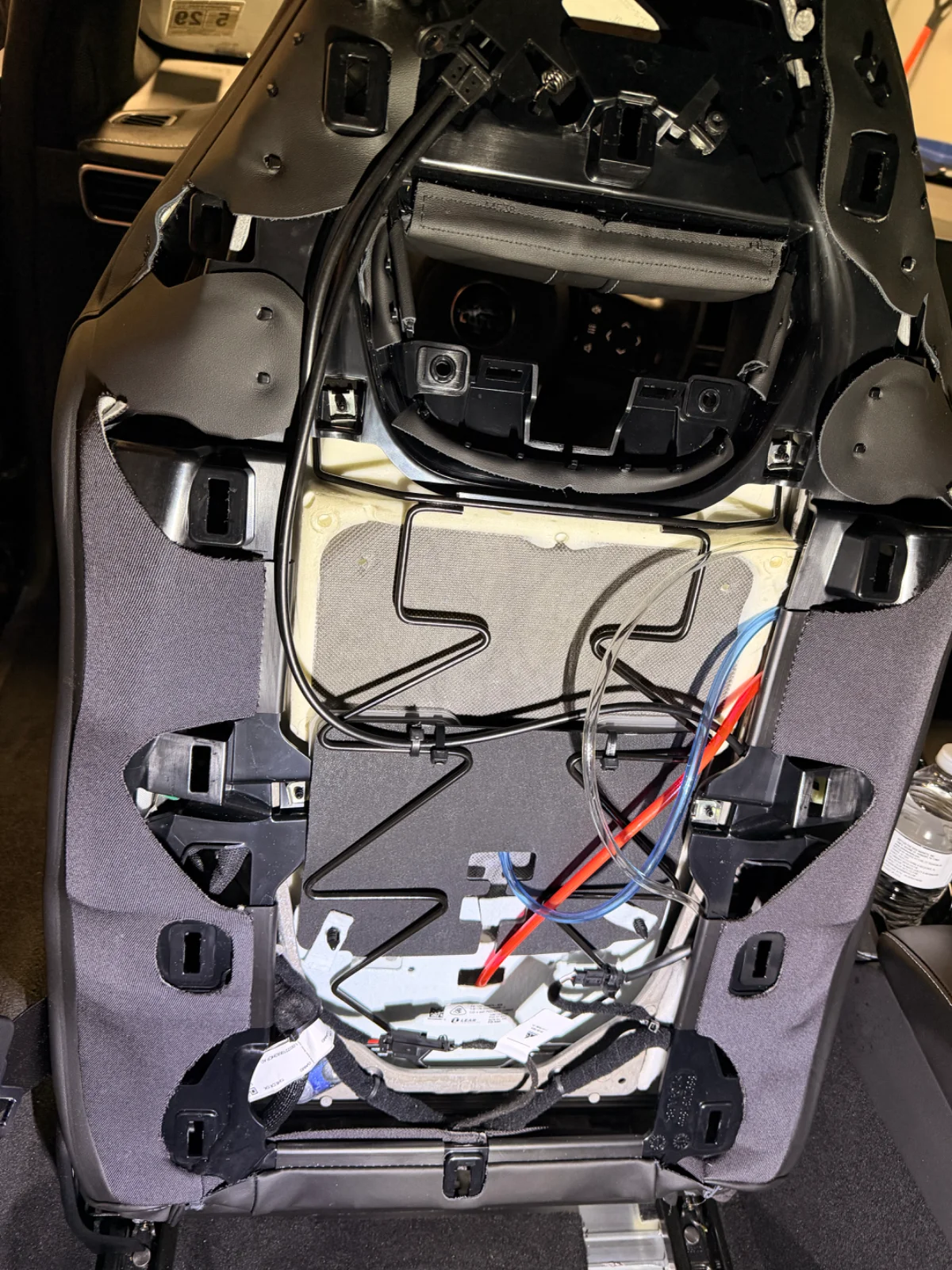

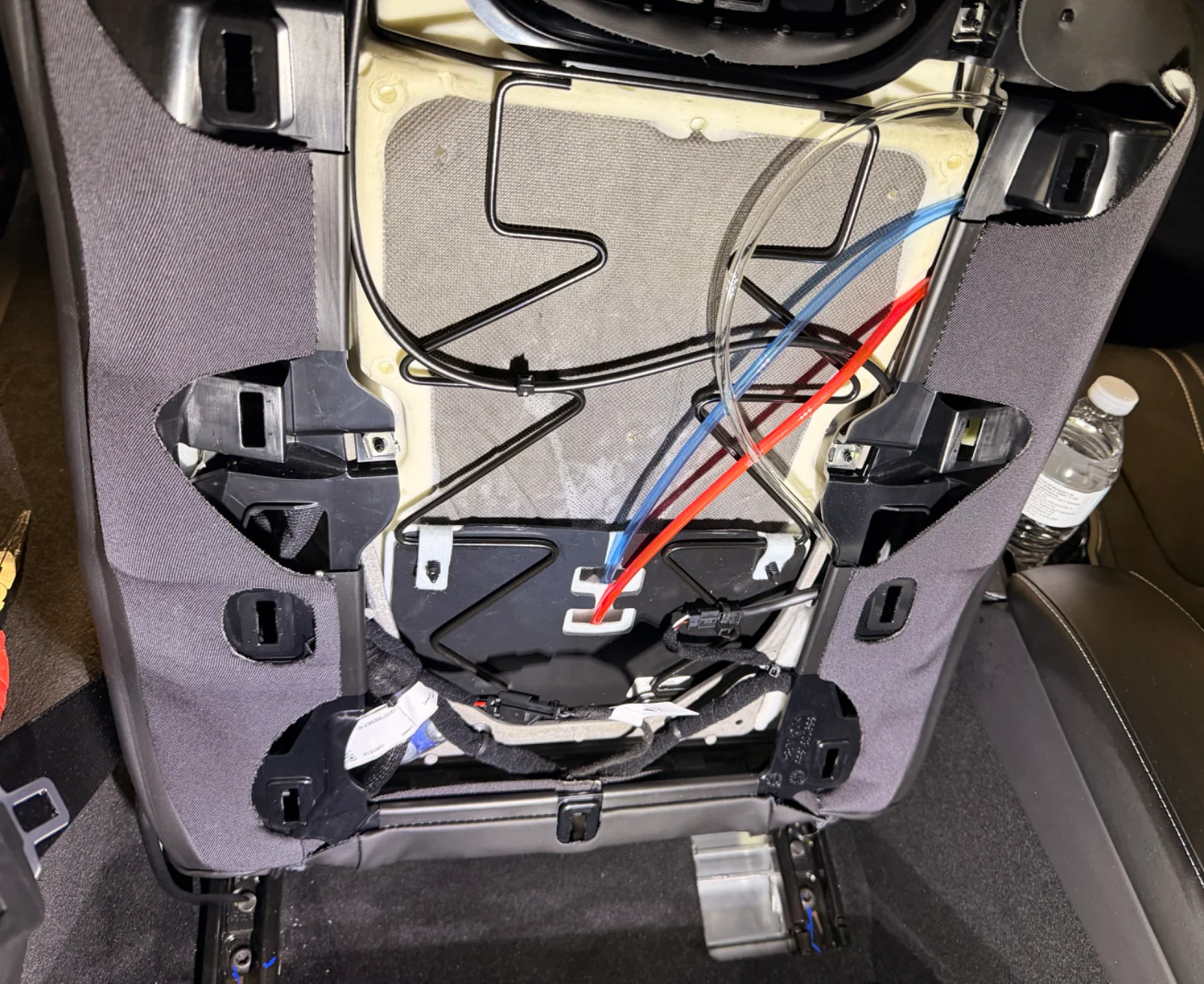

Just like others have stated.. they are from the factory on top each other. Very easy to open up the back of the seat.. flip the one bladder up and now you have a lower and upper lumbar. It’s night and day difference. Here is my before and after pics. Hope it helps a bit.

Doesnt look that simple if I compare the 2 pictures… dont you have another plastic piece installed/added?

I did this fix but kept the black plastic in the original location. Didn’t really help much.
It looks like you moved the black plastic to the mid-back. Does that feel a lot different? It might.
Also did you have to snip the white looped part to free the black plastic?

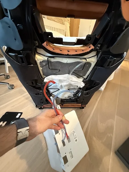

I did the mod today. Like Thaddeus I took the bladder out completely.
Actually it feels ok. Your lower back will go further into the seat and you'll sit a little lower because of that.
I'll leave it that way and drive for a while to see how it feels before I'll put the plastic cover back on. I'm also pretty sure you don't have to cut the 2 air hoses. The bladder will fit nicely under the plastic cover on the opposite side of the metal spring back.

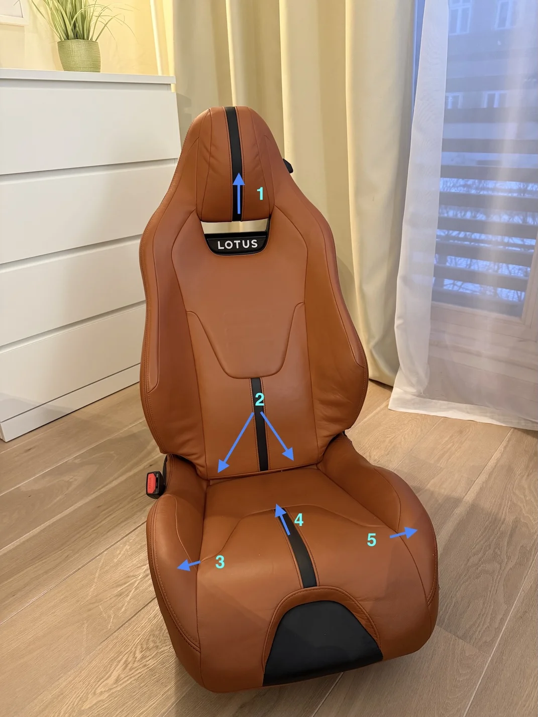

What a better way to spend New Year's Eve than to perfect the Emira's driver seat? Happy with the result :cool: The cushions underneath were modified and the leather was extended (see marked areas). Lumbar support tech was modified as instructed above. Now upper back, lower back, head and hips get the right ergonomic support.

not exactly sure what you did but less cushion in 4 and 2 with additional side bolstering and keeping the stock look would be lovely

Sure I can give some details. Measurements were taken beforehand and the cushion comes in layers. Original look was kept intact (y)
The cushion for Part 1 was reshaped (head support) as it was pushing my head on the wrong spot. Part 2 was extended about 7 cm and made more ergonomic (lower back support) it was the hardest part to fix. For Part 3 and Part 5 the cushion was reshaped and replaced by a softer one (legs support). Part 4 was made flat and placed about 1 cm higher (more comfortable to sit now).
I visited the store several times, tested the seat and asked for adjustments. Some things cannot be altered but some can. One needs to find a patient craftsman 😎
