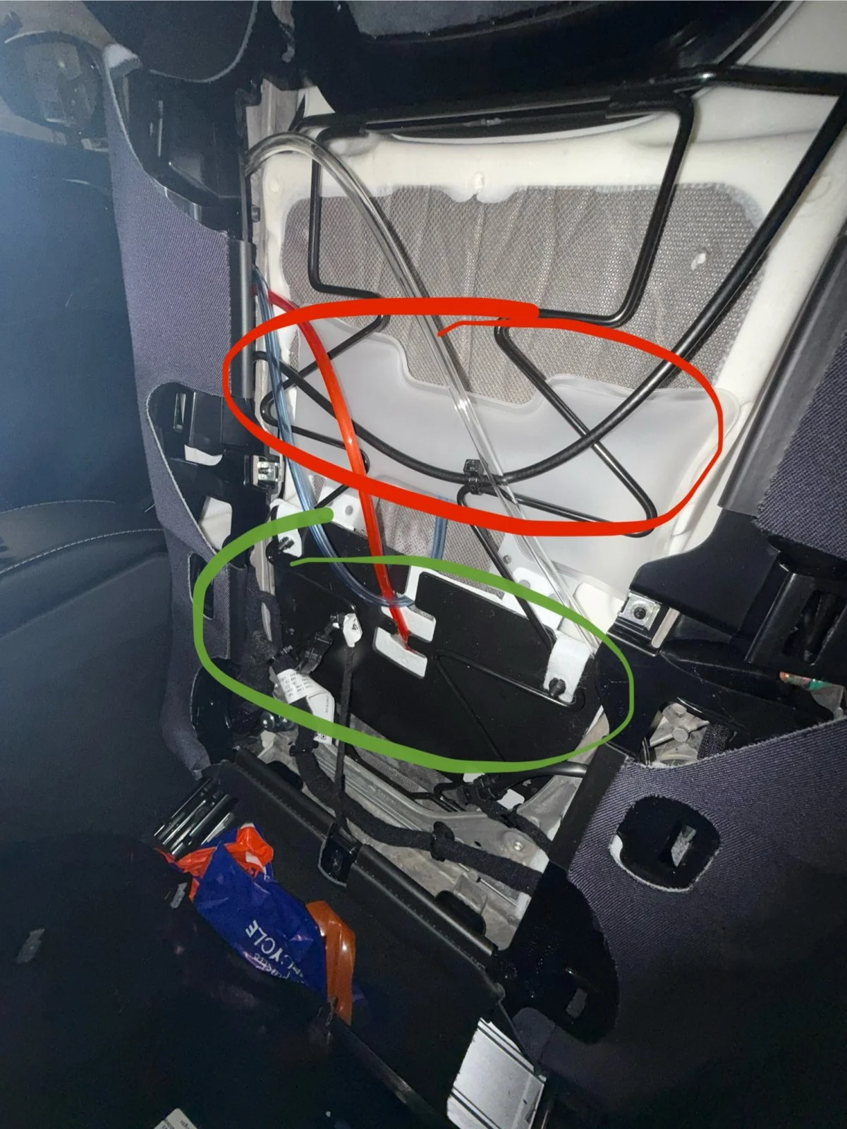

Ok. Took the seat back apart. There are two air bladders on top of each other so both inflation buttons will move out the same area which is pointless. I positioned one bladder upside down and higher up the seat (circled red) and put a plastic panel (not pictured) behind it just like the lower one (circled green). Now I have lumbar support adjustment in different areas!
To remove the seatback there are 2X torx screws under the logo and 1x inside the seat back recline lever. The rest is held on with clips.
Damn I feel like this needs a tutorial of it's own lol.
A video showing these in action and how these work would be really helpful for making adjustments. So the lumbar moving up isn't really moving, it's the difference between 2 bladders? One above and one below?

Hi Many thanks for this,
my car was getting unbearable to drive as there was a hard object that pressed into my lower middle back causing pain and numbness in my legs.
I removed the rear seat panel (5minutes job) and I immediately found the culprit, the tube that enters the bladder was what i could feel, i removed the two bladders and cut out a square slot in the hard plastic that allowed the tube to lie flush with the face of the lumber area of the seat.
I then placed the lower bladder as far down the back rest area as possible so when inflated it actually supported the lower shallow (arch) of your back, i then placed the second bladder above leaving a 3 inch gap between the two bladders which also is where you need the support in the upper back area.
I did not have any stiff plastic so i used a thick cardboard cut to the same shape of the plastic and again cut a small square section out to to allow the inflation tube to move backwards away from the front of the seat area.
I then took the car out and I immediately felt a massive difference so much so that the seats are now what i would call very comfortable, i was at the point of dropping the dollar on B10 Tillets but now there is absolutely no need.
The whole process from start to finish took me 25 minutes and is the single best mod that anyone could do in my opinion if you’re experiencing pain and an uncomfortable driving experience.
Once again many thanks for the write up as i would never have thought to do this and either purchased aftermarket seats or simply sold the car.

I don't know about some of them being in the correct positions. Mine were, like other's, seat lower back bladder, bladder, and black plastic bladder backing. After doing mine, seems like nobody told the seat assemblers to unfold the bladders before installation. I placed firm plastic behind the bladder I flipped up, but not sure if it is necessary. Now I can air above my butt, and air below my shoulders and any combination of the 2.

I agree the install looks correct, but the function makes no sense. My 2 cents, why have 2 buttons that inflate the same location? My Lexus, Porsche, and Toyota 4 Runner all adjust back top lumbar and bottom lumbar. Once the seat back is removed, I kinda man handled the black plastic backing out of the seat and flipped up the bladder. If I am not mistaken, the red tube bladder should be the bottom and the clear tube bladder is the one I flipped up and added a plastic support. HUGE difference, maybe, maybe not, but I can now feel when I add air to the top and the bottom and when I air them out.
