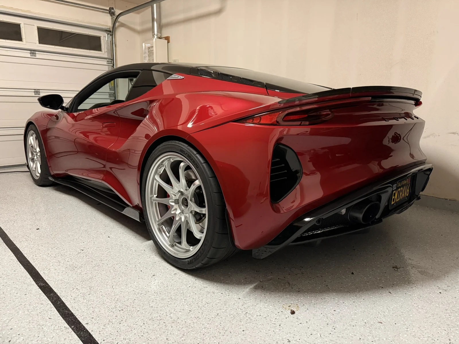

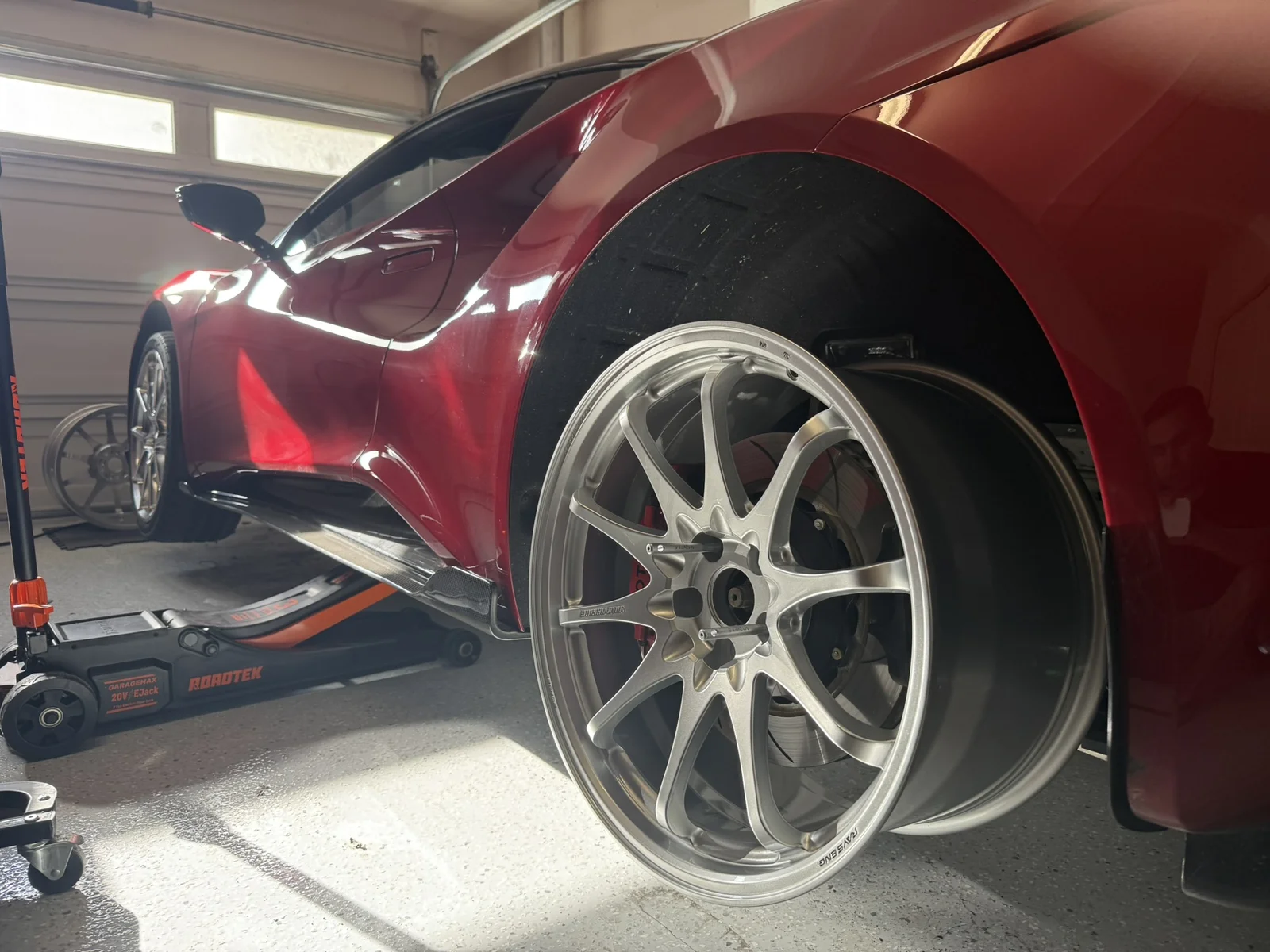

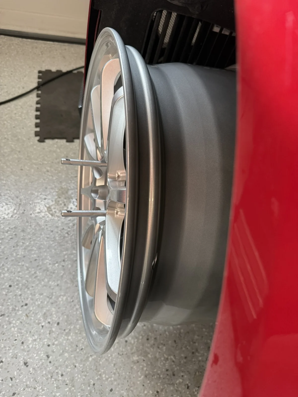

Still working out fitment issues and ride height but new wheel day, look at how chonky those tires look:
- 19x9.5" Vitour P1 275/35/19
- 20x11" Vitour P1 305/30/20

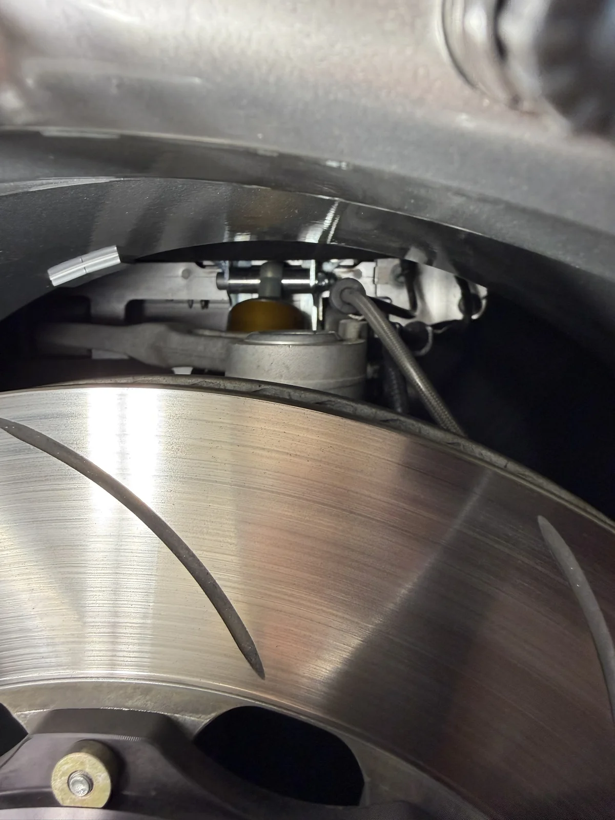

Ran into some clearance issues up front, I had to bend the brake hose bracket inboard on the control arm to make clearance, and I had to dump the front brake ducting from the GT3, will try to remount with more trimming later.
Even the fronts have a bit of concavity.
Are we doing the same offsets because that looks amazing?
Just osted that my car is on Everyday Driver!
hes got staggered setup 19x20. but otherwise yes.

Offsets are just one parameter of many. Lots of work to clear like brake calipers, emergency brake calipers, sway bar end links, brake hose brackets, brake hoses themselves, wheel speed sensor wiring, fenders, fender liners and even control arms. It's been a process!

275s up front clearing well, initially I was getting some sound at the extremes while moving forward or backwards but that was likely due to the shiny sectioned tiles in the driveway and the brand new tires with the ackerman on this suspension geometry causing skipping.
Only really thing that may need to be done is bending over the brake hose bracket into the center of the upper control arm up front, takes 10 seconds to do so.

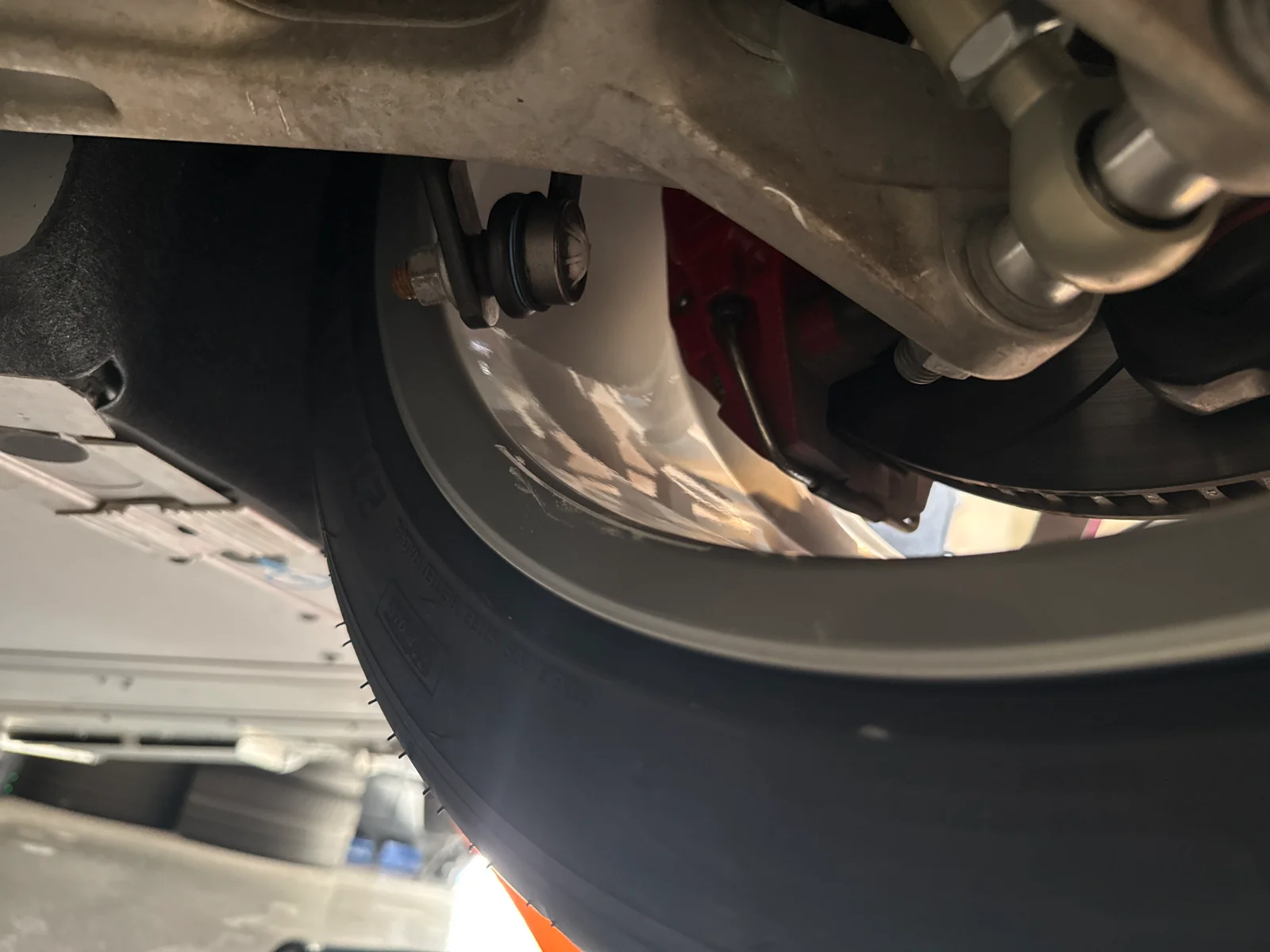

If you don’t do this on 9.5” wheels and you’re at 19” or 18” — that bracket will likely hit your wheel at the extremes and put a nice scratch into your wheels, just like this…

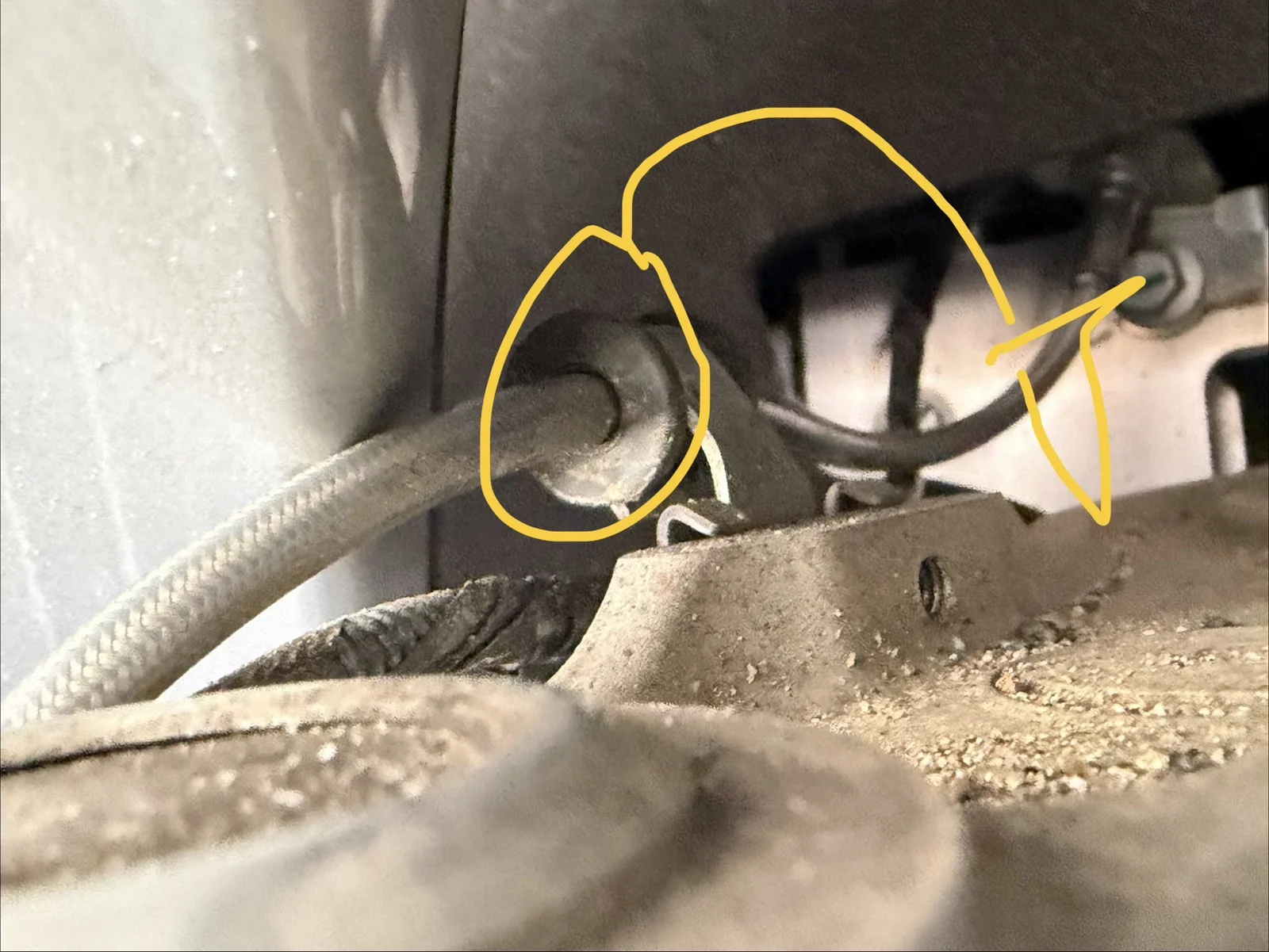

Thank you for letting us know, especially since I just ordered my 18s
Did you take a before and after pic of how much you bent it?
Excuse my crude drawing. but essentially you bend it according to the fantastic arrow's direction.
I don’t have a before picture but the bracket stands straight up on the upper control arm stock, if you don’t bend them the wheel will bend the bracket outboard and twist it and it’ll lead to digging into the rim edge. Just bend it towards the center of the control arm, it’ll be super obvious when you put the wheel on. I just bent it as far as it would go which isn’t very much you can scroll up for a photo.
