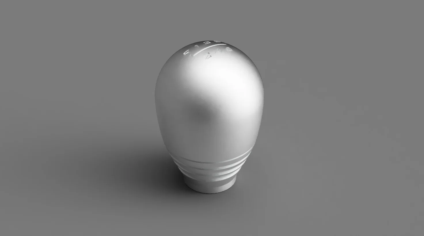

A better representation of the ridges and shape of the overall knob.
Coming soon for all of you, I designed this for Darkworks!
It's a Feel's style shift knob but for the Emira/Evora/Exige V6. 48mm diameter ball with a bit more extension for those of us who like to hold shifter from the side and the top. The H pattern matches the OEM one and 70mm overall length.

I estimate the mass should be around 212g vs the 115g for oem. Those are just estimates based on CAD mass models out of 6061 aluminum so they’ll probably be +/- 2%.

for reference my knob currently is around 165g, so this one edges it out some.
This knob should be a good match for those with a short shifter to balance out the taller knob. It’ll feel good on more grip positions, be heavier, and closer to the steering wheel.

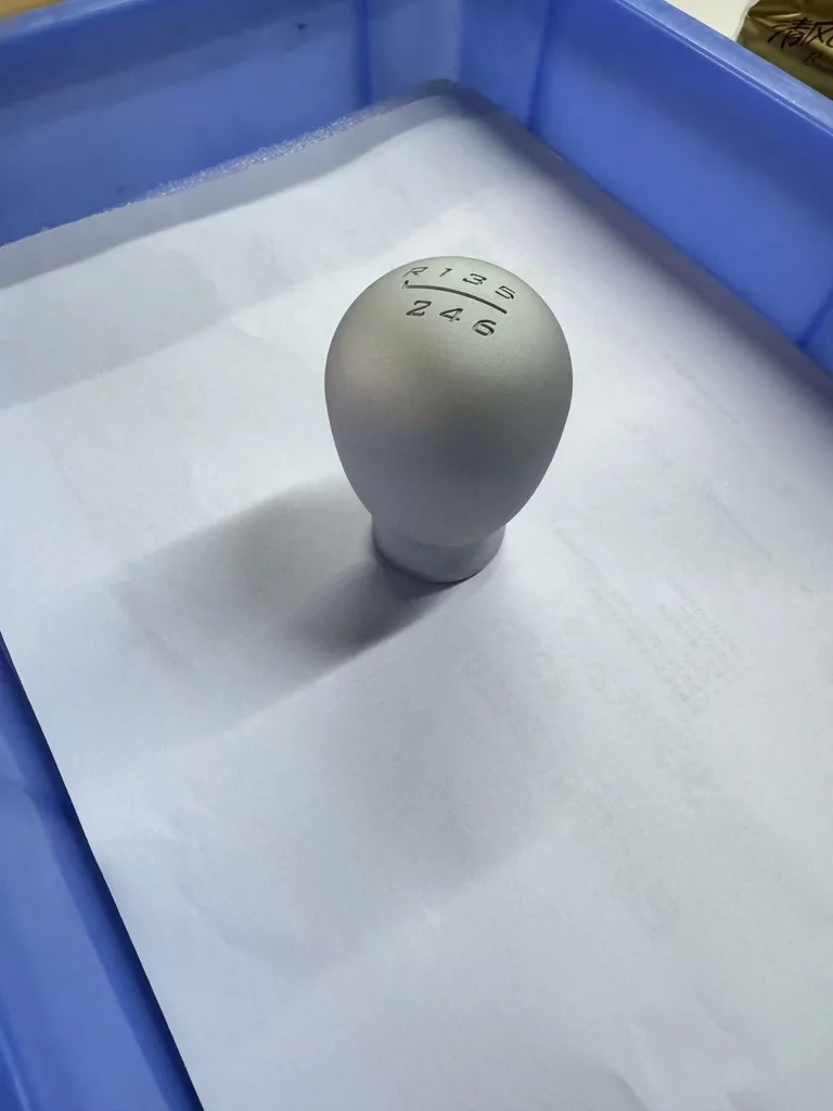

Baby’s first CNC! :ROFLMAO:

These will be available with Suntory on his site and will come in around an estimated weight of 209 grams vs the stock 115g.
It’s part of the JDM reimagined series of shift knob I designed for him.
I don’t get anything out of this except for maybe a free shift knob for myself in addition to learning more about modeling and CNC. πŸ˜†
