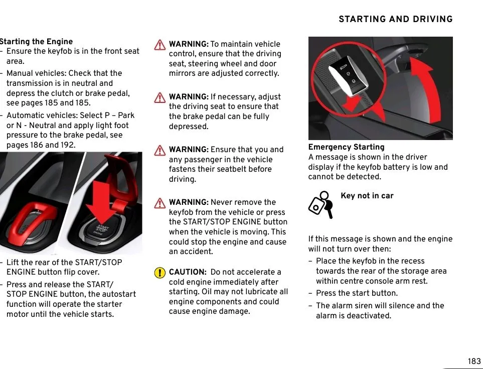

If you have the key not in car error, try putting the key fob in the rear in the center console storage area (recommended by manual) or in the bottom of the rear most couple holder (recommended by dealer).
  • #6
Yeah that’s the tray recess I mentioned it doesn’t seem to do anything
