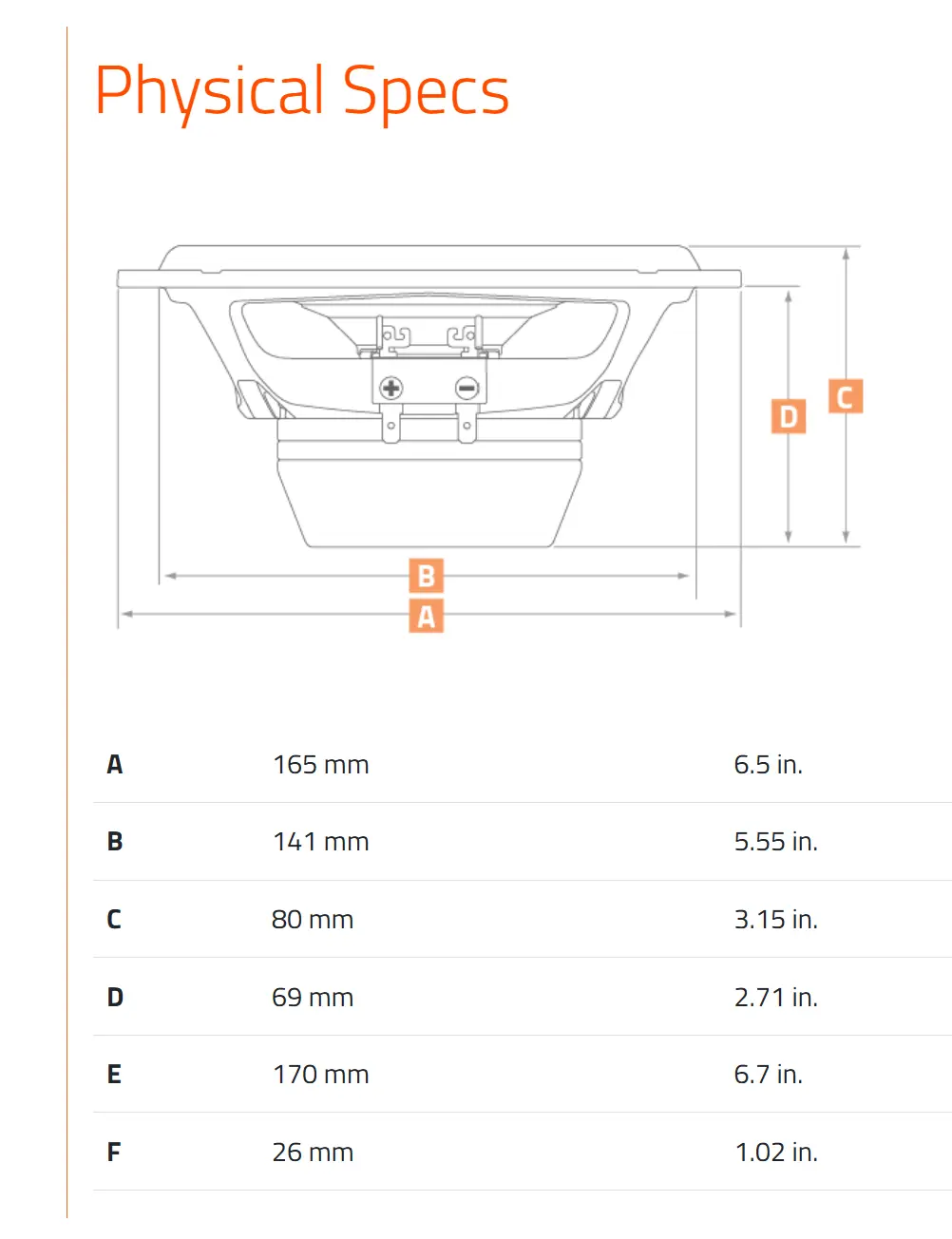

with your speaker adapters, how deep of a speaker can you mount?
Hi docron,
The Hertz Mille ML 1650.3 speakers I used are 3.15 in. (80mm) depth, which easily cleared the window - see below snip direct from Hertz Audio website.
What speakers are you wanting to install?
probably some Focals, just needed to figure out if needed slim or regular speaker depth. thanks for information!

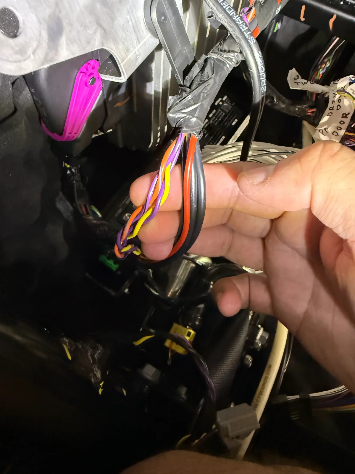

I figured a lot out but wanted to place the info here. On the black amp, all the speaker wires you cut are right before they go into the amp on the center plug. I removed the plug to make things simpler. With the black amp in its factory position, the right plug, you also cut the 4 wires for the center dash wires (since you don’t need the center speaker).
For the two rear speakers, the four wires are held just below the factory speaker. All of the wires above are all pre-factory amp.
My question is: the factory sub plug is 4 wires that match your color codes but they are after factory silver amp, not pre-amp, is this the right 4 wires for the sub? I don’t see any other set of 4 wires off the silver amp that match your color codes, plus, I only see 4 other wires going into the silver amp besides the 4 rear speakers wires and 4 other wires in that same bundle that look to be the amp power and ground wires with two other wires (maybe the two are the sub in + amd -? Hard to see but my photo is the bundle going to the silver amp that runs under the factory speaker. (4 wires are the rear speaker wires). The other 4, no idea.
I've sent you a private message.
Please cut the color coded wires and run these as the Speaker-Inputs to your Audison Amp (Yes, these are then the Line-in speaker Signals)
Please clarify a little more regarding "The lines going into or coming out of the amp (assuming colors are the same)?"
To which amp(s) are you referring, the factory amps?
I figured out what I was asking. Basically looking at all your photos, the Audison speaker line-in all come from the two amps. IE. I’m connecting from the amp side of the wires, not from the wires before they go into the amps.
