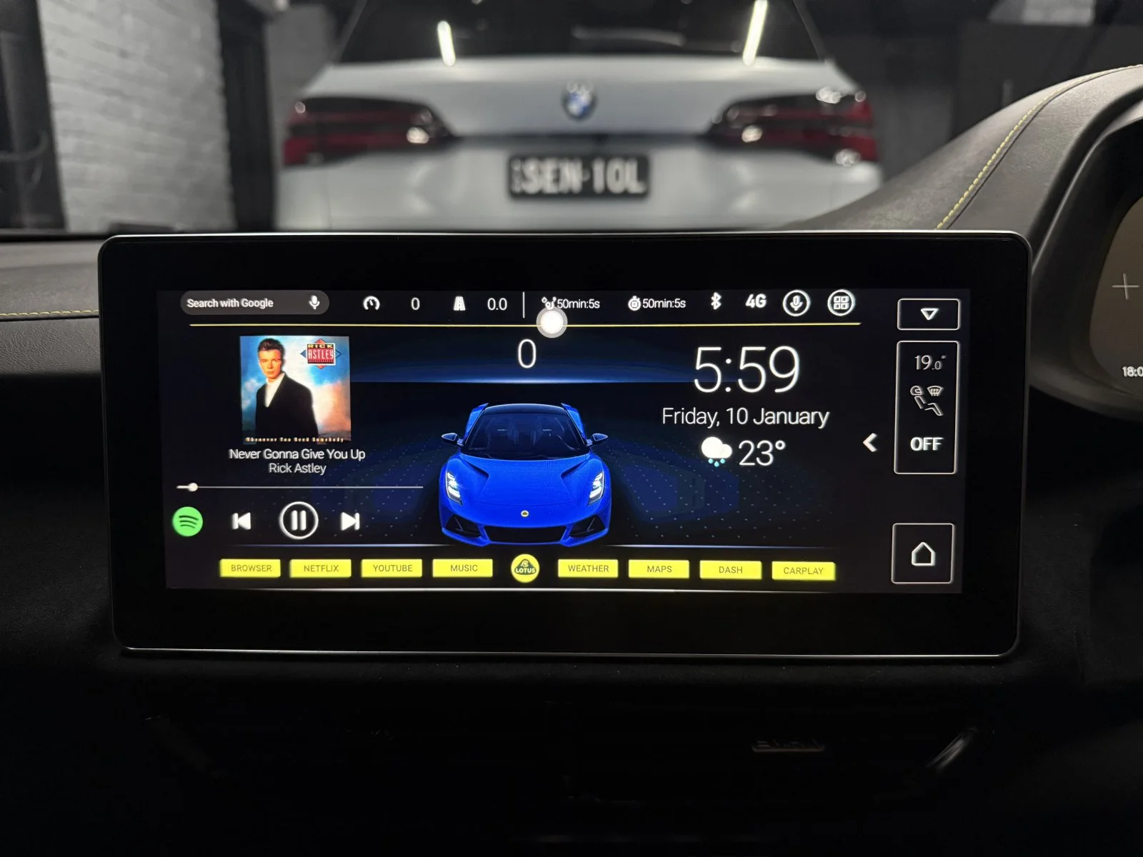

Got the Milltek controller integrated into the UI now :)
Tap “Quiet” and it goes to OEM mode. Tap “Race” and the valve opens.

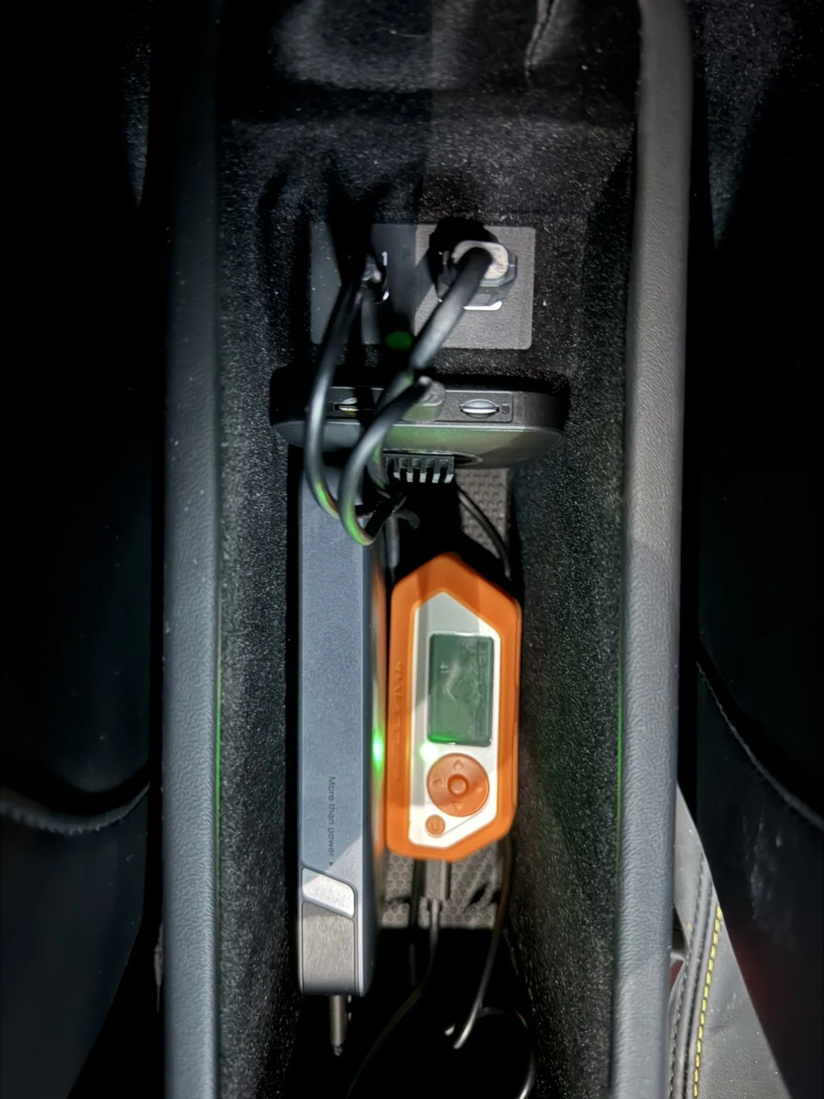

Here’s the brains btw. Plus an OBD ELM reader.
Still some tidying up to do but it’s functional for now. Yet to test thermal management properly. The battery is just so the Android system stays running all the time so it’s easy to go as soon as you start the car. Not essential but works nicely.
Flipper is just to send the RF commands to the milltek exhaust controller, so not necessary if you don’t want exhaust control and/or don’t have a milltek controller.

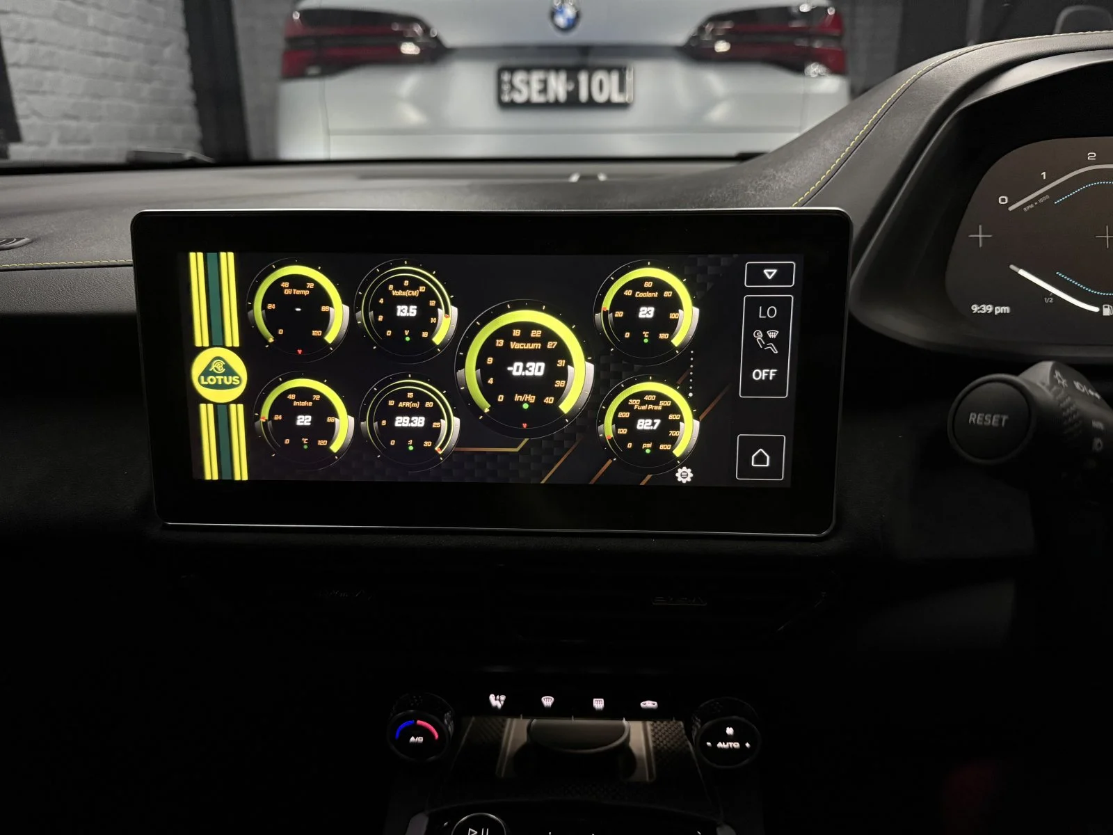

This is awesome, good work bro. I like the idea that I could open the draggy app on the main screen of the car to show positive/negative deltas on lap times instead of having a phone fall off a suction mount on my window every few laps. Eagerly waiting and thanks for doing the hard work!

The stock Android Automotive UI is very basic, but this adds all the functionality you could ever want including OBD2 gauges, GPS Nav, 4G internet connectivity and the ability to run any Android app you want, including Netflix, YouTube, etc.
Best part is it doesn’t require any modification to the car at all. Everything is completely plug and play into a USB port and OBD Port.
It’s not rocket science, but a tonne of time has been spent finding the right hardware/software to make everything work properly and customising the UI to make it suit the Emira.

One suggestion: You might want to make the Exhaust buttons a little larger and a little farther apart since there is space.. Might be hard to press them precisely while driving (I push my button a few blocks from my house to quiet it down).. Just a thought.
One question: Can you change the Seneca color of the Emira (or make it an option to change)?

It’s just a background image so you. An change it to whatever you like. And yeah I’m working on some different buttons that also latch so you can see at a glance which mode you’re in. It’s kicking my ass though. Hopefully I can have it working soon.
