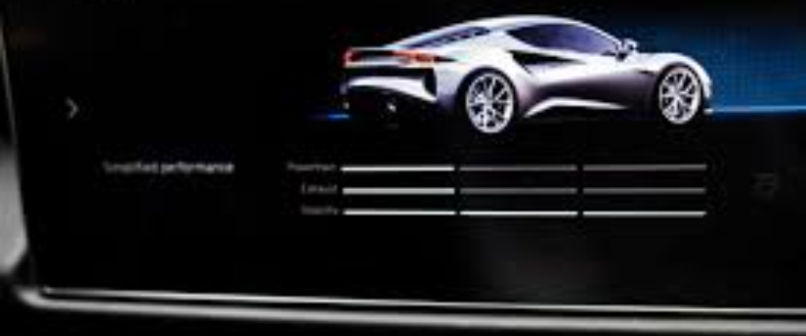

I’m building a fully custom Infotainment UI
This one. I'd pay someone to make a render of my car. I just want to know if your mod allows us to change the image file.
Unless I've misunderstood, and @Sentinel is a leet haxor, this replaces the stock Android Auto UI... you won't be able to ride roughshod over the rest of the infotainment UX.

I hope @Sentinel can confirm, but I this is my understanding:
Think of the project as a combination of an Android app and the proprietary hardware it runs on (instead of your smartphone). The hardware will allow extra goodies not available on your smartphone, such as data interface from the CANBUS and Homelink compatible functions. The car will boot up as normal (all the Lotus designed splash screens, seat belt warnings, etc.), start Android Auto, and then connect to the device. All functions that came with the car are untouched.

Correct
Ahh right. No it doesn’t alter the stock system at all. All the original stuff is still there. It loads over the top via Android Auto
So for those with an iPhone (IOS), nothing will happen?
Let's wait for an answer from the OP, but my speculation is that it would look like you went out and bought an Android smartphone: the car will still connect to your iPhone, allowing you to take calls and other standard Bluetooth functions, but you will have to toggle between two devices to use the apps on each device.

CarPlay is still supported. You just connect your phone to the new device instead of the car.

While this secondary device is directly plugged in via USB, do you anticipate that bluetooth for phone calls would continue working?
Would changing the style of the main driver display be a possibility? ie, to some virtual analogue circular guages?
Yes it plugs in via USB, Yes phonecalls, Android Auto/Carplay all still work like factory but without the constant dropouts and need to reconnect every second day.
