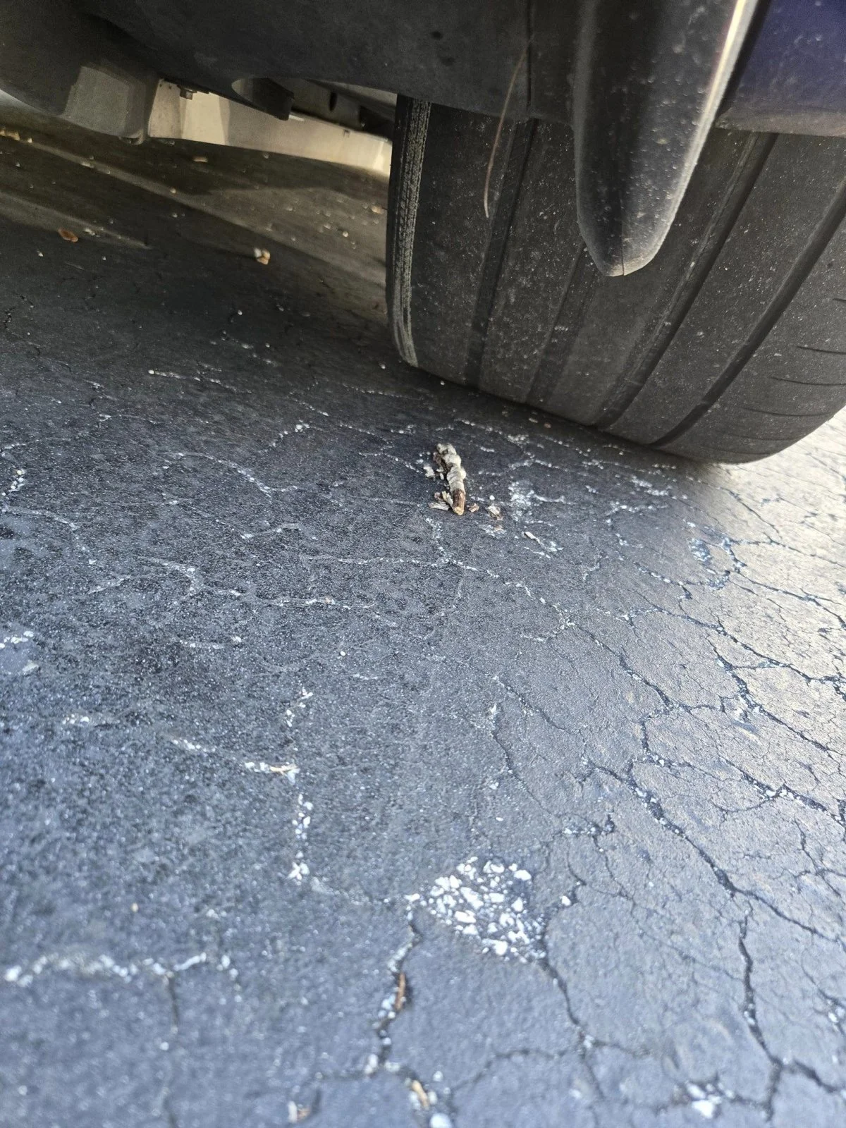

Was in for a nice surprise when I looked under the car today. I'm on the Eagle F1s and the sport suspension. I have about 6200 miles on the car.

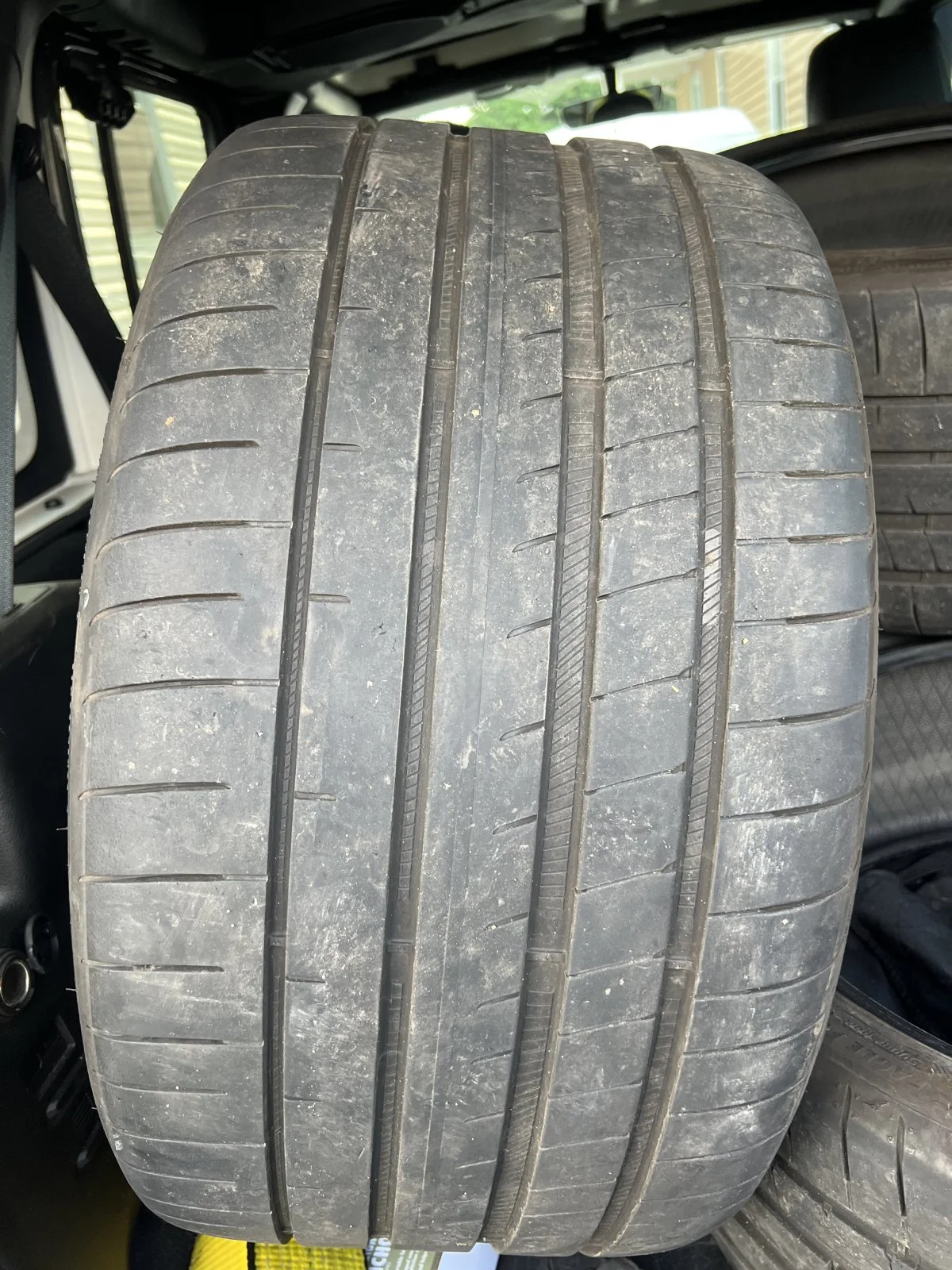

Mines have seen roughly 8.000 miles And the rears are nearly done.
I had once the same issue with my Speedster, I think it‘s a combination of a lot of camber at the rear and spinning the wheels at low speeds.
I’m thinking the same. Looks like rear camber and driving the car hard in a straight line and not sideways. I would get your alignment checked if you haven’t already. Else you’ll run through these new tires quickly. If the alignment is in spec I would ask for a less aggressive alignment to improve tire wear based on your driving habits.
This is the same thing that happens if you get your car setup for the track with lots of camber and never change it back after the track day. Your normal driving prematurely wears the inner tire.

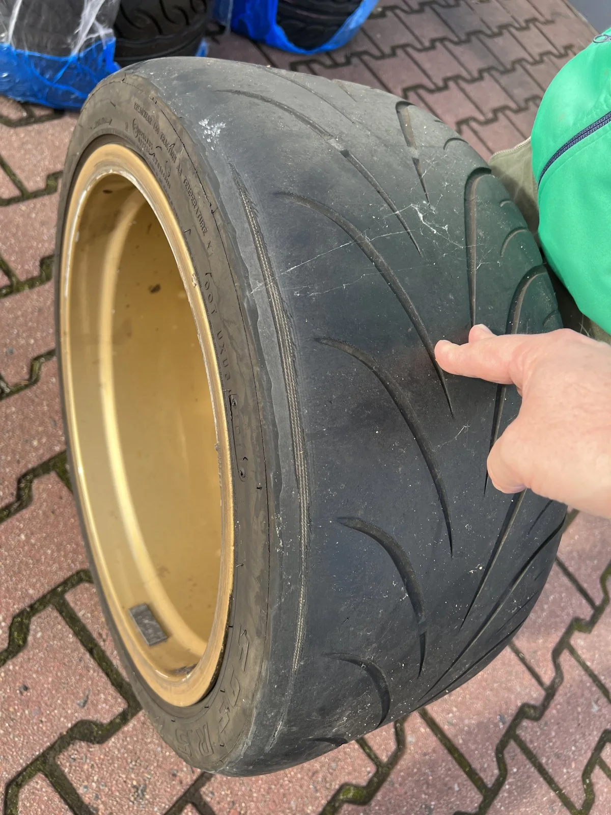

Using Goodyear F1. Amazing tyres will never change to anything else 😆 I’ve done 4 semi-track days, and in total about 25.000km they still look like new. Grip is perfect for my needs. I think 40.000 km is an easy task.
The Emira kills the outside edge of the tyres on track and there isn’t enough negative camber on stock setup to kill the inside edge from normal driving. My car was geo checked and was within spec.
If getting lots of wear on inside edge, the alignment is out I’d say.
