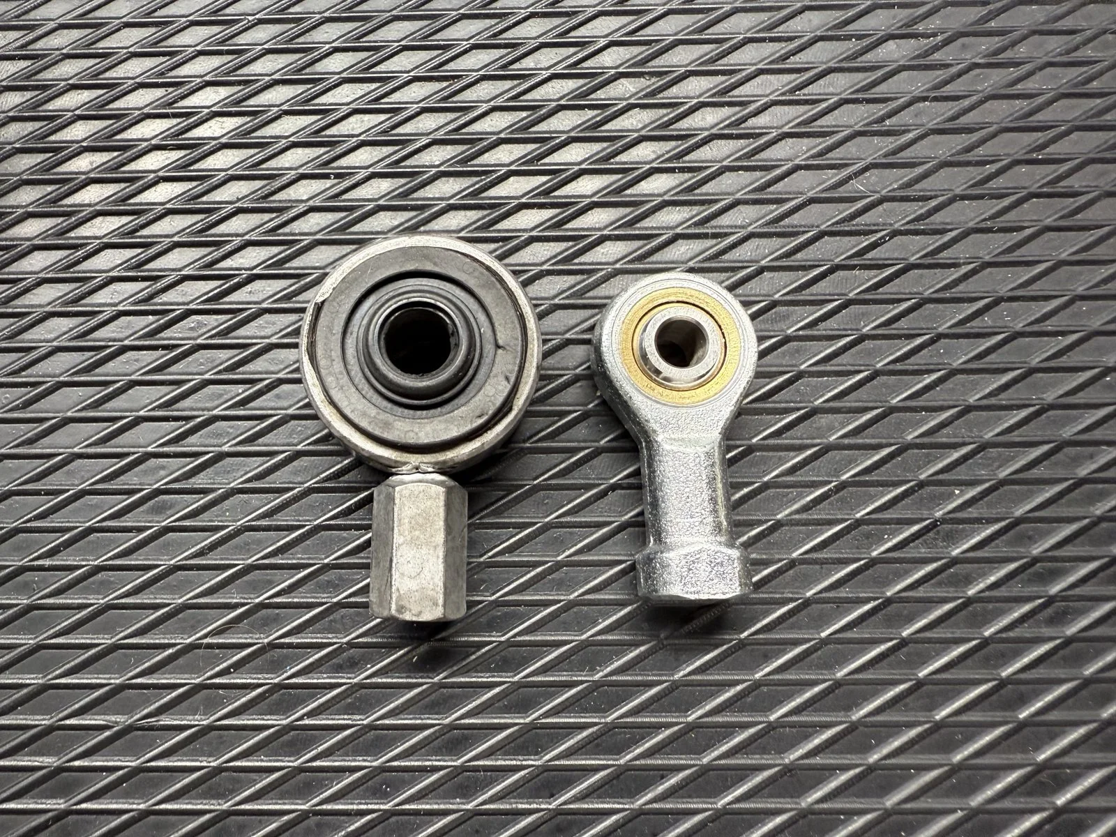

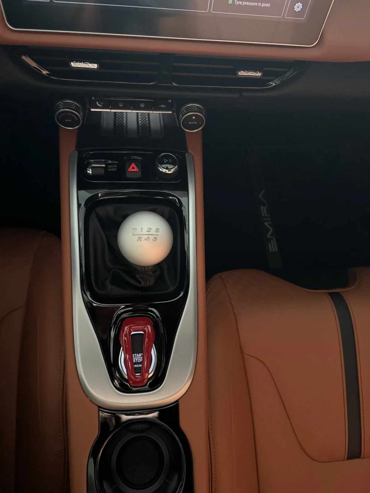

Thank you all for your guidance and special shot out to @kitkat for the video tutorial of the short throw adapter, excellent write ups on the reverse lockout plate and boot delete. I ended up installing an Aerie short shifter and so far I like it. Here are a few thoughts on the mods today:
- Reverse lockout plate made a huge difference. I knew that after driving it for a couple months the sifter felt sloppier than then I first bought it. Mine was sitting very low.
- Aerie short shifter install went okay, although I only used one end link? I emailed them to make sure this was right. I used Kitkat's video as a guide.
- I decided to install the boot delete and keep the mesh grill below. I really like how clean it looks, even with the tan interior. The graphite look of the 3D printer looks really good contrasting the piano black and metal colors around on the console.
I'll share pictures later.

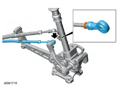

You will need to unscrew the short shifter a few turns (trial and error) to fix the rear-bias caused by pulling on the shift cable too much. As for the right-bias, can't adjust it here because the short shifter adds thickness to the overall assembly, pushing it down. You will need to adjust the selector cable (the other cable) for that. I just left it as-is and it hasn't bothered me, albeit it is a RHD vehicle.
[edit] The "other cable" is referred to as the "Crossgate Cable" in the Service Notes, and you will need to adjust it from inside the cabin.

Any reason to keep the green marks on the shifter linkage? Now that the boot is removed, I'd prefer to remove it for a cleaner look. If there's no issue taking it off, any particular solution you'd recommend?
Thanks for the tips!
No issues, they come off with pretty much anything including just rubbing it off.

@Aerie - Can you confirm whether the second end link is for for the Crossgate Cable for the Emira?
