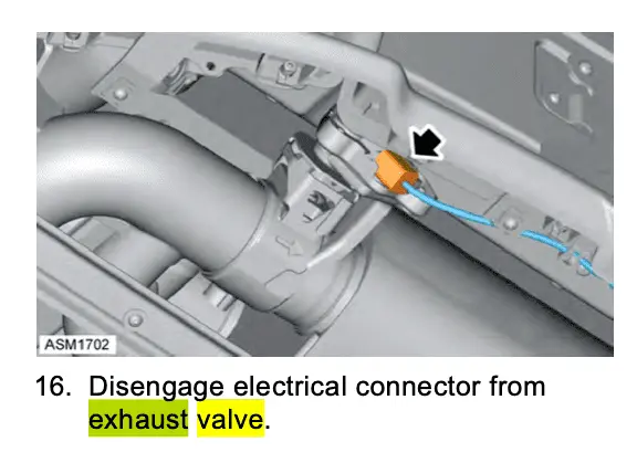

Adding some more context to this conversation with some information from service manual.
There is a single exhaust valve and it's electronically controlled, it has to be disconnected to remove the rear bumper, presumably the harness for it is attached to the bumper.
Based on posts from other early owners throwing codes related to the exhaust valve it would seem that the Lotus ECU may indeed check that the valve is operating correctly as one seemed to maybe get stuck and throw a code. This might make it slightly more difficult than simply unplugging them for those that want it loud all the time -- or even people like me who want to control it via GPS for sound checks at race tracks.

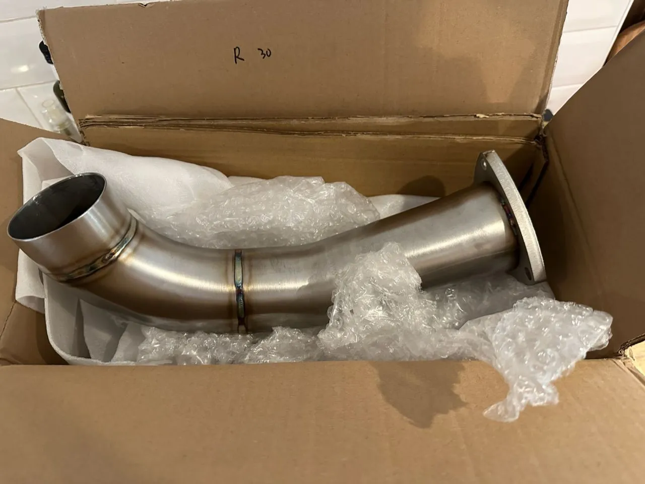

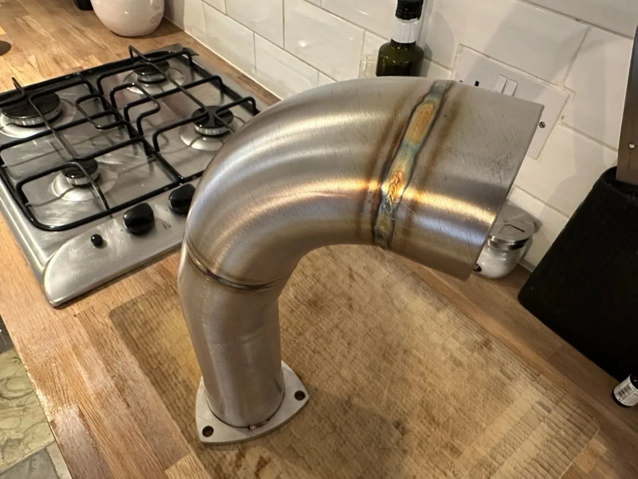

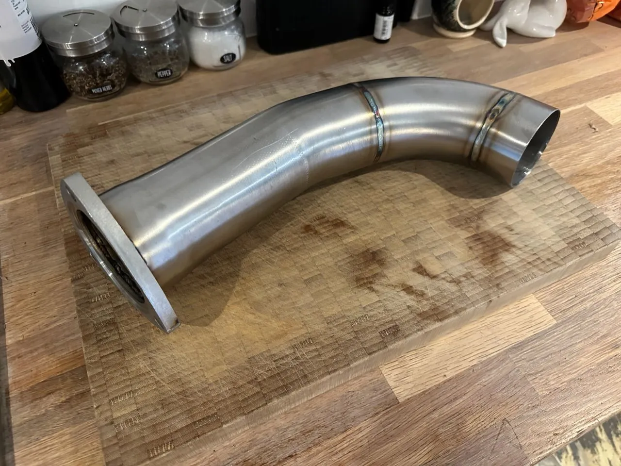

With the Komotec bypass pipe I had to pay £68 import tax… but UPS having been saying I’m out when I’m not so I still haven’t got it… shouldn’t be long now.
On the plus side the insurance company only wanted a £9.50 premium for adding it to my policy :-)

Look forward to the update
