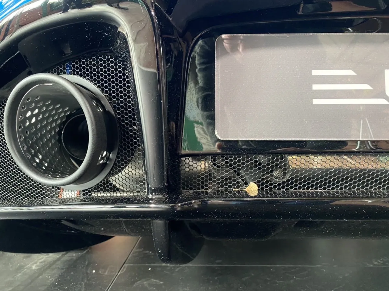

You can see the electrical connector on the valve through the mesh under the number plate. It even has a little cooling scoop under it on the diffuser.
I asked Scott Walker at one of the roadshows last year and he confirmed that was how it worked.
I asked Scott Walker at one of the roadshows last year and he confirmed that was how it worked.View attachment 20715
