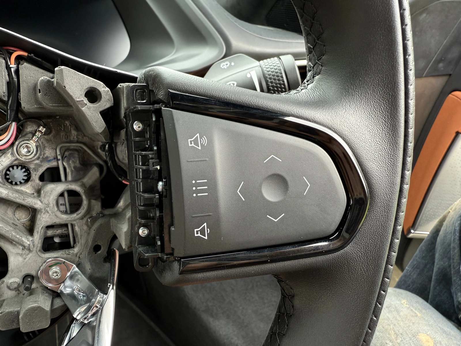

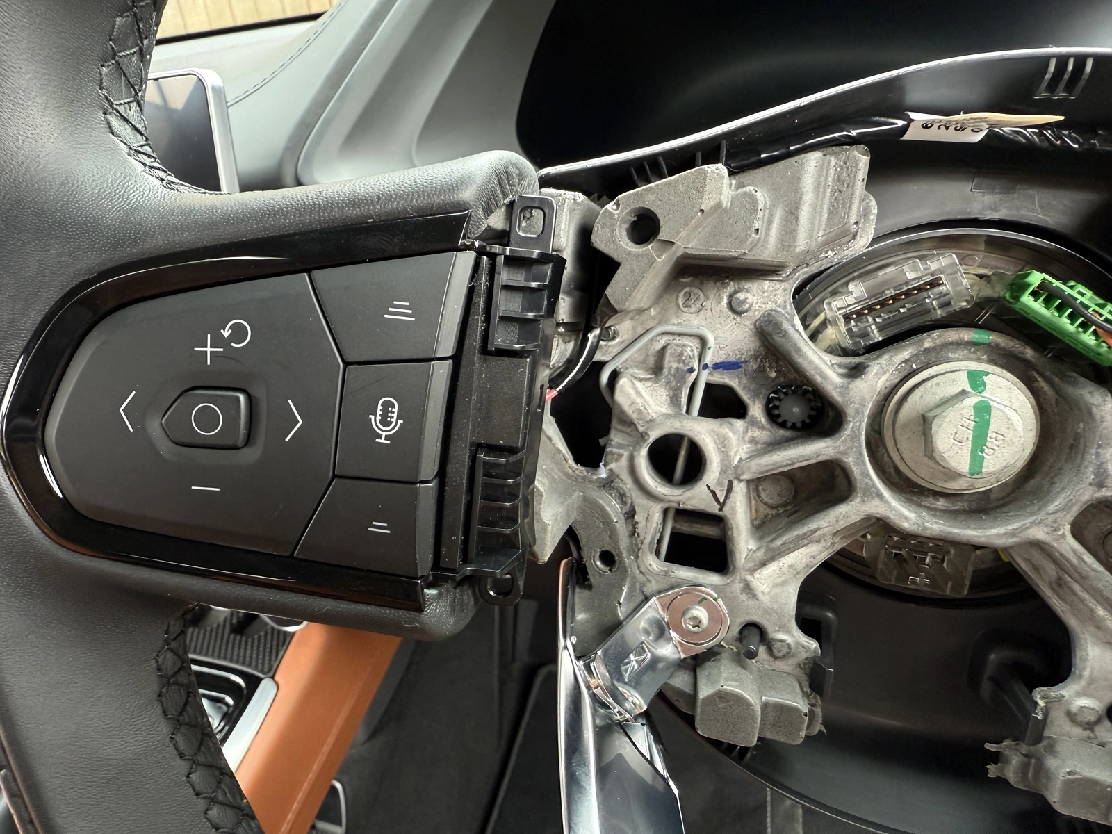

The AliExpress buttons are certainly not used. Perhaps it’s a way to get around taxes. Swap is easy as described but don’t make the mistake I did of thinking I needed to unscrew the little silver screws. They just hold the switch unit together. The replacement buttons don’t have these screws but both versions just push on/prise off. New versions are a big improvement!
The AliExpress buttons are certainly not used. Perhaps it’s a way to get around taxes. Swap is easy as described but don’t make the mistake I did of thinking I needed to unscrew the little silver screws. They just hold the switch unit together. The replacement buttons don’t have these screws but both versions just push on/prise off. New versions are a big improvement!View attachment 65152
