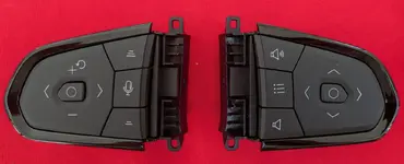

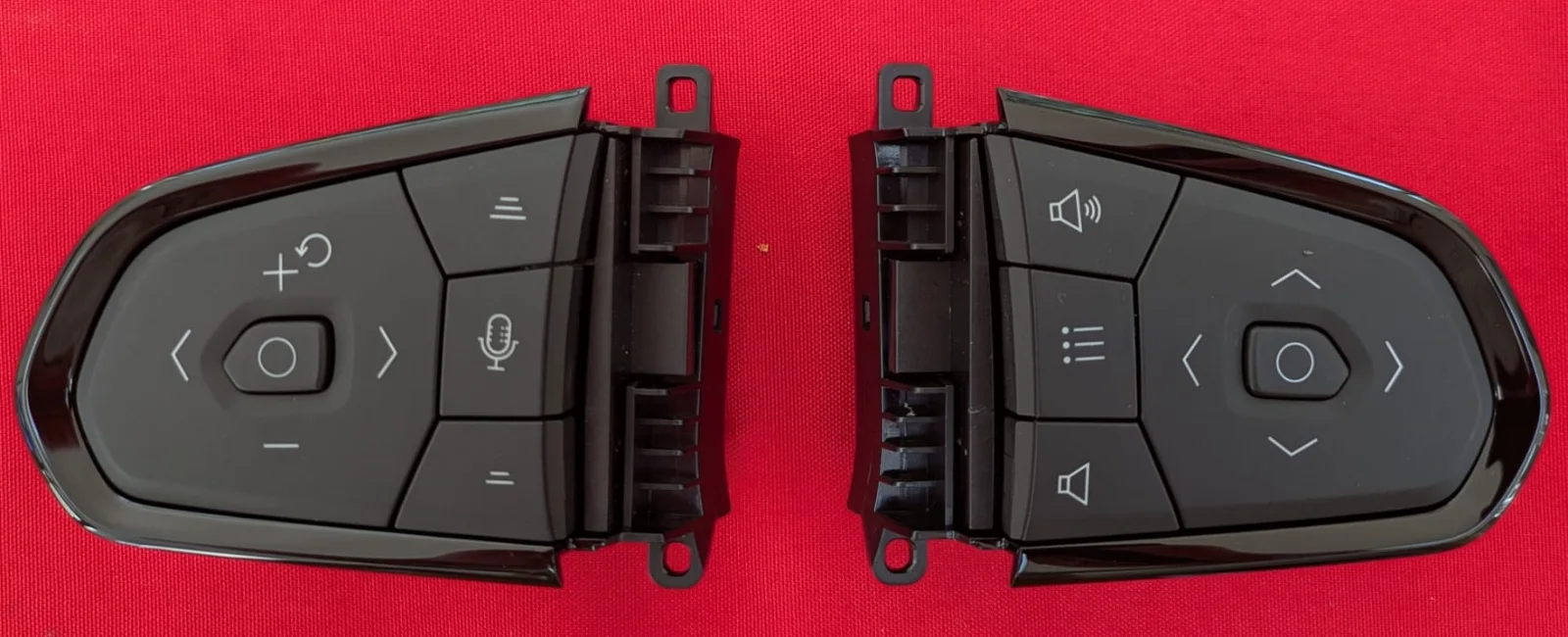

My key clusters that I ordered on the 20th arrived today, quicker than I had expected arriving in only 9 days rather than the quoted 4-6 weeks.

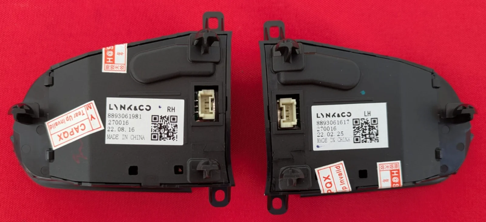

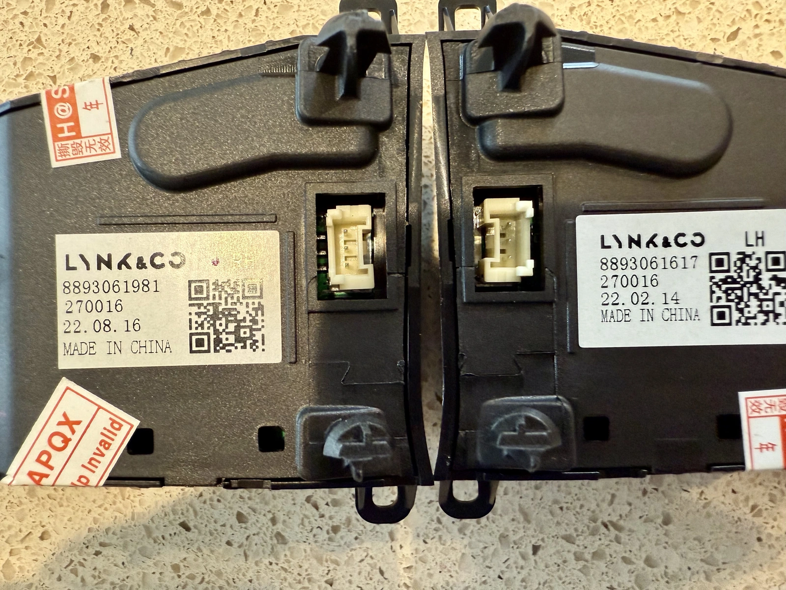

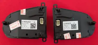

The parts look new but they could be used as they are in perfect condition there’s no way to tell. I did note that they both had a manufacturing date of 2022 so I suspect they are used or at the best new old stock.

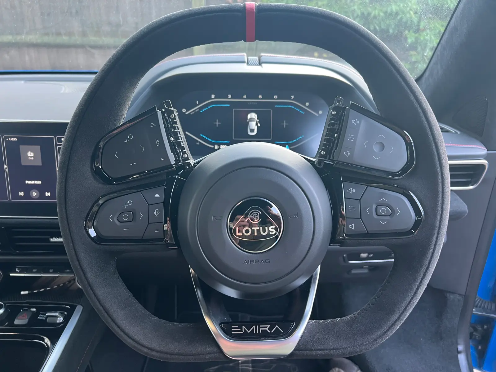

I followed chirowolf’s excellent guide on how to fit these – here.
I didn’t disconnect the battery or the airbag whilst doing this as I didn’t want to upset the EMU and have to reset it. I did cover the airbag in a cloth once it was off the wheel to ensure it wouldn’t get inadvertently shorted out. With the airbag still connected and dangling off its wires there's room to remove everything else.
Watch the video carefully when he takes the airbag off for the location of the two correct holes to use - surprisingly there's a lot of different holes on the steering wheel and it’s easy to try to use the wrong one, they are on the side of the wheel not behind or under it - the 'spring' you press back against is obvious when you have the right place. I spent 15 minutes in the wrong place. I used an allen key here instead of a pick.
The inner surround comes off easily with some wiggling. The key clusters themselves are held in by friction and not any catches or latches - pull them steadily away from the wheel to get these off, I found it was easiest to get a flat blade screwdriver under the outside lip of the key clusters and gently pry them up away from the wheel to get them started.

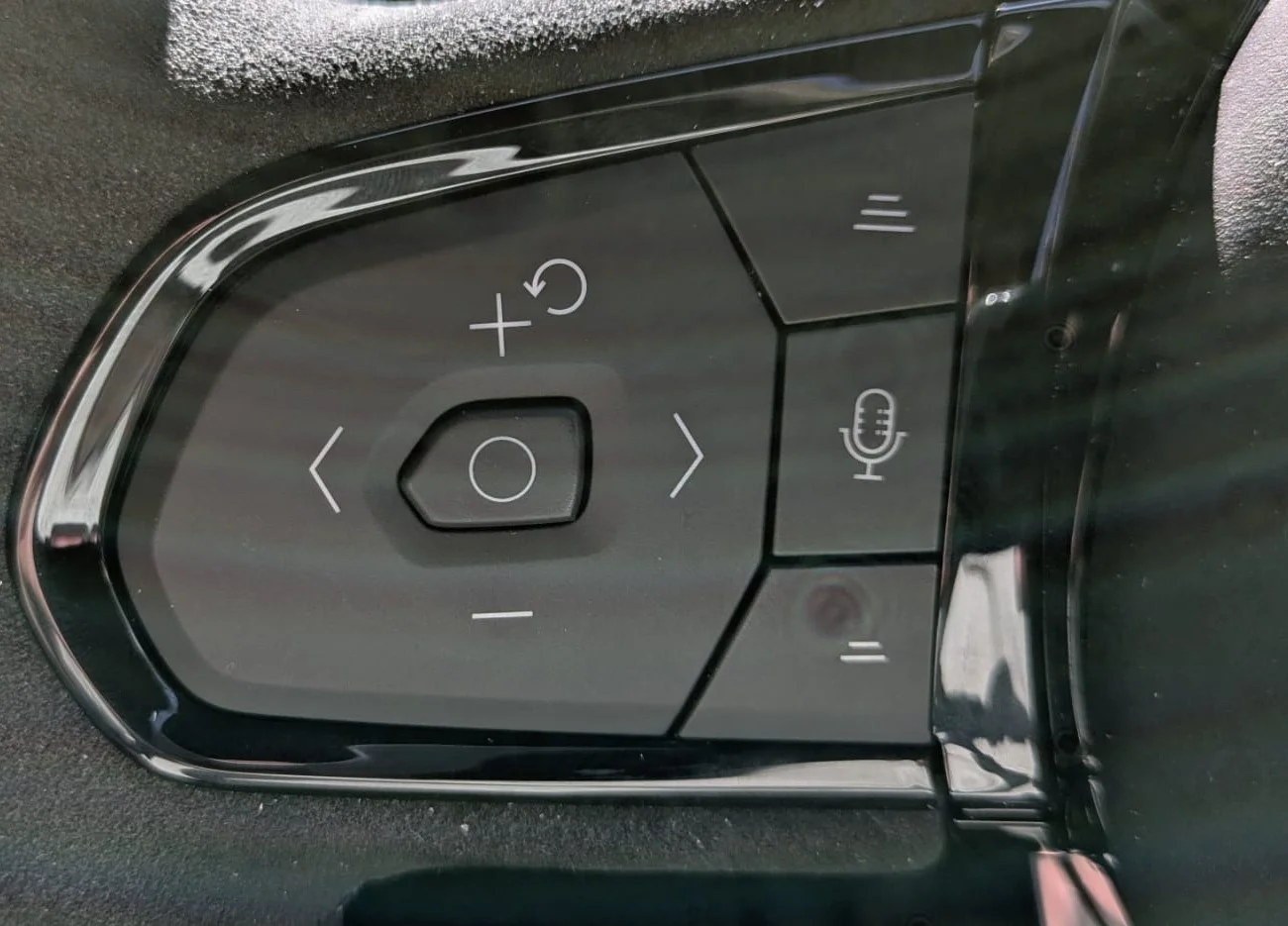

Once I had located the correct hole the whole procedure took less than 5 minutes end to end (…that’s what she said).
The buttons are working perfectly and look great I think. So much less annoying that the touch sensitive ones that I kept accidently swiping on.
I also learnt that the horn goes off not only when you press it – but when you pull it towards you, so numerous times whilst I was trying to pull the airbag off – no doubt impressing my neighbours!

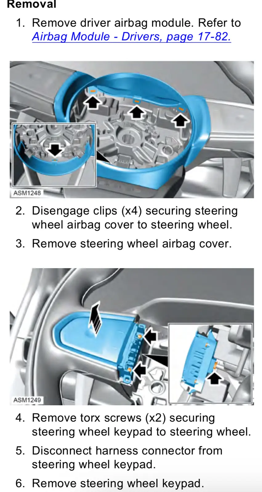

Couple of additional fitting tips:
If you have the service notes, ignore them.
Do not remove the small torx screws. They’re not holding the switches in place, they’re holding them together. You will discover this when they fall apart as you try to take them out! (VOE)
The new switches are a different construction and don’t have the screws at all.
For anyone who can’t find the hole 😁 :
My 6mm punch was perfect.

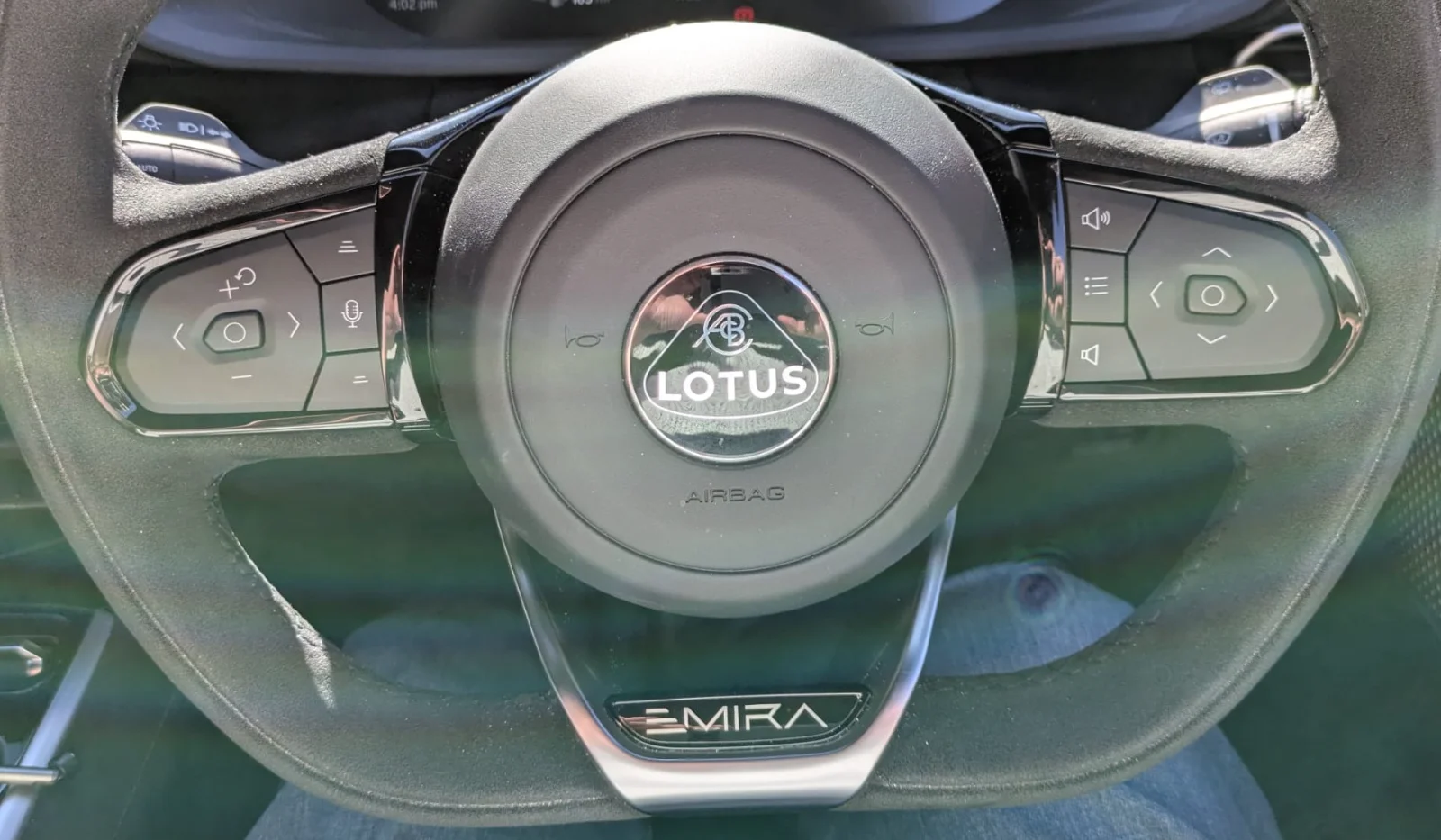

I just received my Emira today, I am happy with everything about it except the steering wheel buttons.
The non-touch version of the buttons is available and shared with another brand under Geely (Lynk & Co), and you can get the OEM replacement part from China for much less than what is being sold here in the states. The Emira actually uses the Lynk & Co part, if you remove the steering wheel buttons you can find it in the back of the assembly.
I am going to purchase one and have it shipped, but is anyone interested in a group buy? If we have enough people I can ask the supplier to give us a discount, currently is about 60-70$ with shipping.

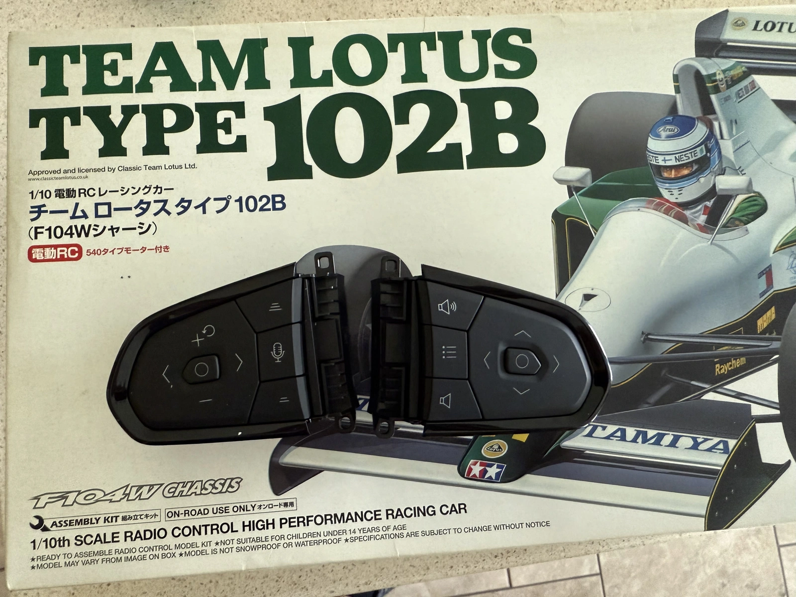

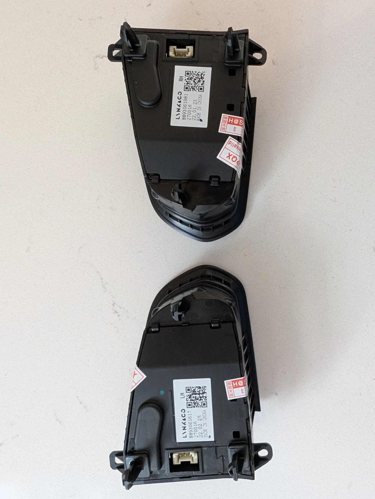

My switches from Alixpress showed up today. I got on these early when the listing still didn’t say second hand. They look brand new to me.
pay no attention to the Tamiya F1 Lotus box in the background.

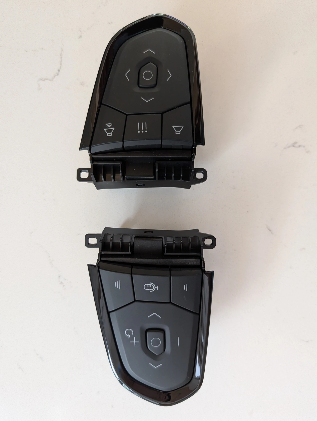

Got mine today. They look new. Glad I grabbed them when I could.
