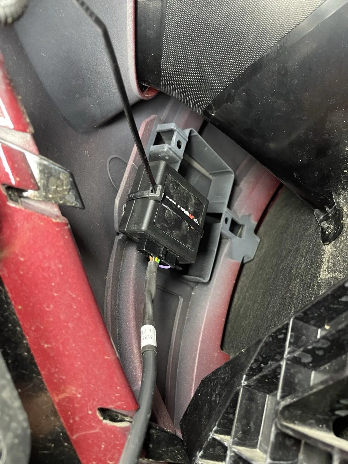

I haven't seen any posts on where people have installed their Active Valve Control module. Where has everyone attached the control module?
I attached in to the inside of the rear bumper, passenger side corner. There was some unused brackets which i cabled tied to with car body adhesive tape. Ill see how it gets on in this position and relocate if necessary. My only concern is the loom has to go up and over the exhaust tailpipe, which shouldn't get too hot because its decorative and not attached to the exhaust. As a precautionary I wrapped it in foil heatshield. The whole install only took 45mins and that included cleaning the undertray which had leaves and gravel in it. I suspect this will have to come off once a year to clear out.

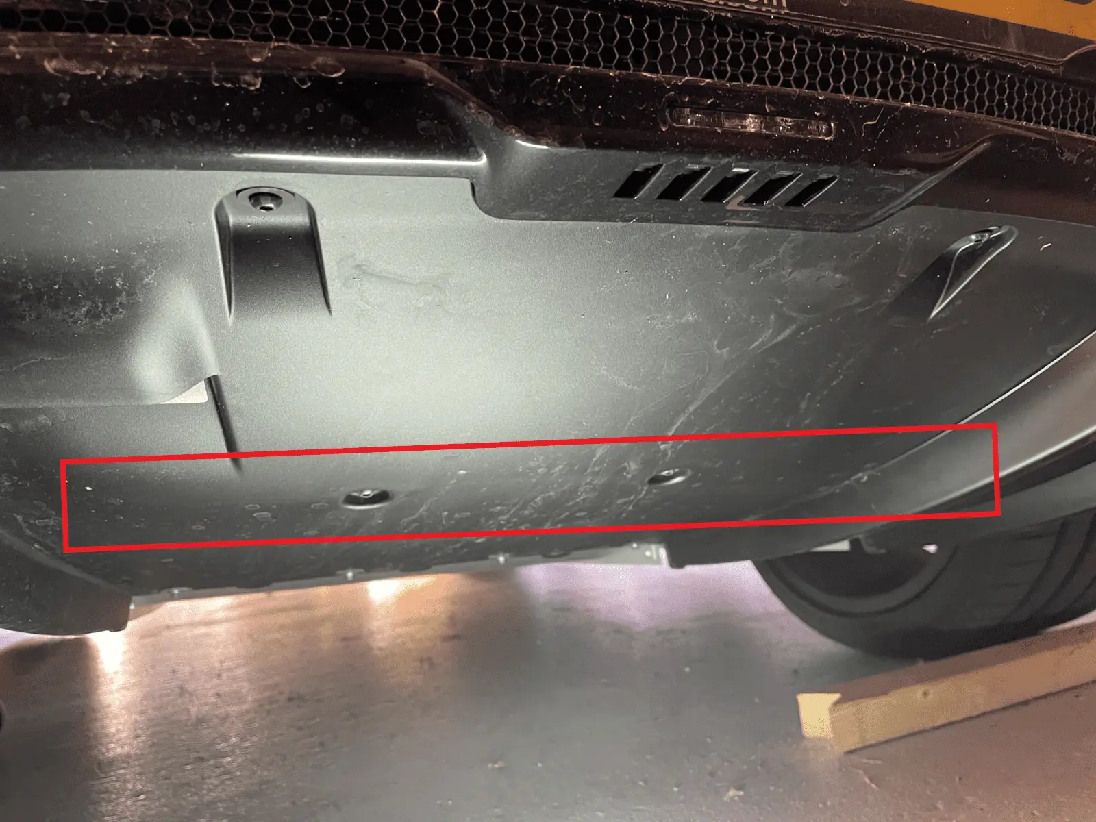

It was a bit of a faff getting the undertray/diffuser off but for anyone doing this themselves you only have to remove the outer bolts/screws. There is a horizontal reinforcement bar in the middle which does not require removal and can stay on the undertray/diffuser - illustrated below:
There are also two very small metal clips which tie the diffuser to the inner wheel arch (both sides) which could easily be missed.

Hi everyone,

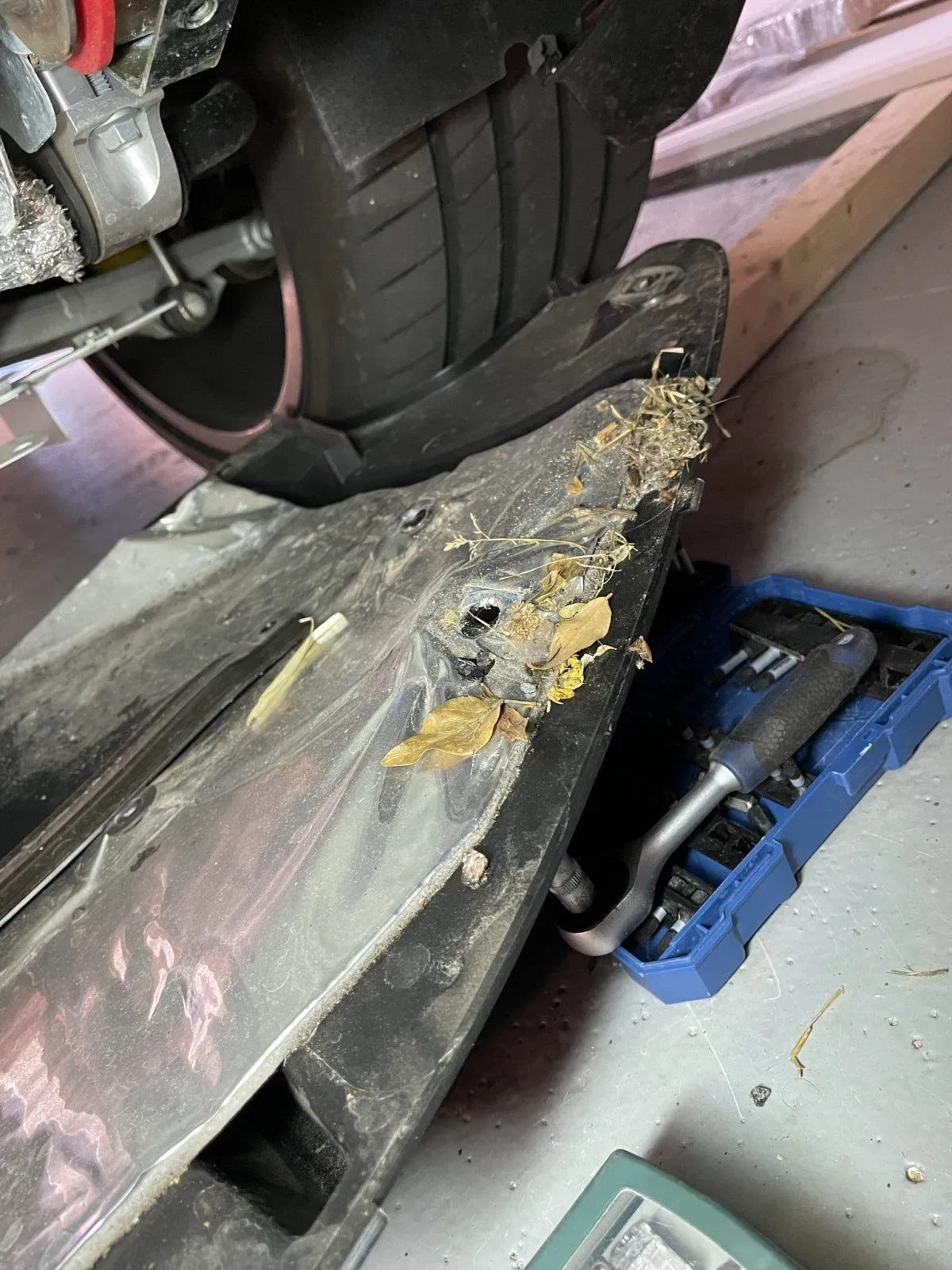

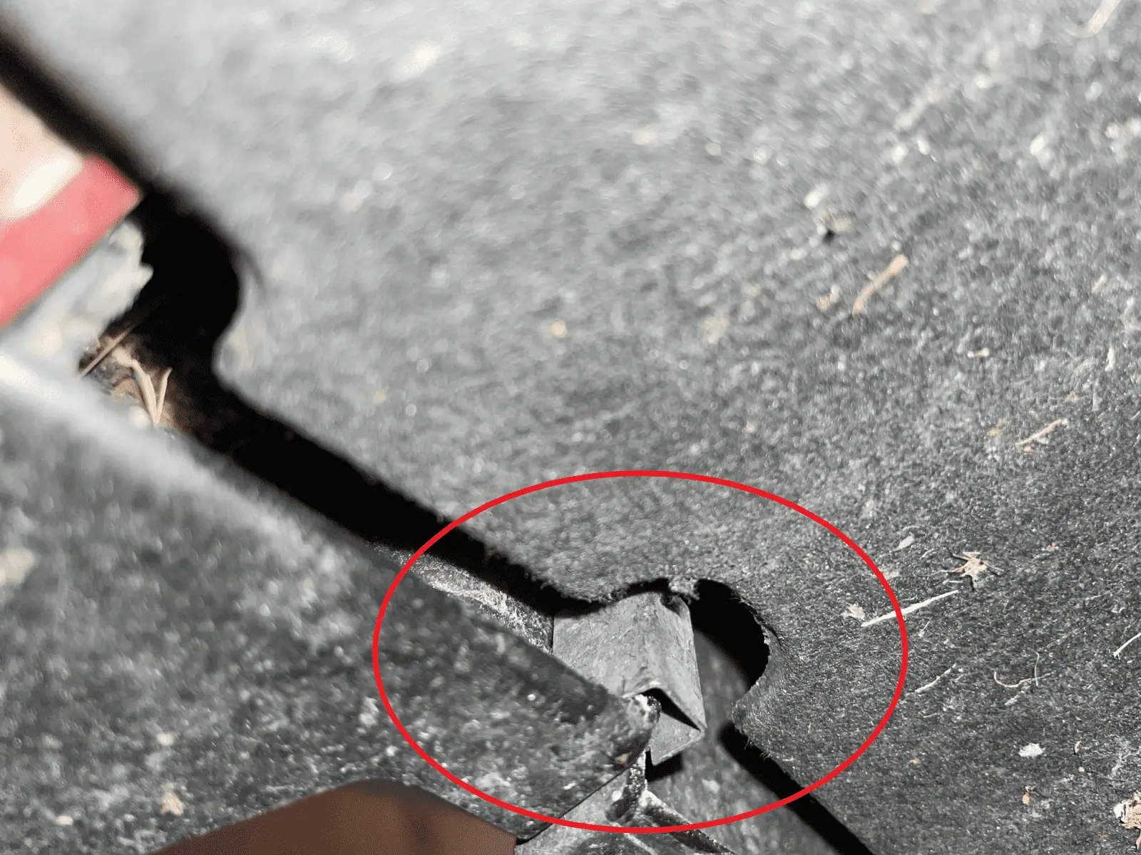

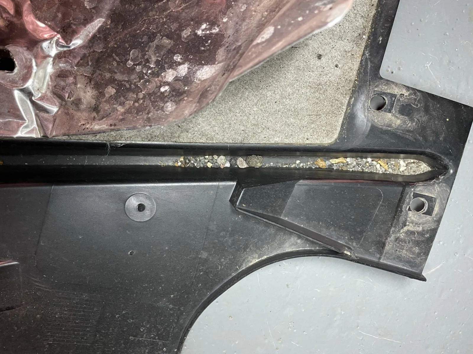

I also found my sound deadening has already started to come away after 1800 miles so ill bring it up with Lotus Centre and see what they say.

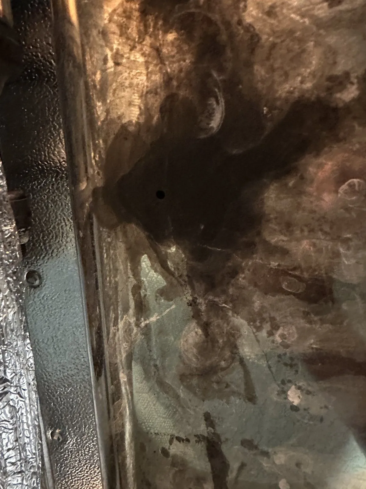

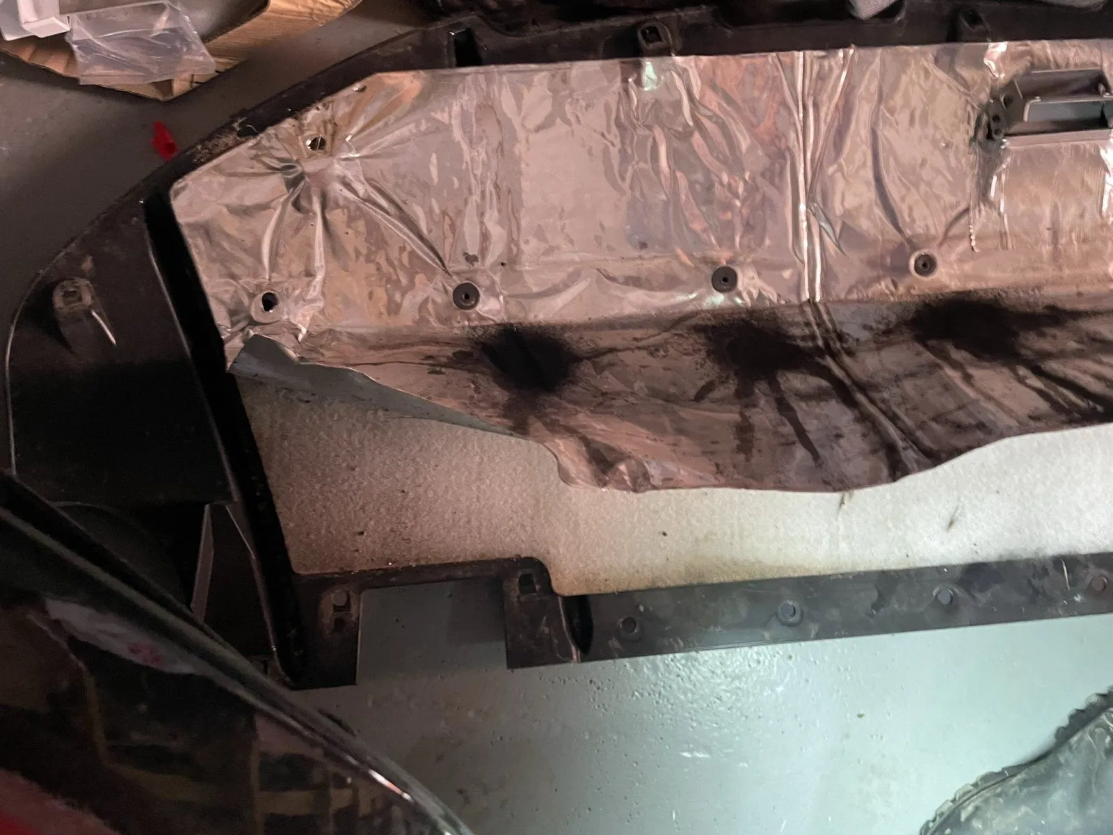

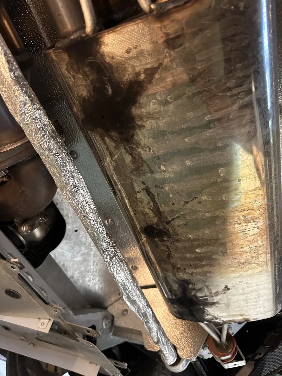

I’m currently working on my car and a quick observation I’ve noticed, there are 3 small holes in the exhaust which lead to the chalk (?) on the diffuser heat shield, I’m certain there is a reason but it is odd to me.
I think the holes are there to let condensation drain out of the exhaust. It does leave a bit of a mess inside the undertray.

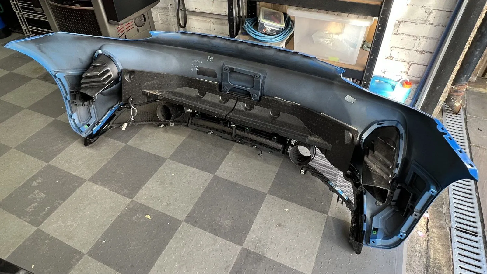

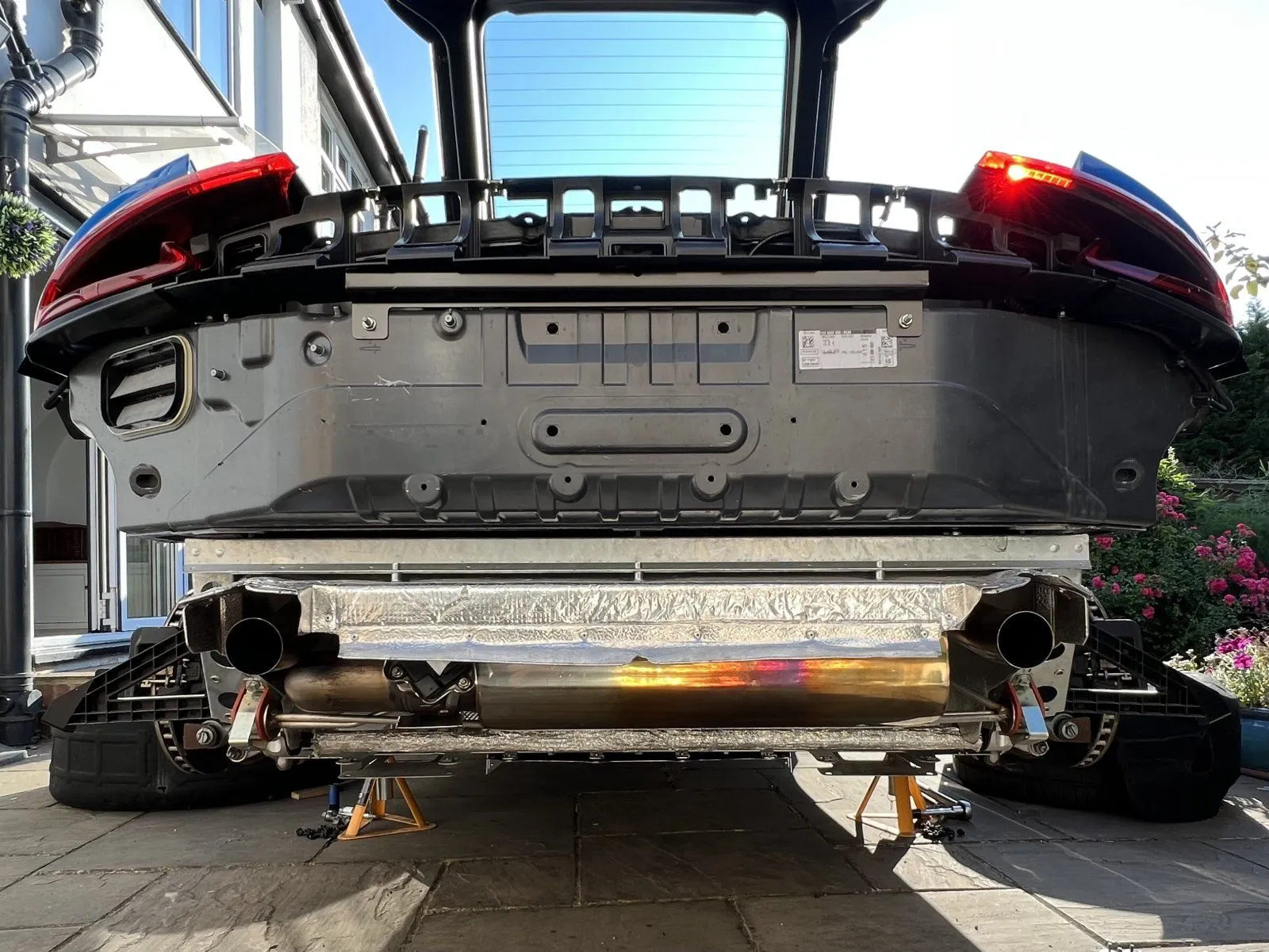

After a lot of swearing, giving up, head-scratching, more swearing, giving up again, I ended up with this:
Not as scary as it might look.
Wheel arches out, brake light off, 4 bolts in the boot, undo connectors, and it lifts right off.
Then the whole silencer/cat assembly comes out easily to separate off the car.
From videos I think I’ve seen of the factory, the bumper goes on after the exhaust so it’s only a problem afterwards.
This is how I got it done on my own but ymmv.
View attachment 31569View attachment 31570
