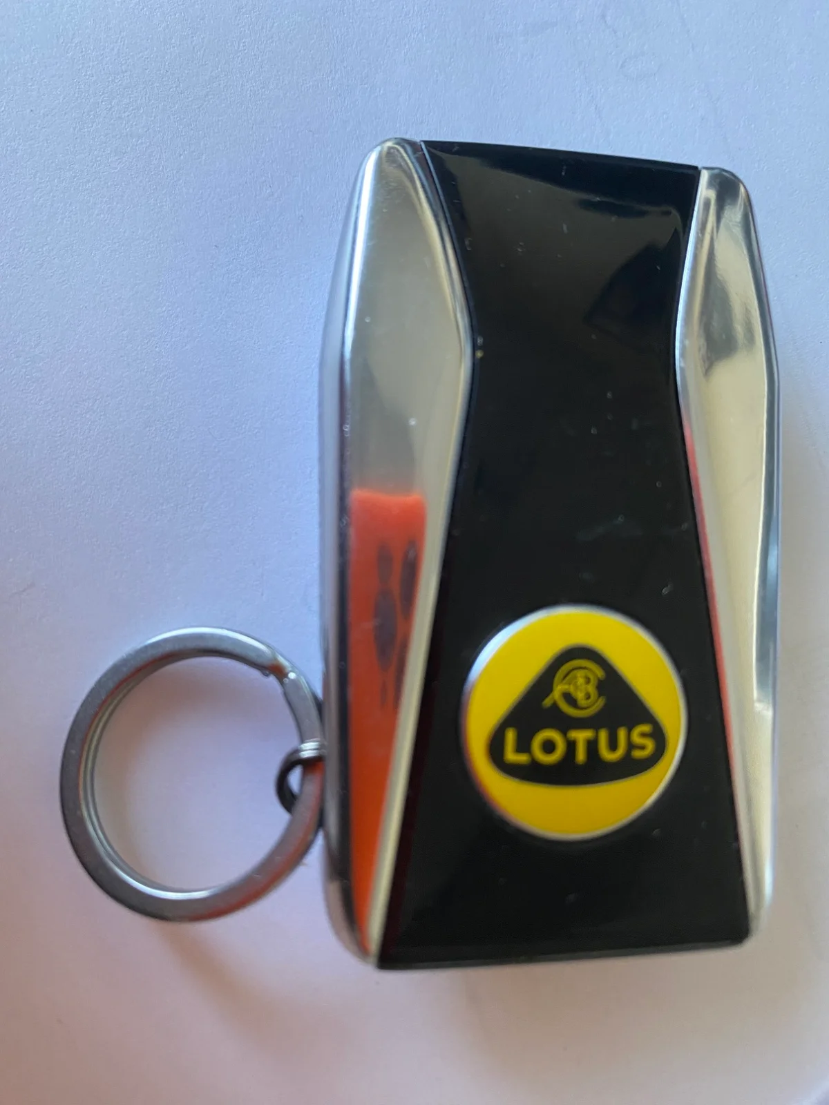

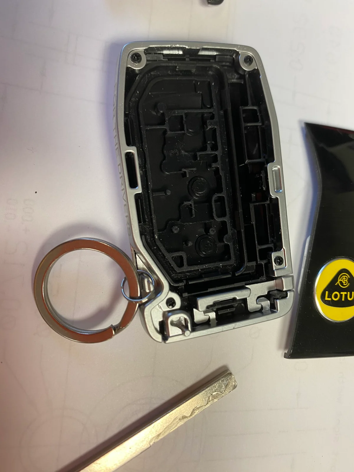

The key fob for the Emira has a very small window that you cannot thread a key ring through. Any small ring that would fit will get bent. So I experimented with different sizes and combinations of rings, and came up with a paired small-large ring that both fit the fob, and also allow me to attach other keys. It does require disassembling the fob, but that seems pretty easy, as it is just pops open by twisting the emergency key when it is half-way inserted. Anyhow, I bought packs of the rings, so if anyone in the US wants to send me $5, I'll send you two pair (assuming these go through the USPS sorting machines). I'll dig into postage to the UK and update.
