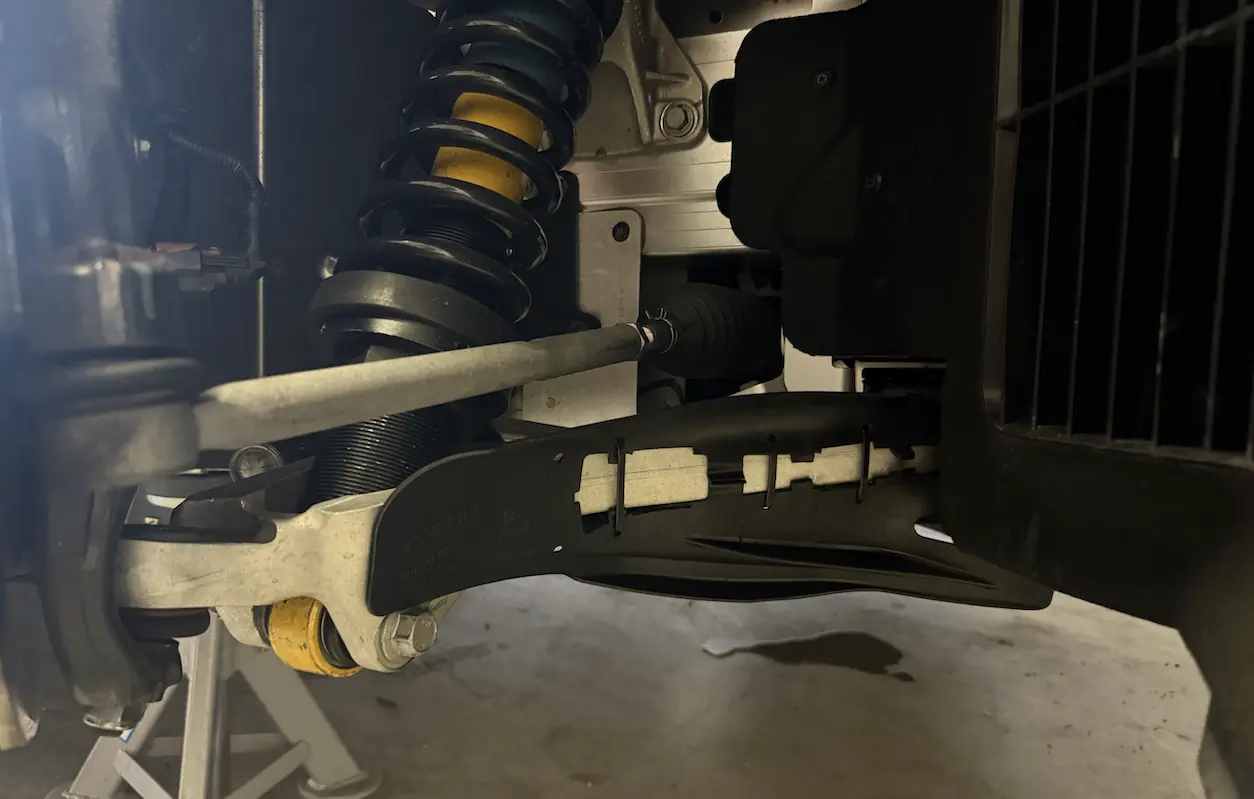

Note this image just shows a temporary mockup and not the final zip tie positions. Reference below for the guide of where to zip tie and cut.
Turns out the 997 GT3 brake ducts fit really well on the Emira control arms and hang down the perfect amount to scoop air and redirect it into the center of the brake brake rotor to pump the air out. The nice part is this mod should only cost you about $50.

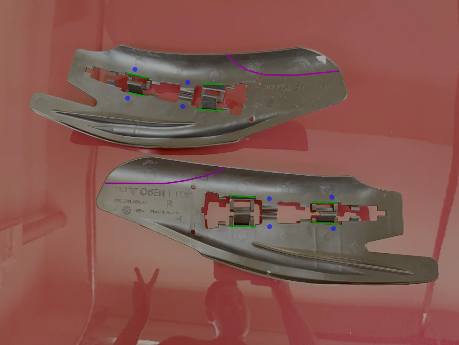

Prepping 997 Brake Ducts
  1. Trim the tie rod clearance area as pictured. (Purple)
  2. Trim the four protruding arms as pictured. (Green)
  3. Drill the four extra holes with the 3/16” drill bit as pictured. (Blue)

  1. Lift the car up, removing the front wheels is not necessary so long as you can turn your steering wheel for each side but it helps for access.
  2. Position the brake duct and make sure the V shaped notch sits close to the underbody aluminum panel.
  3. Use thread the steel zip ties through the holes and around the lower control arm and loosely fit the brake duct.
  4. Adjust as the brake duct position as needed and then tighten them down and cut off the excess zip tie with the cutter.
Some ideas for improvement:
- The green cuts may not be needed as they could fit the arms into the cutaways in the control arms, someone can experiment with that.
- The tie rod cutout could be optimized to remove less material and more of a U shape so less cutting can be done.
