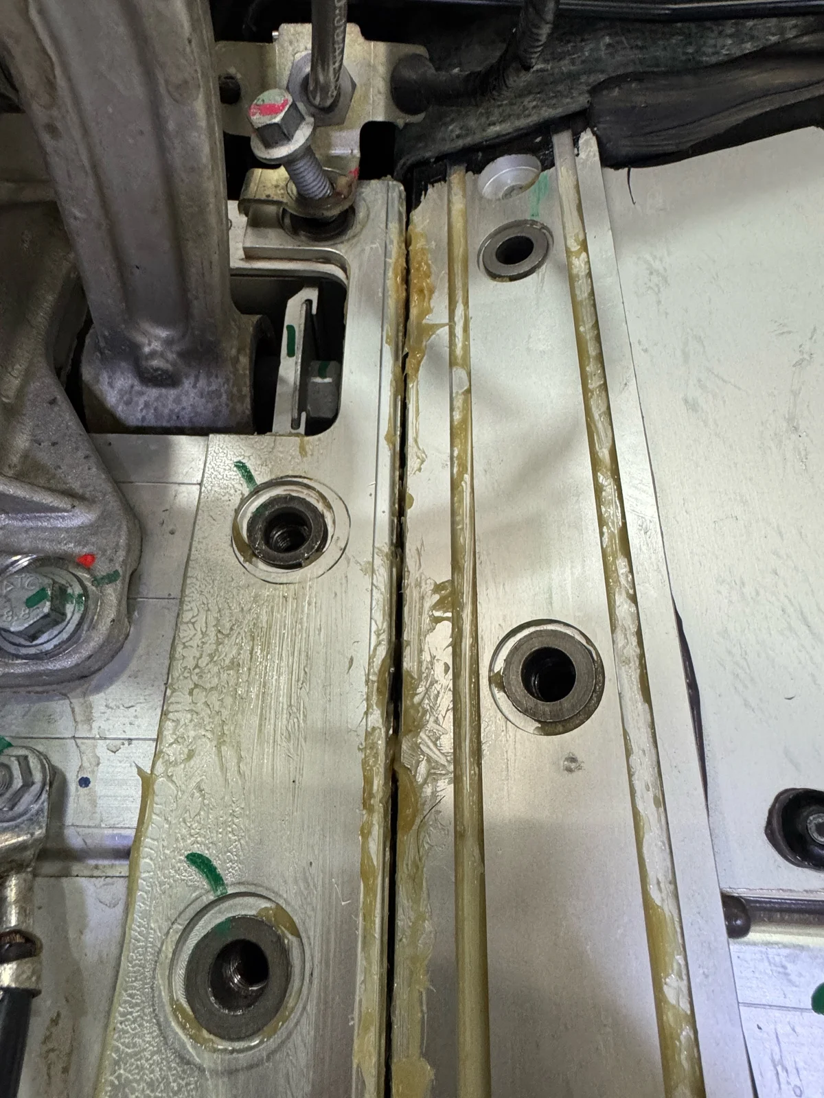

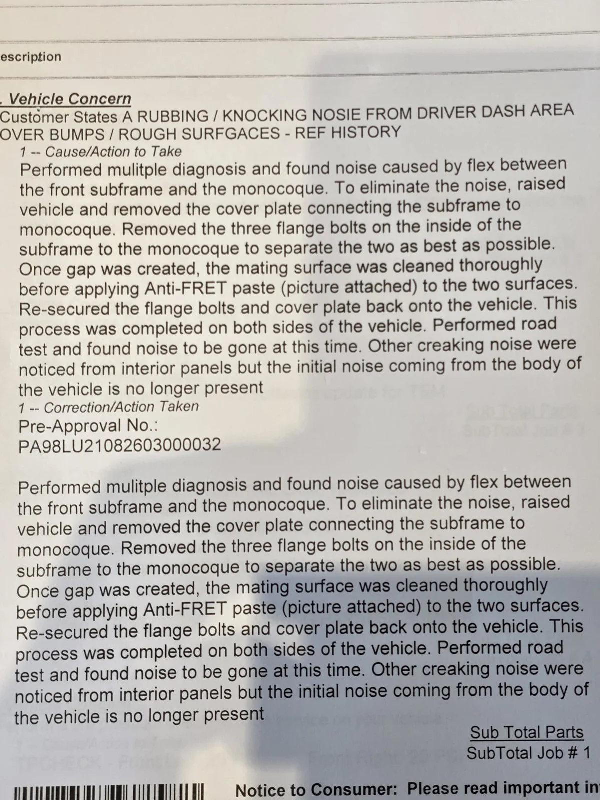

There have been many threads around this nebulous issue but I am starting a fresh one with the fix that worked on my car from the dealer, and this is the second car that has been fixed with this approach. The first a tech in New Jersey shared his approach with my tech at Galpin in Los Angeles.
The sound gradually got louder, and was basically an underdash creaking sound that could have been metal on plastic, plastic on plastic, metal on metal...etc. It sounded like it was originating directly in front of me under the dash, literally a dash creak. Everything was looked at from my Nitrons to the suspension mounts, a new steering rack assembly was ordered and installed. Nothing worked. Then since the techs all talk with each other this one in NJ said he solved it by cleaning the surfaces between the monocoque and front subframe, removing a bolt and voila fixed.
I just returned from picking mine up using the same approach and I can confirm the dash/under dash/subframe creaking sounds have all gone away. Details on what he did attached in photo from the print out. David is my tech at Galpin...awesome guy, knows the cars inside and out now.
I’ve had the same creaking myself, it’s pretty bad on bumpy roads. I showed this information to Lotus in my city and demonstrated the issue. They followed the procedure and I am very happy to report it has solved the creaking I was experiencing. This is absolutely the main source of these issues and it is fixed (for now at least).

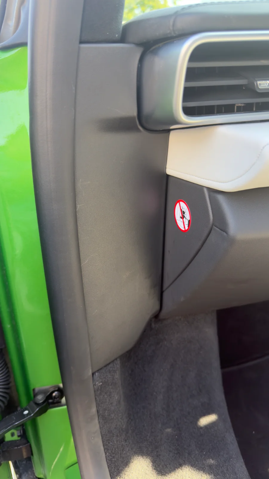

I had similar and fixed it by spraying some penetrating oil in the dash. Open the doors and remove the plastic panel for the dash beside the door seal. You’ll be able to see inside the dash and also see rivets holding parts together. I sprayed those and it seems to have solved this issue.

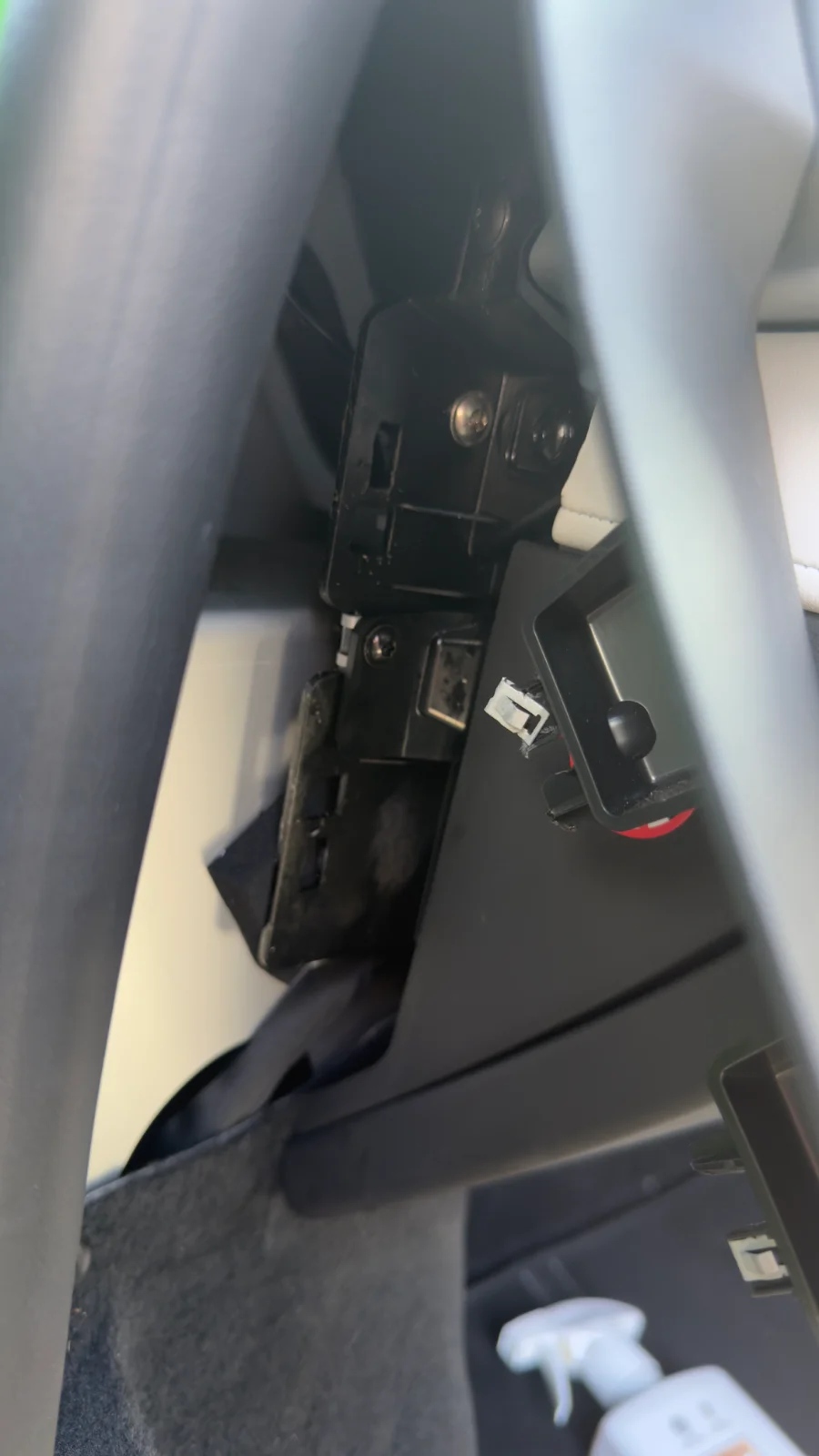

I when and removed that panel on the left hand side, there’s just a blank plastic panel behind this with a few screws and the left and behind it there’s those rivets. Do you mean spray all of this including the rivets or just the rivets?
I hope that remedies your problem as some of these creaks are coming from a lot deeper place than that.

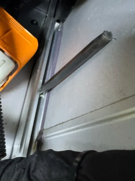

Just rivets that fasten the aluminium. Not the plastic parts. I'll try to get a pic in the next few days. You need to use a straw to reach further inside. Don't think there's any rubber on those parts to degrade.
