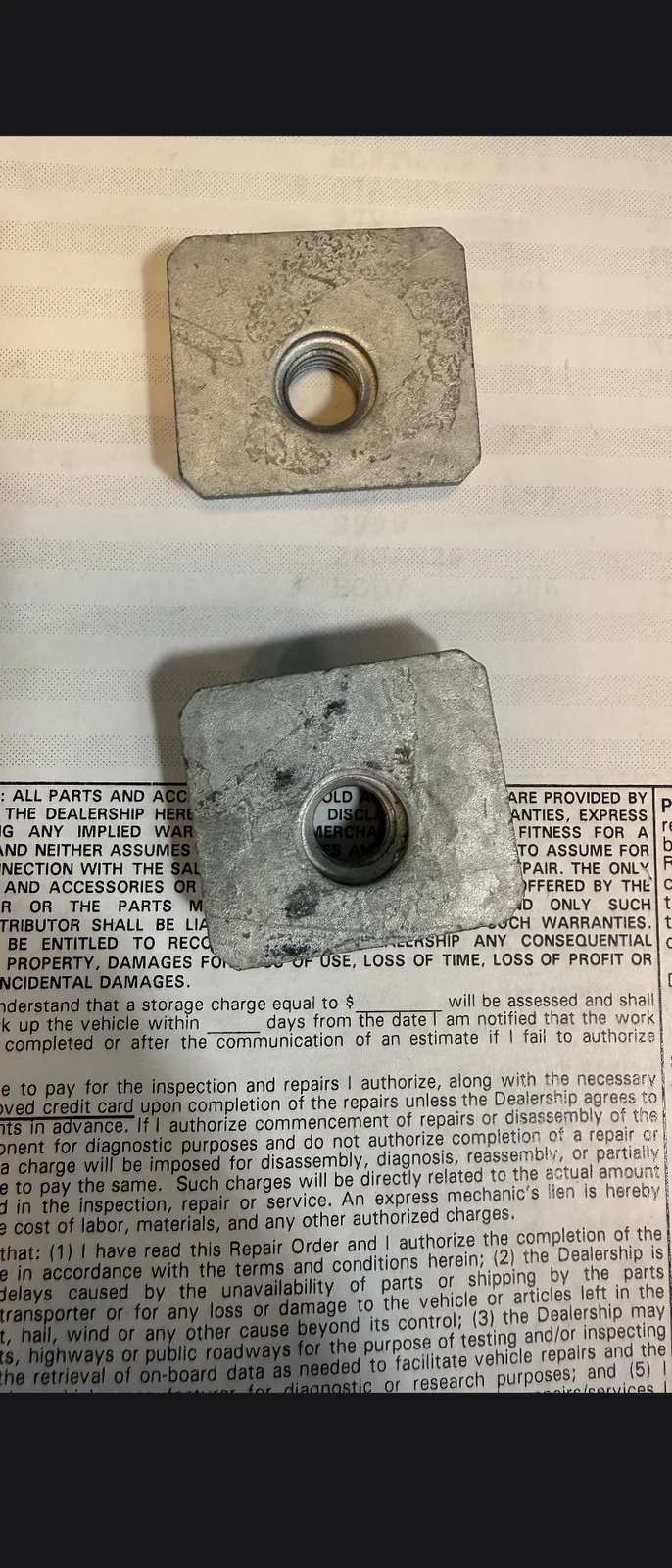

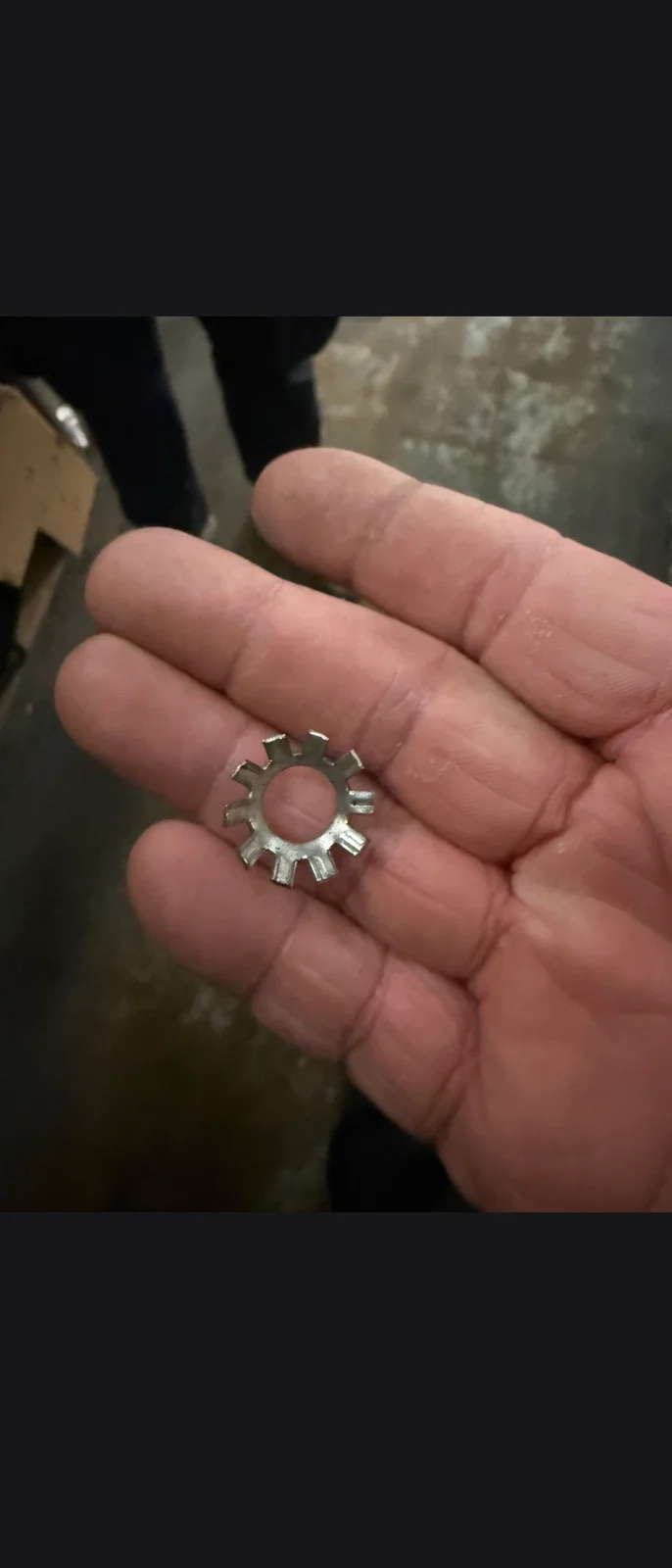

One remaining category of creaks in my car still sounds like plastic creaking on each other. My tech, through the help of another tech in Jersey located the sound from the steering bracket and these threaded inserts, by using chassis ears.
They are to be replaced with these instead to resolve the noises (which were confirmed by the Jersey tech to work).
Those are going in on my next visit...there is a new rear light harness bulletin (this would be the 2nd one that replaced the original harness update) so when he gets those in stock he'll swap out those fittings.
The other categories of sounds are all gone as my original post explained -
Had subframe and steering bracket threaded inserts replaced. Was quiet for about a week. Now a light tapping (Morse code) on some bumps.....not bringing it back

Could you elaborate on where exactly these parts are located on the steering rack? Also, not really following how the star washers fit into this and how they will help?
@Kaz Thanks for the additional info, it’s all been super useful 🫡 (y)
you're asking the same questions I have lol...I wasn't there when the car was apart just relaying the info my tech gave me
