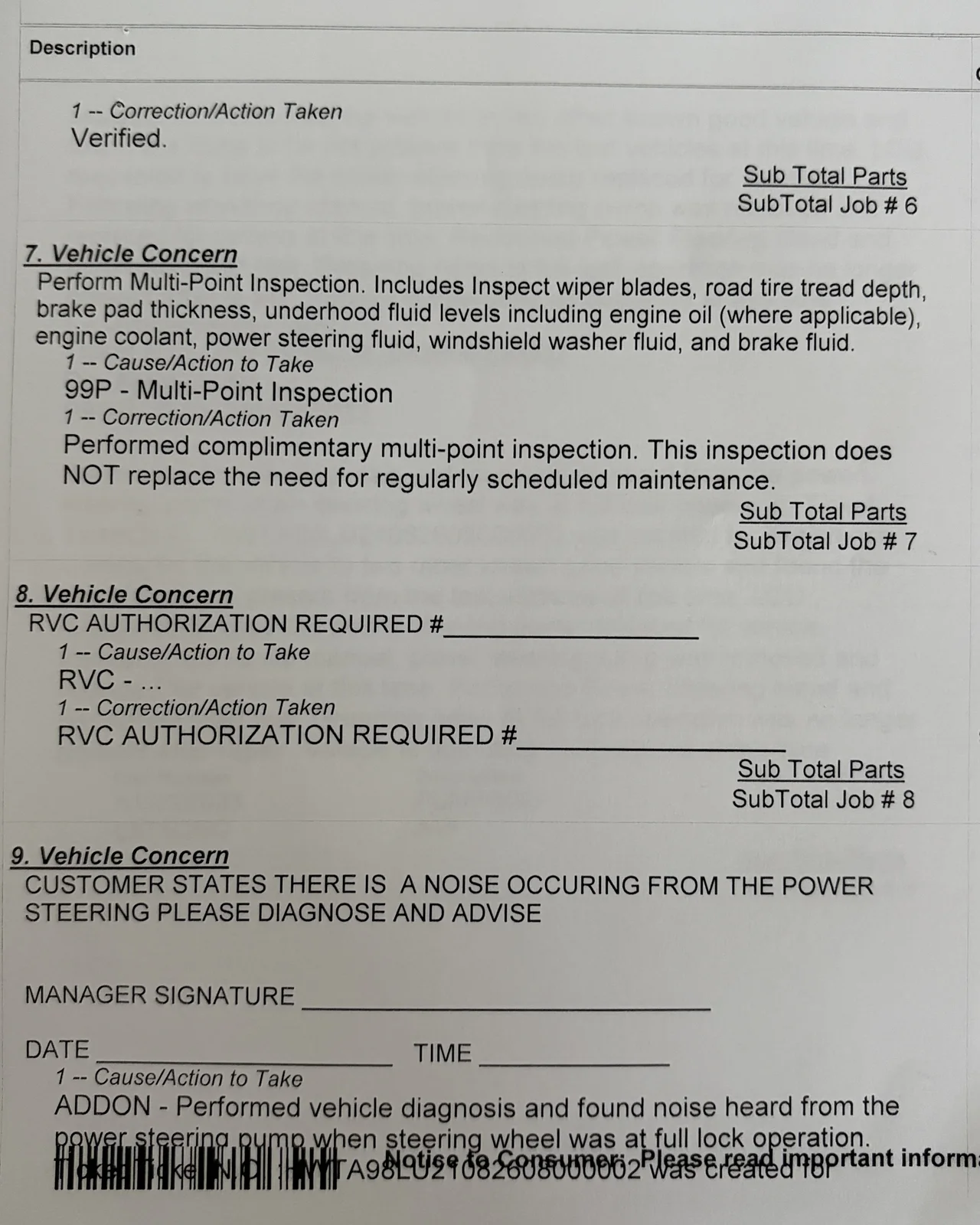

So finally received the car back today from Galpin after 2.5 weeks because they were waiting for parts to come in.
Sat with David for a while and chatted about what he did, his experience with mine and others like Kaz's Emira, and just some other stuff. Cool dude and fantastic service from Galpin.
I'll attach everything he performed.

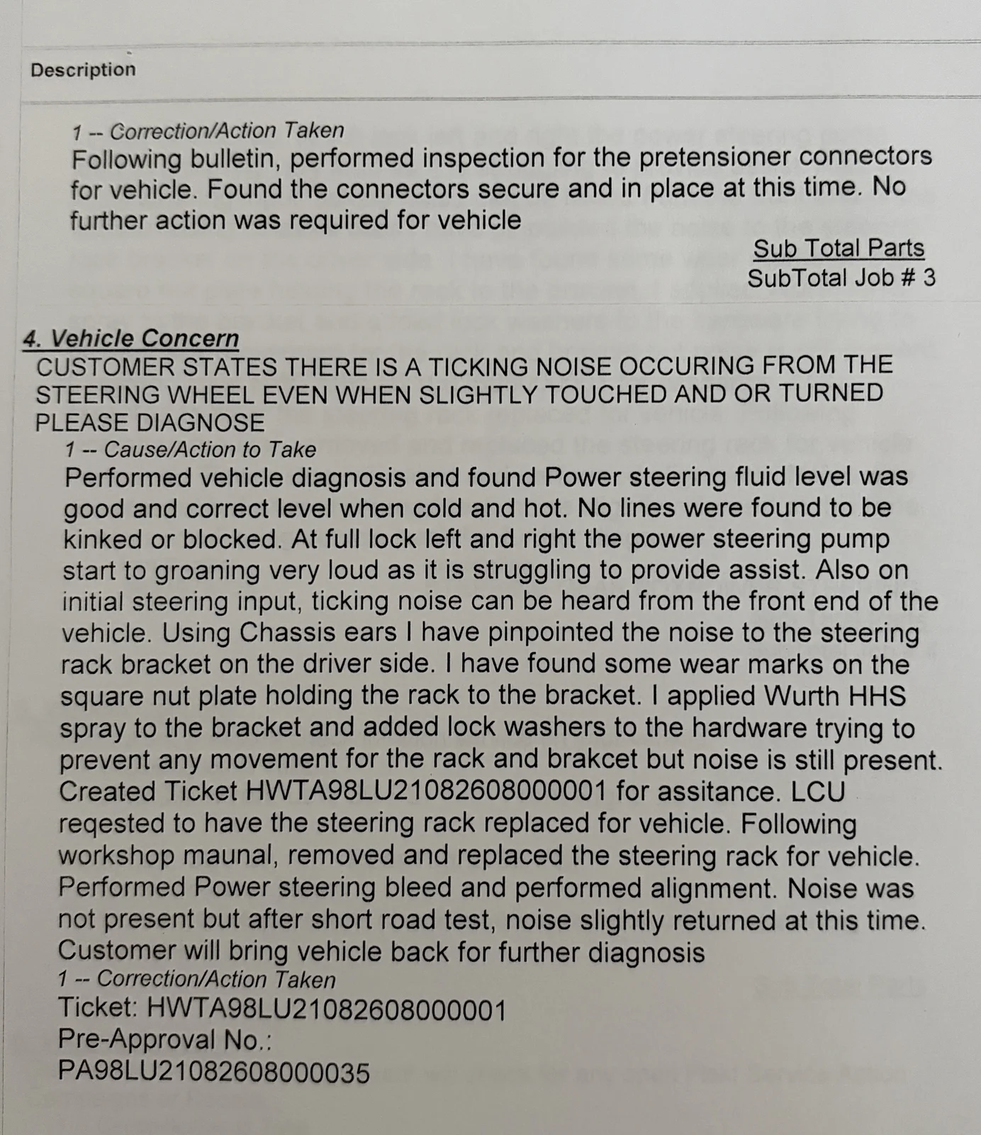

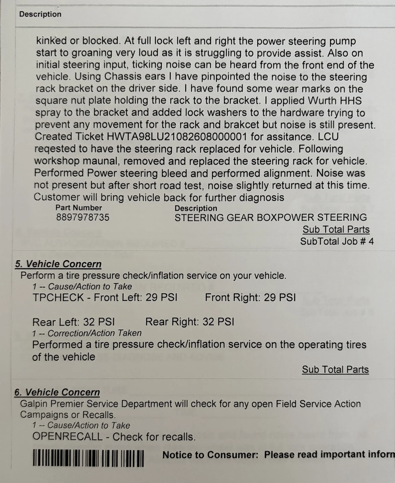

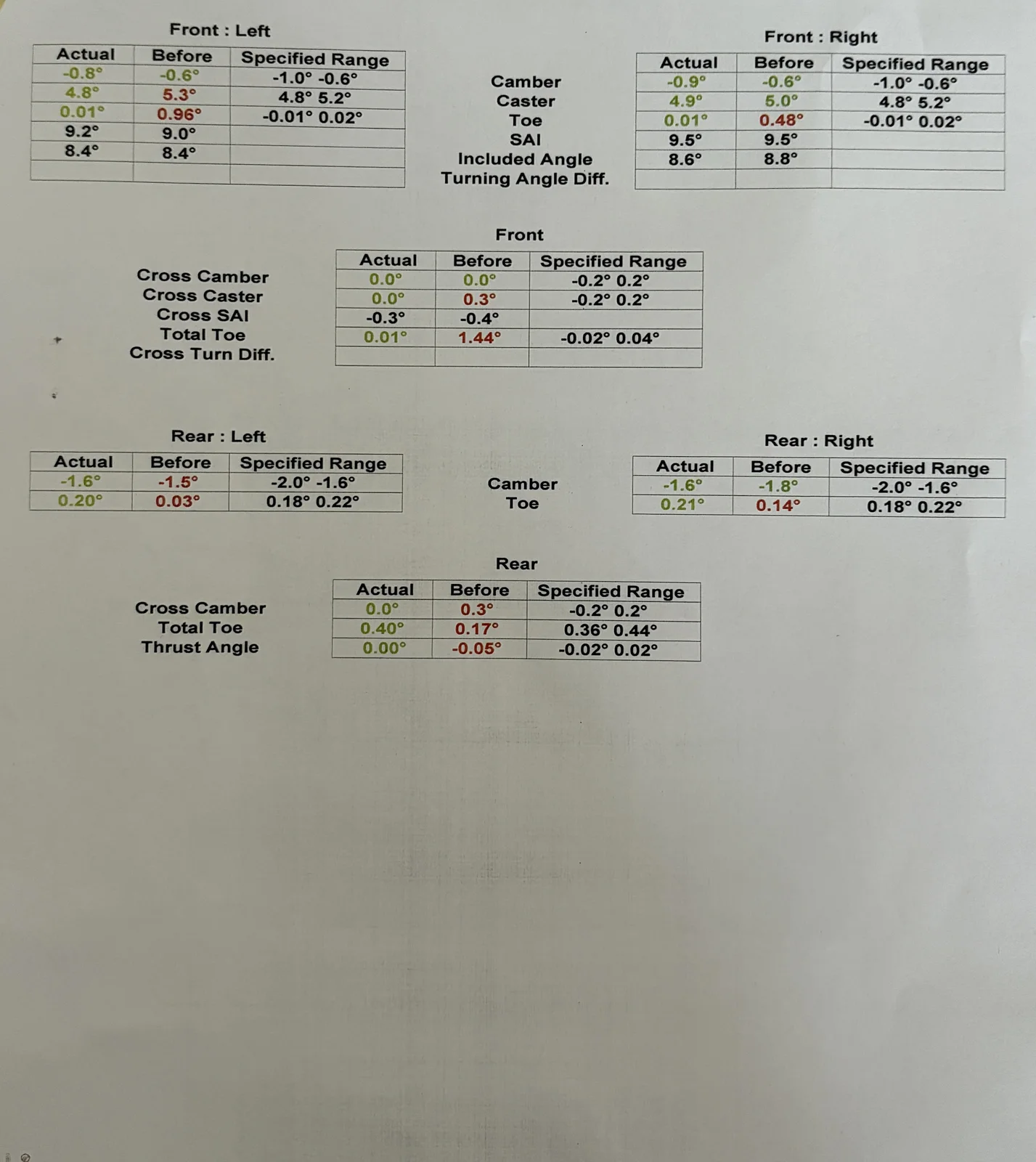

  • Happy to say, I can't hear the noises when I drove it home, even though David said he can still hear a small ticking noise when turning the steering wheel that's coming from the rack mounts with the chassis ears. I personally could not hear it driving home and turning every which way in the parking lot at slow speeds. Whereas before, the ticking was very pronounced to me. The wheel felt a bit lighter and smoother too which was a plus (wasn't fighting it anymore). For now, that problem is solved. Time will tell if the ticking comes back.
    • What he replaced were the lock washers, lubed certain areas and replaced the steering rack.
    • He then performed an alignment as well. Specs shown below.

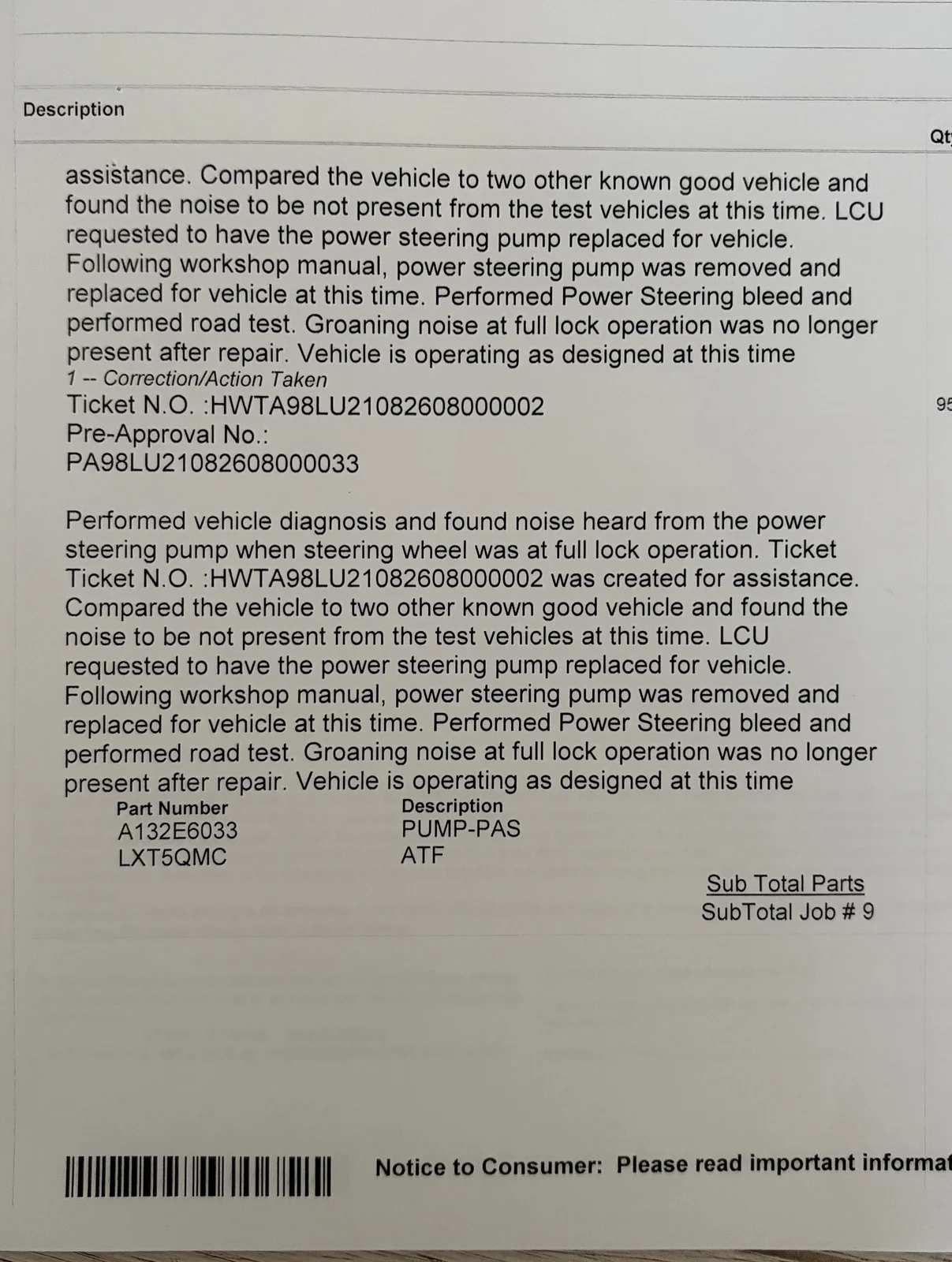

  • As for the power steering groans when turning the wheels at slow or stopped speeds, the noise is completely gone now. No more groaning.
    • He replaced the power steering pump

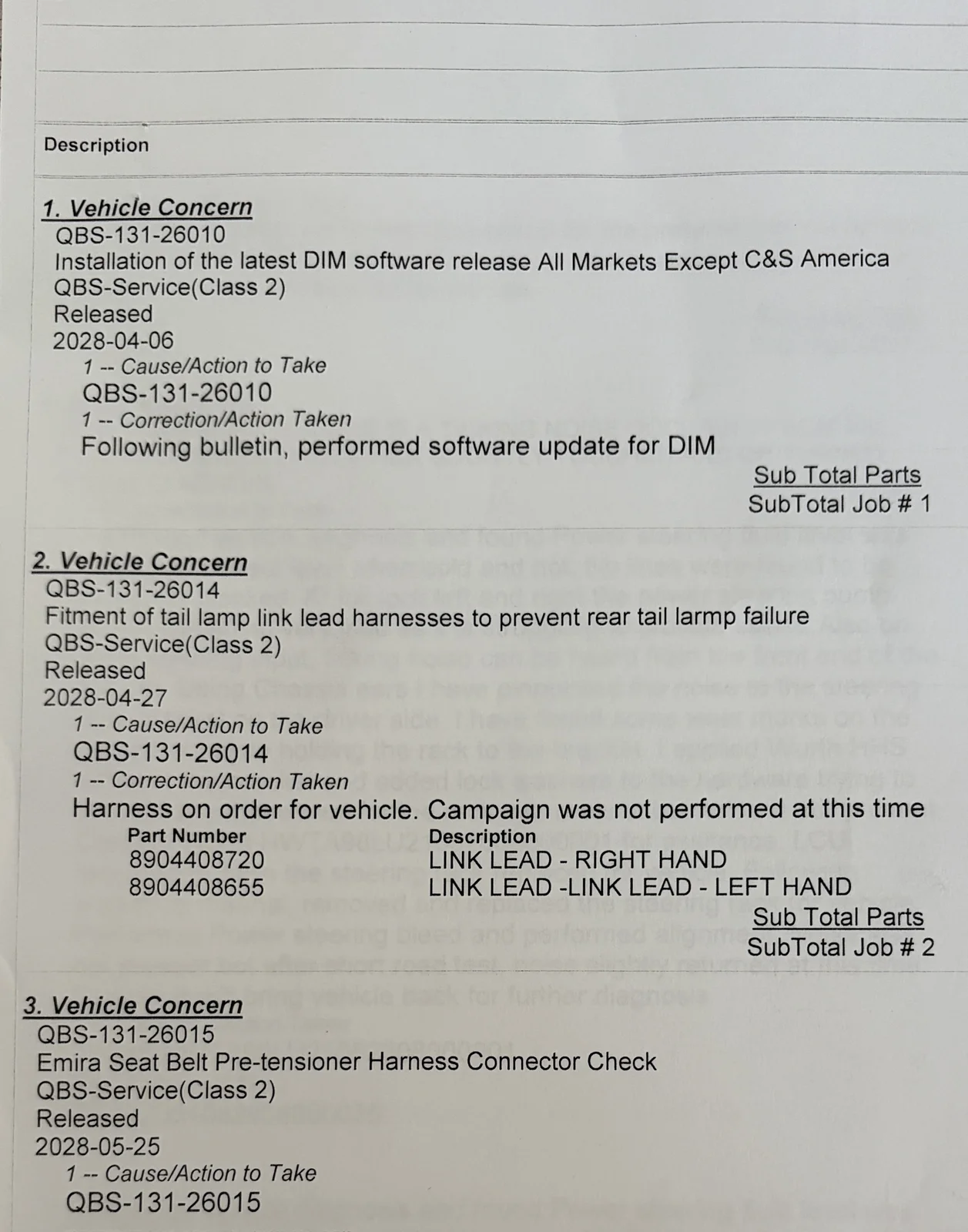

  • He performed the software updates shown in the attachment and checked some other stuff...
  • The taillight harnesses are still on order so Galpin will let me know when they arrive and I'll bring it back and they'll perform it then.

One remaining category of creaks in my car still sounds like plastic creaking on each other. My tech, through the help of another tech in Jersey located the sound from the steering bracket and these threaded inserts, by using chassis ears.
They are to be replaced with these instead to resolve the noises (which were confirmed by the Jersey tech to work).

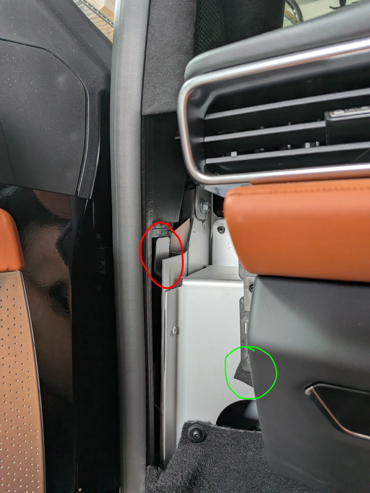

Anyone find out the location of these washers?
Look more to the left at the top of your image (Look towards the outside of the car from inside) where the composite is riveted and bonded the aluminium.
@Honcho, is the area circled in red where you added penetrating oil? I noticed that there is a foam insert between the composite and aluminum panels in the area circled in green. Maybe something similar is needed in other locations. Thanks.
Hey. That area might work but there are other parts higher up within that hole. Maybe best using a straw to get in there. Also extra work, but if you take off the pillar surround above it you will see holess in the composite around the tweeter area. I spayed in there too. ...so I am not sure exactly what part solved it but spraying a few things in those areas definitely did. This is referring to the constant ticking noise.

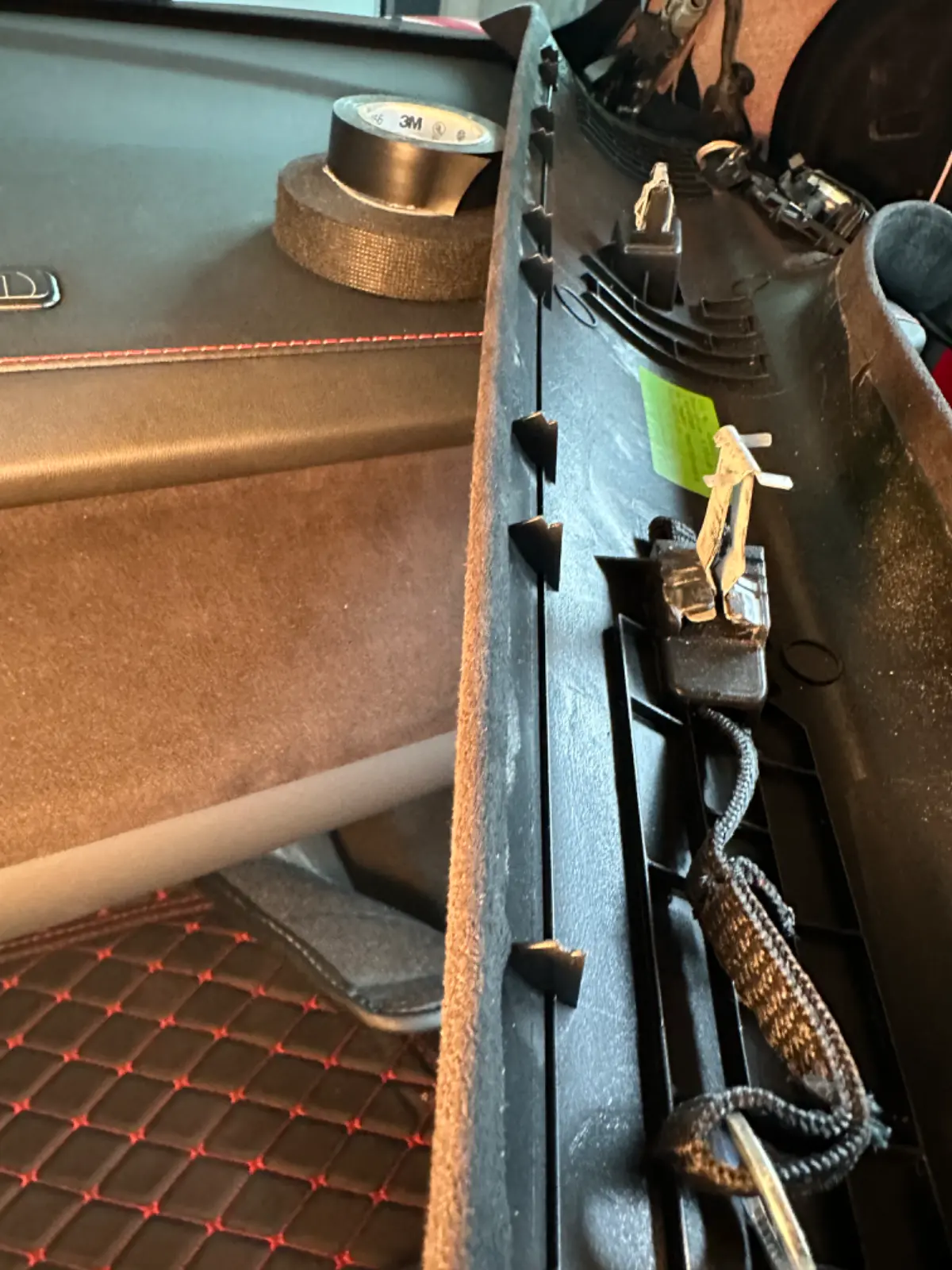

Thanks @Honcho. is there any trick to pulling off the pillar surround?
Thanks @Honcho. is there any trick to pulling off the pulse surround?
I found this image on the tweeter install part of the forum. There are clips at the top and bottom that should just pop off, but the middle one is more akward. Once you have popped off the top/bottom clips, I found it best to try to slide the metal clip out of the plastic holder on the trim with something like needle pliers instead of trying to pull it off the chassis pillar. You'll have airbag tethers holding the trims too, but you should not need to remove them.

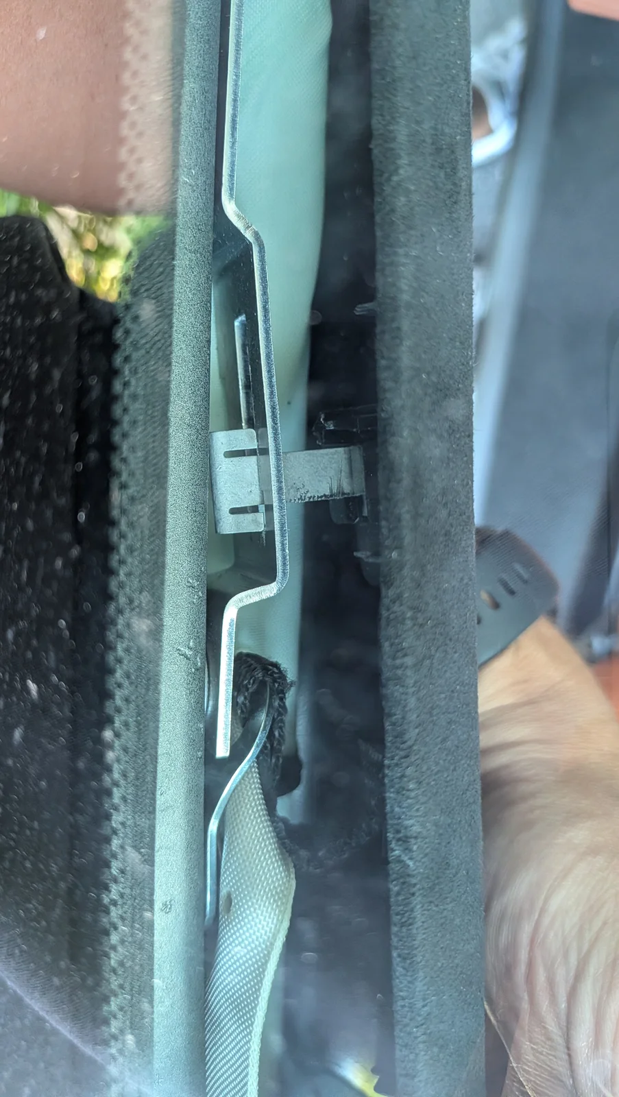

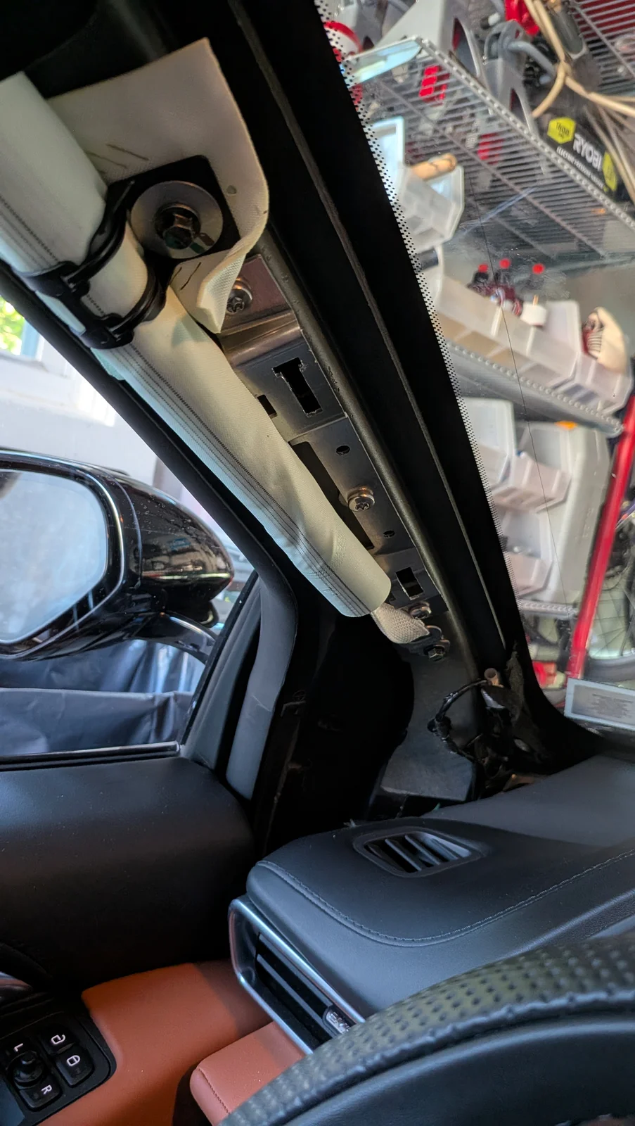

I was able to pull the pillar cover off by using a trim tool to depress the metal anchor clip from the windshield side (first picture). I struggled with it for a few minutes before finding this angle. Unfortunately, after a drive around town with the pillar totally uncovered (second picture) I don't hear the creaking sounds coming from this area. Please let me know if there are any other DIY suggestions before I reach out to my dealer about the dash creaking sounds.

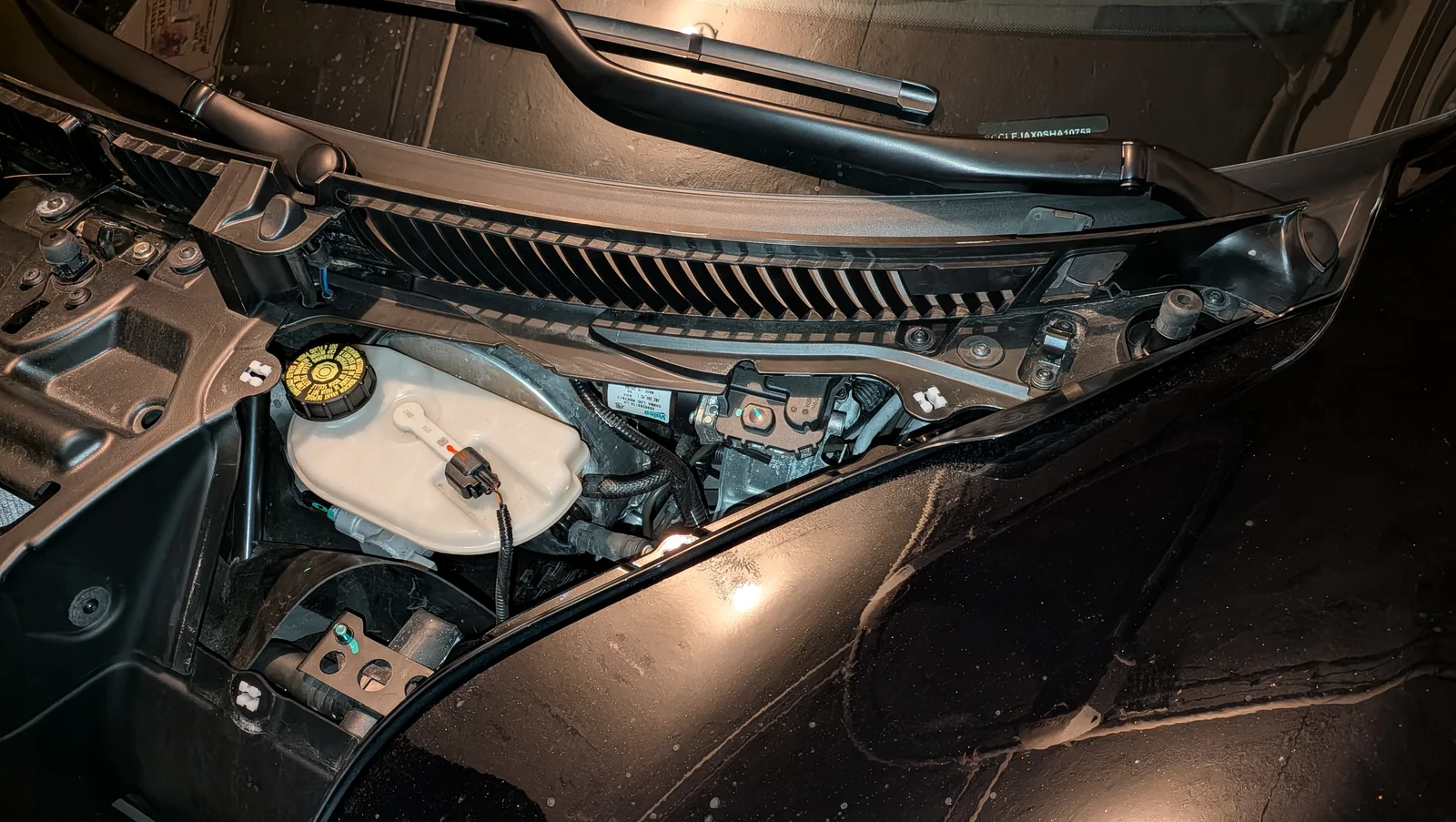

In case you haven't done it already, check the 3 bolts that hold down the front lid to ensure that they are tight. I recall reading a post by another member here who thought the noise was coming from the dash but ultimately he discovered it was transmitted in to the cabin from the front hood just because those bolts became loose. Worth a check.
Potential clue found: a few days ago I took a long drive in the rain and didn't hear any creaking. When it's not raining the creaking is consistent and constant. This seems to suggest it must be coming from something on the exterior of the car that is exposed to, and potentially lubricated by, the rain?
Today it was nice and dry so I took out the three bolts that hold down the hood. They were nice and tight before I removed them. Unfortunately, the creaking was still there during a slow drive around the block with the bolts out. Does anyone have any recommendations about what / where I might add lubricant to get the creaking to stop?
