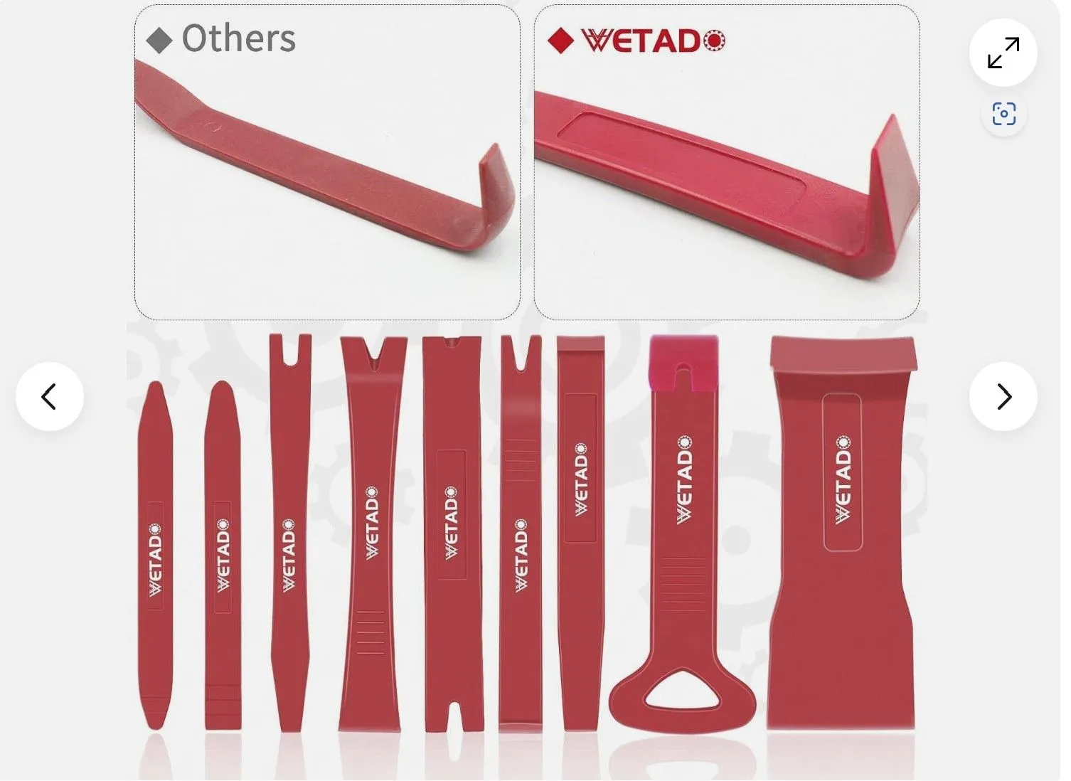

I did purchase a nice set of plastic trim removal tools, so as not to damage anything - I've included the kit in the pictures - £20 from Ebay.

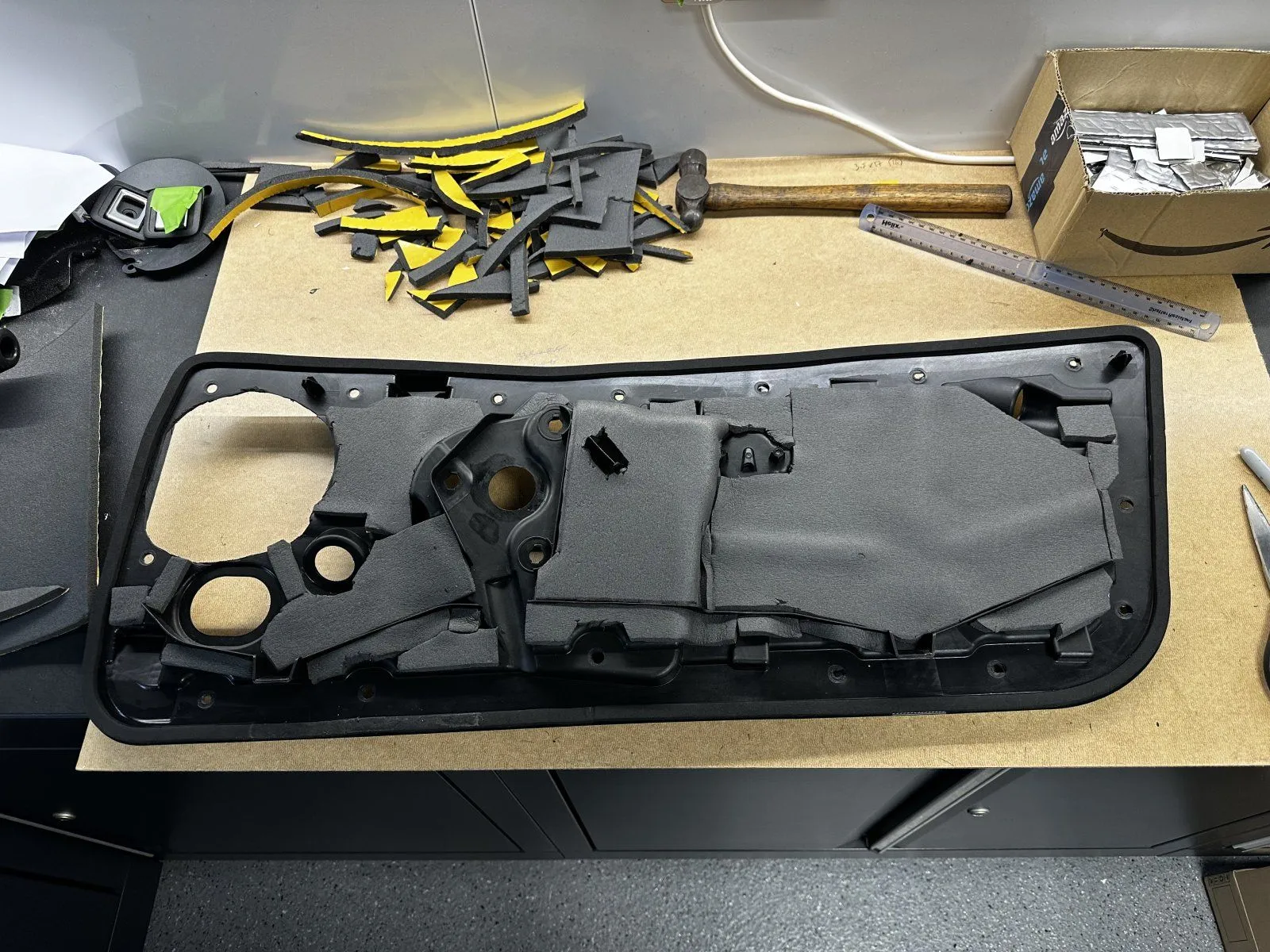

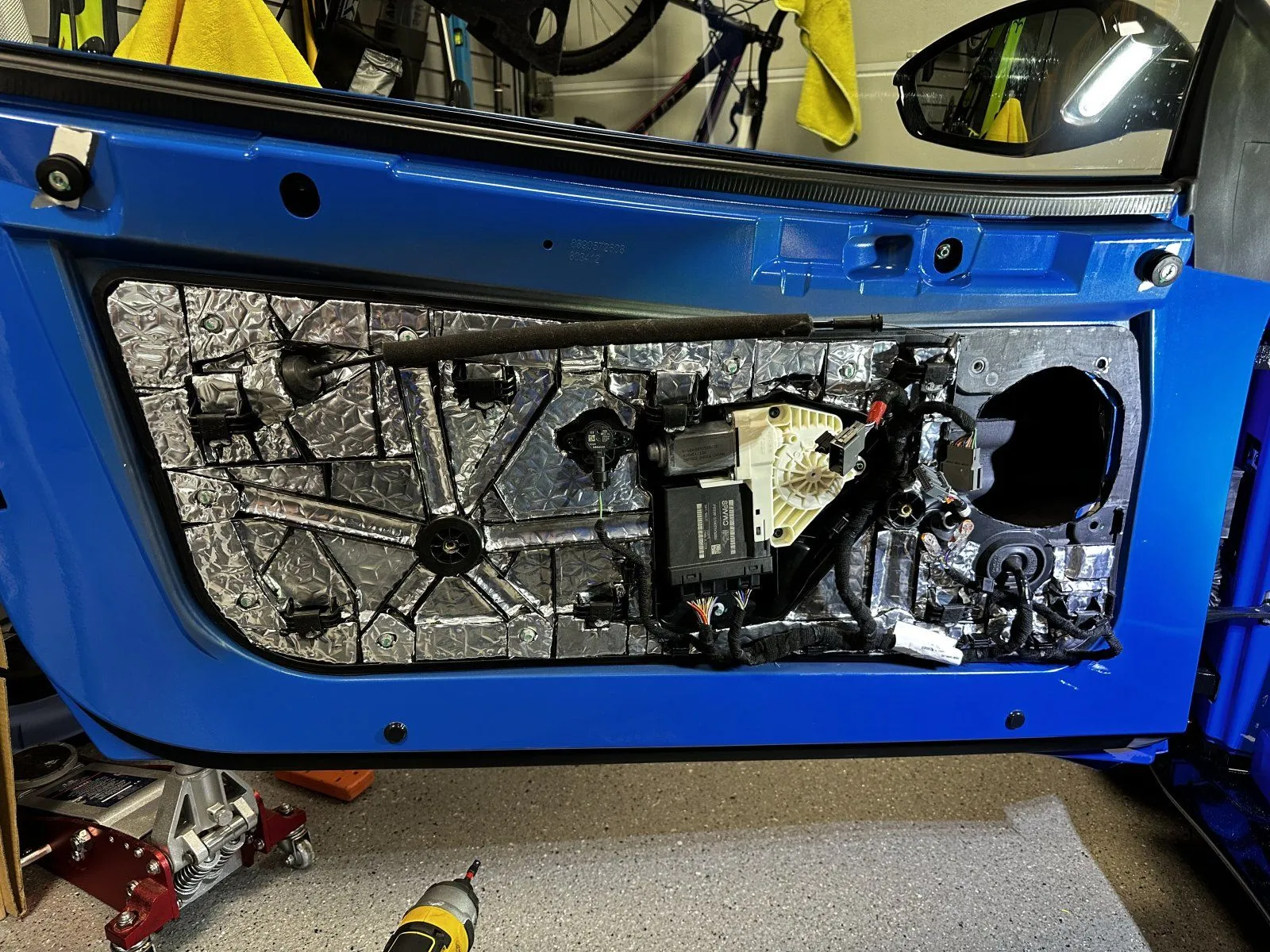

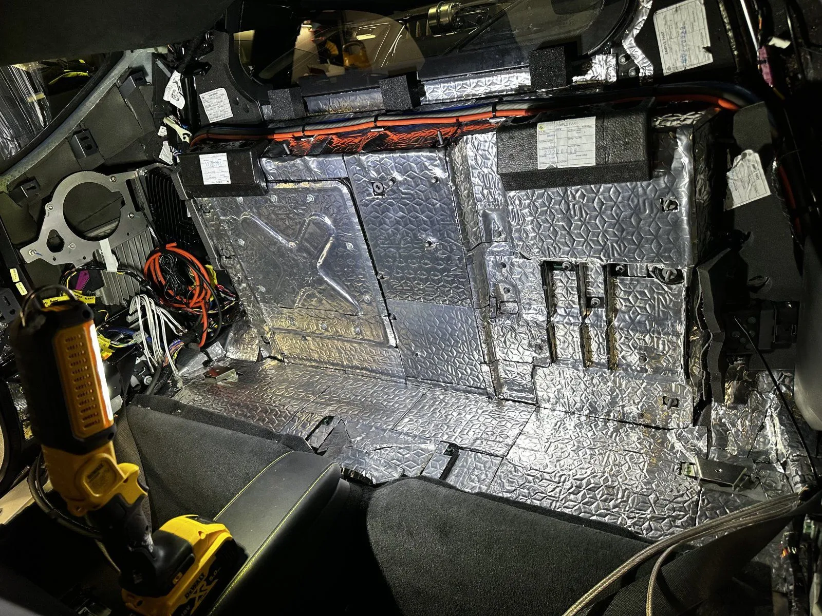

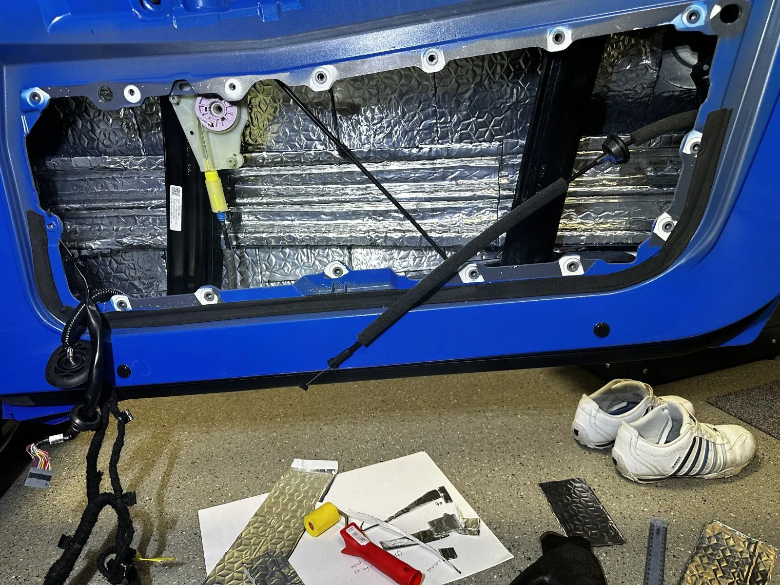

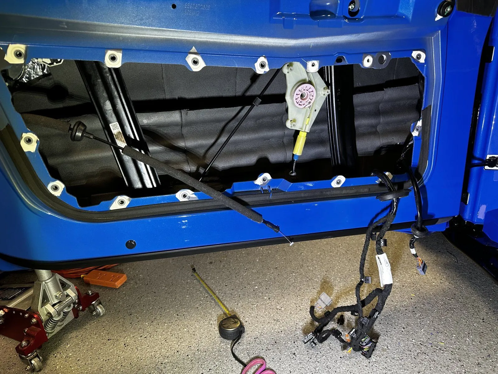

I used Skinz for sound deadening in the doors and the rear as shown in the photos attached. Then self adhesive acoustic foam over the top (only where the speakers will sound against).

Curious since you have door panel removed, can you tell if there are any access holes/bolts that can adjust the window tracks? Asking on behalf of some people here who are having wind noise issues on their windows. I know the window alignment can be a tad off causing some wind to leak in which is common on cars with frameless windows
Hi Raskits,
Yes, there are rubber bungs located on the underside of the doors, remove these to expose bolts which are securing the bottom of the window guide rail to the door. Should these bolts not provide the desired adjustment, then you'll need to remove the main door card (only x2 10mm bolts), then remove the window motor and unclip wiring harness etc, then finally unbolt the black plastic inner door card for ultimate access. It's also possible to adjust the doors on the catches mounted to the body of the car, I don't believe there is any adjustment for this on the door itself.
Unfortunately, I don't have any pictures of what I've described above, but I have seen the adjustment bolts and its straight forward, especially if & once the inner door card is removed.

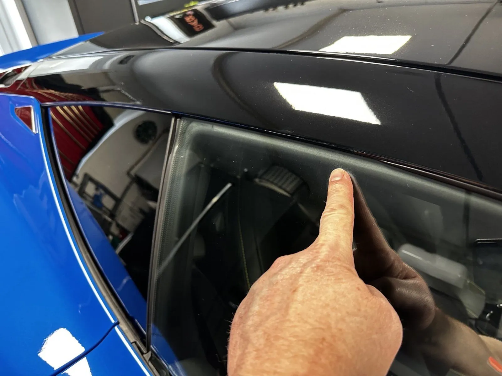

I've adjusted my windows & doors the best I can. I don't really get wind noise, however I do get a few drops of water onto the leather of the door card during washing.
I've had the complete driver's window rubber replaced under warranty because when I received the car this rubber was tucked up inside due to incorrect window adjustment - see attached pic.

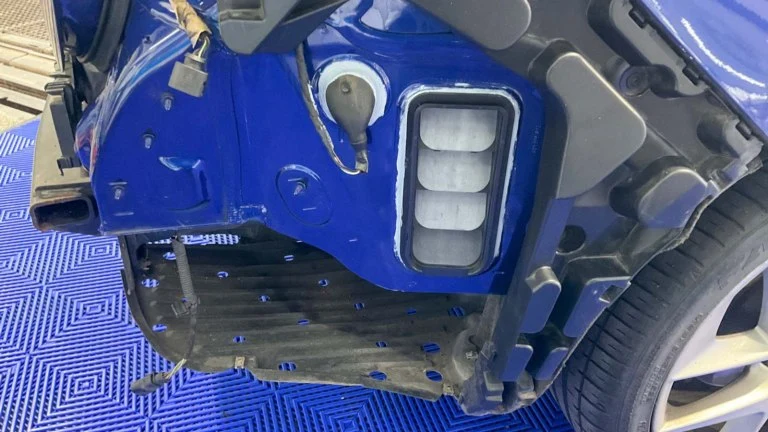

Not that I know of. I've attached an image of the type of vent that is in there. The vent flaps move with very little pressure and if you stop them from moving you're likely to stop fresh air getting into the cabin. I opened up access to the sub area and played bassy music, then figured out things from there. I can't remember exactly what I did but I may have put sound insulating foam between it and the sub (leaving a gap so as not to cover it) to stop the sound waves moving the flaps.
