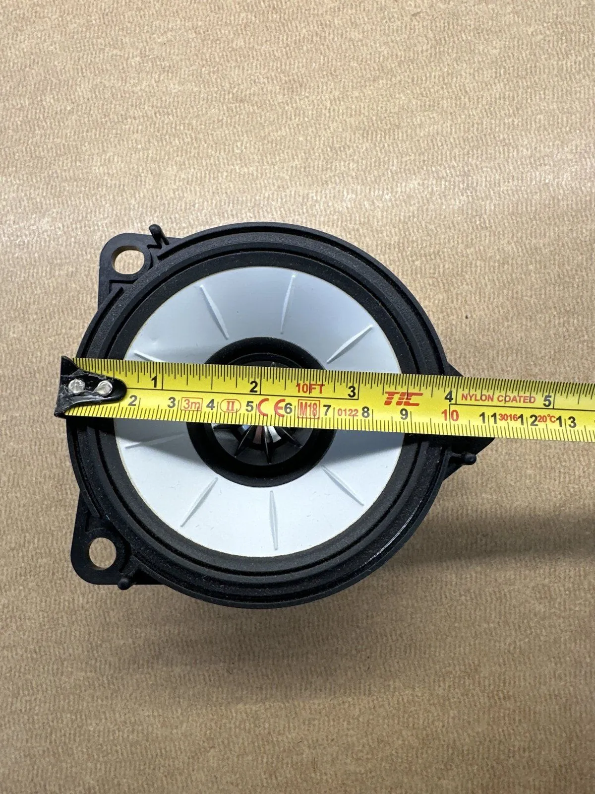

Do you mind placing a ruler across the KEF driver and showing us a photo?

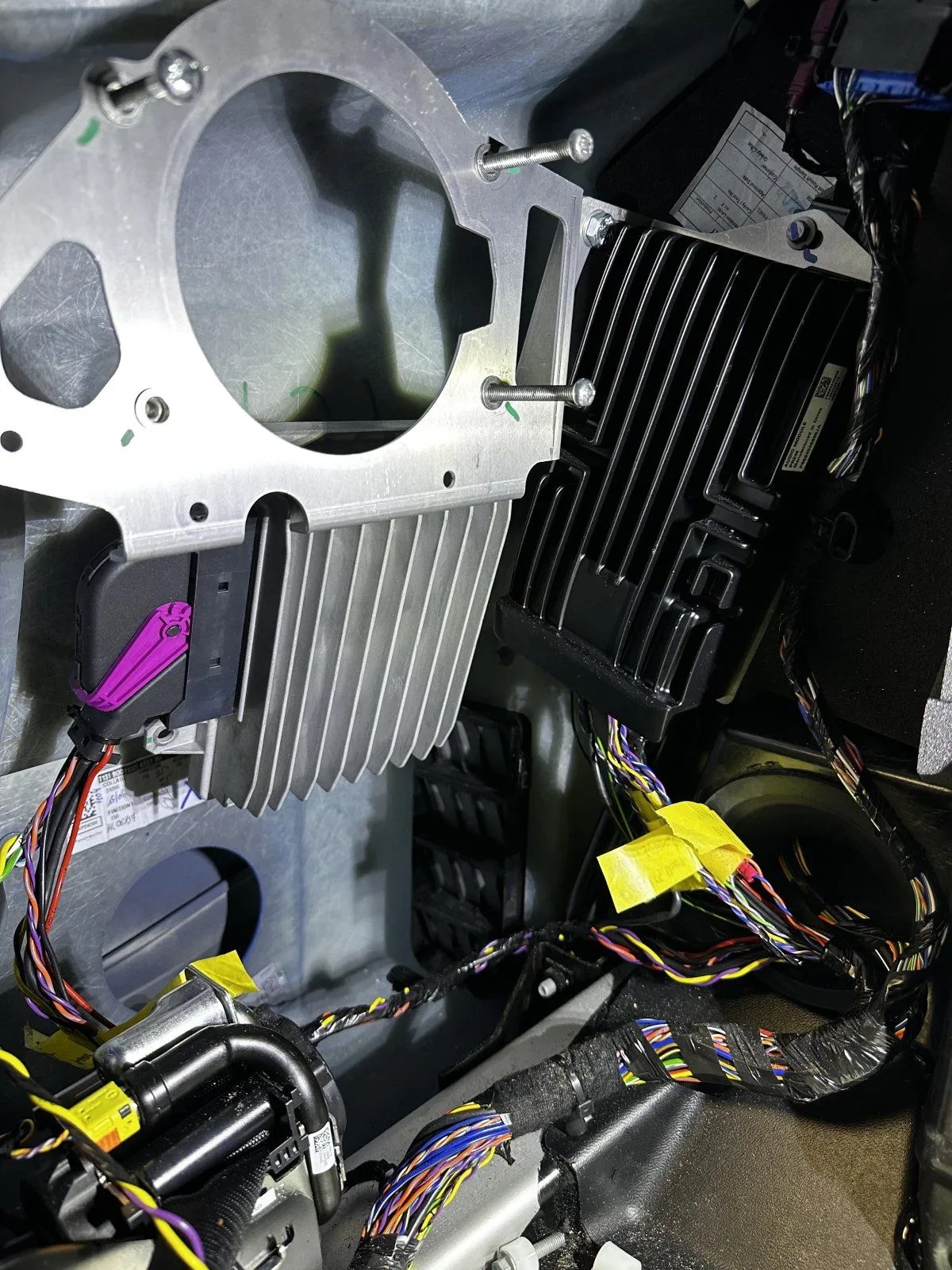

Also, what do you plan to do with the amplification? Reuse the OEM amp with your new drivers?
Hi & thank you!
There are 2 Amps / Drivers.
The silver one is for the Rear speakers and Sub only. This measures 22cm (including the large black plug) x 19 cm.
The black one drives both door speakers and the one in the center of the dashboard. This measures 20.5cm x 11 cm.
At the moment both will stay. My plan to take the speaker outputs from these and run them into / through an Audison AF M8.14 bit driver. This is a larger amp to run my new door speakers, rear speakers and A-pillar tweeters. The Sub I've chosen has its own Amp.
Sorry, I meant the KEF Uni-Q driver in the front doors. :)
Would be great if you could get a signal wire that’s feeding the standard amp, rather than use the standard amp outputs. Shouldn’t be too difficult to determine those low level signals, they should be screened cables.
