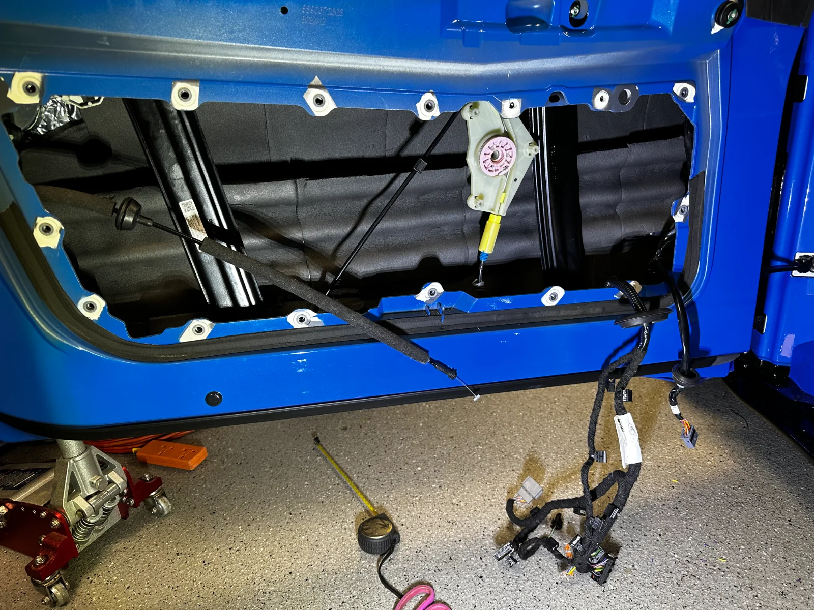

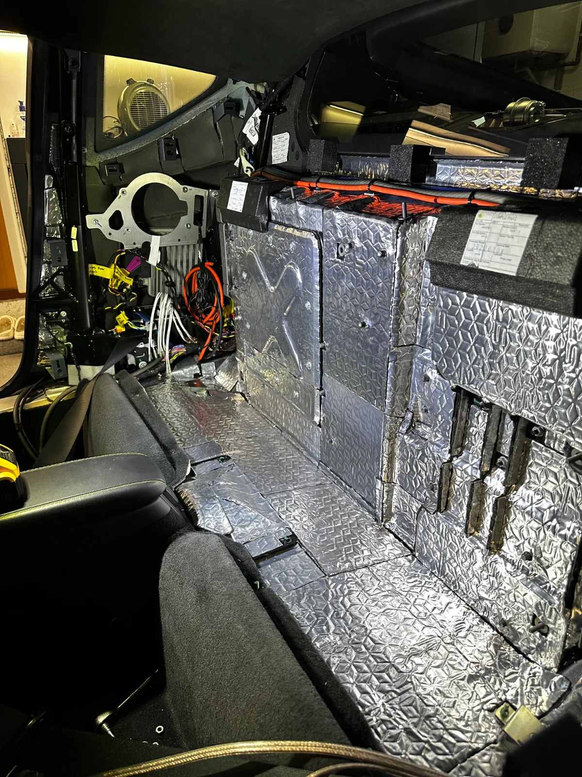

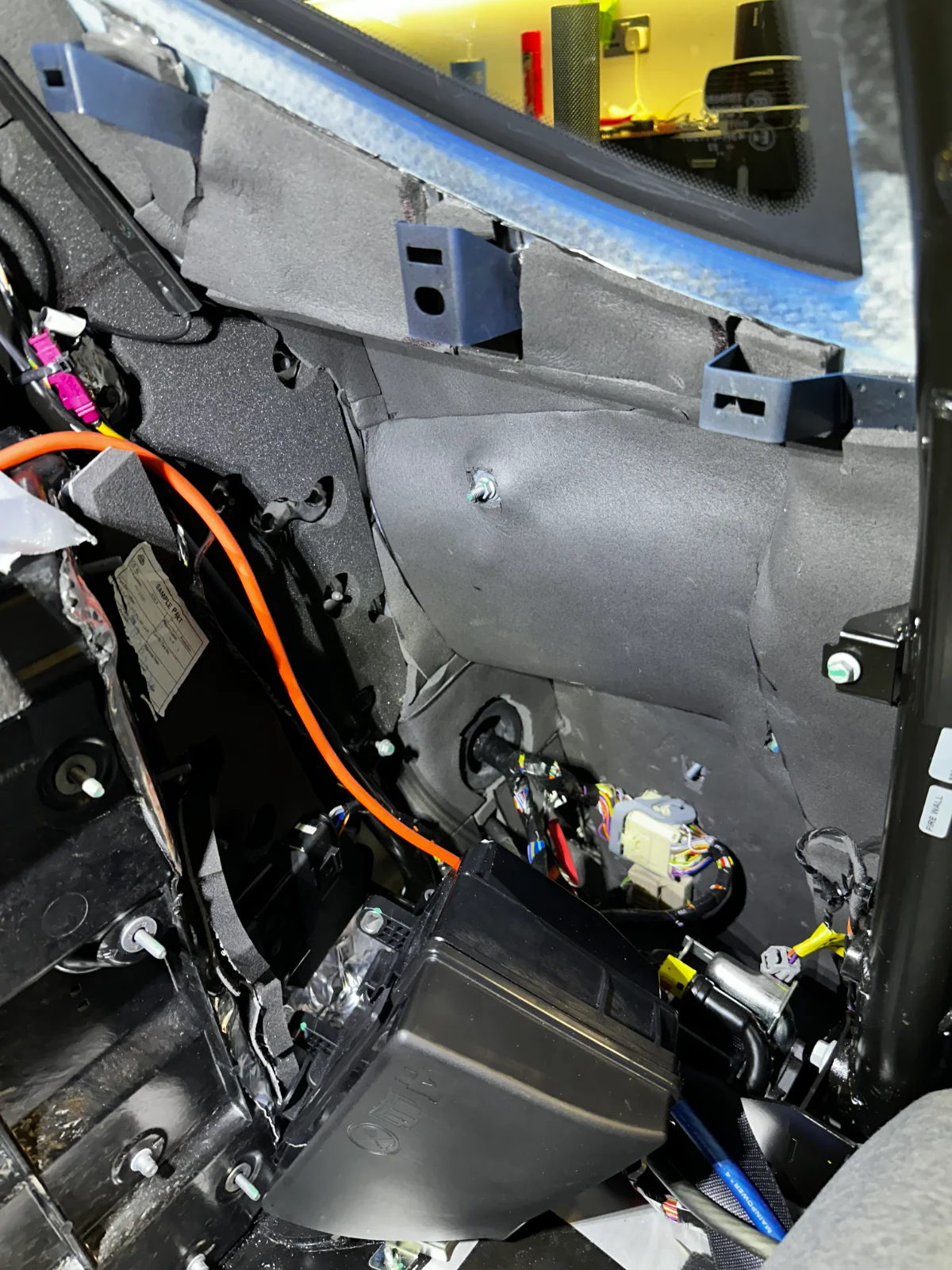

As for sound deadening - With all the rear compartment trim removed I installed sound deadening to whole of this area (see attached pics). Then acoustic foam over the top in the rear quarters where the speakers are situated.

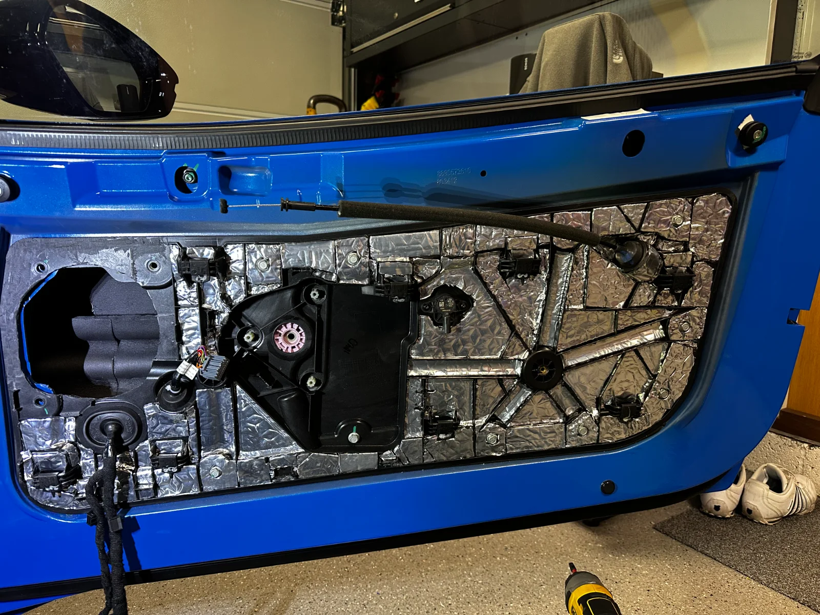

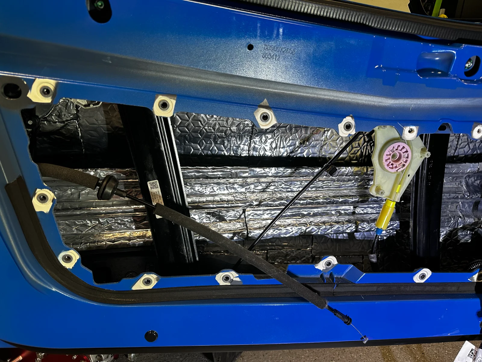

The insides of both doors were done too + foam over the top, & even did the inner door cards, which made the doors sound better when closing (see attached pics).
No more road noise or stone-flicking-up noise.
