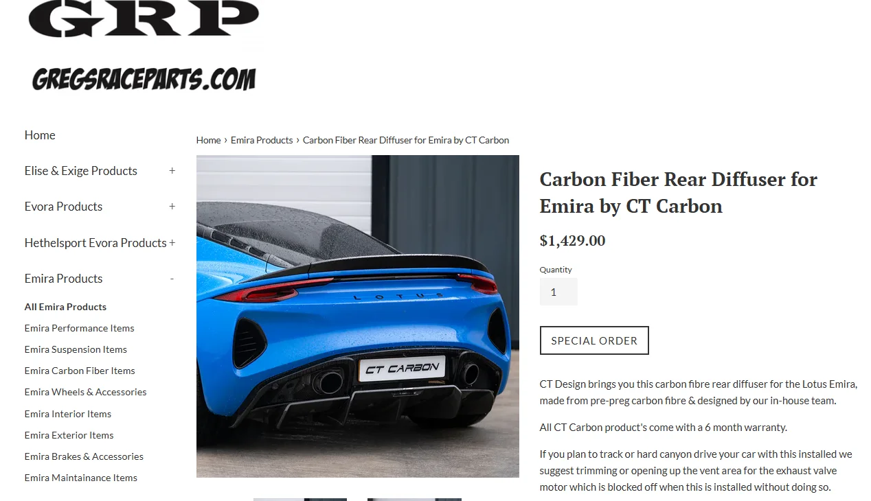

I am advising everyone who doesn’t want any limp mode issues to ONLY get a wrapped stainless steel exhaust with valve controller relocation kit from Boomgear through Aerie performance or use Mach 5 performance which may have copied boomgears. PERIOD!!!
I had to modify mine because I already got the titanium exhaust. It saddens me that the vendors know by now that this creates too much heat on most cars and don’t tell anyone.
The main problem lies with the V1 controller from Milltek and its wiring being too close to radiant heat (no matter which muffler you you have)
If you plan to track/hard canyon drive your car the V2 controller is the way to go. (If anyone does have an issue with the V1 milltek is taking care of it free of charge)
Your problem was also exacerbated by having a CT rear diffuser panel which blocks off the air flow to the valve motor area and thus increases the heat.
Many guys are tracking their cars with our Ti and other Ti exhaust and havent had any issues,. Throwing out a blanket statement that they are bad because you had an issue isnt really fair is it? Are you sure you didnt have your valve force closed causing excessive heat build up? (I suggest this because you had inquired at one point not knowing what button does what etc) You're the only person I have seen have a valve motor literally melt down so something has to be different in this case.
Regardless of it all some heat mitigation for that area above the diffuser and/or locking the valve open and relocating the valve motor would solve it all 100% no matter what exhaust you have.

The reason I didn't know what button did what was because the Milltek went badon the way home, even before I got the CT carbon diffuser, with the titanium exhaust. Yeah, I drive it like I stole it!!!
Milltek and vendors should only be selling Version 2 or letting people know Vesrion 1 has it's drawbacks. Vendors selling CT carbon diffusers should let there customers know there may become an issue with the valve controller overheating due to lack of venting. Vendors, in my opinion, should also let customers know, Hey, are you going for looks and light weight or are you tracking because then you should get stainless steel exhaust. I already saved one customer to decide if putting on the CT carbon diffuser he bought, is in his best interest based on his driving style at the shop.

Shouldn't there be an explaination after "without doing so." ?
I heard Ryan is going to make that too but it requires owner cutting the diffuser. Removing the diffuser is quite time consuming.
Does the diffuser need removing, or can it be cut in-situ??? I' really should just have a look at mine :-)

The ct diffuser seems dumb w the vent covered.
