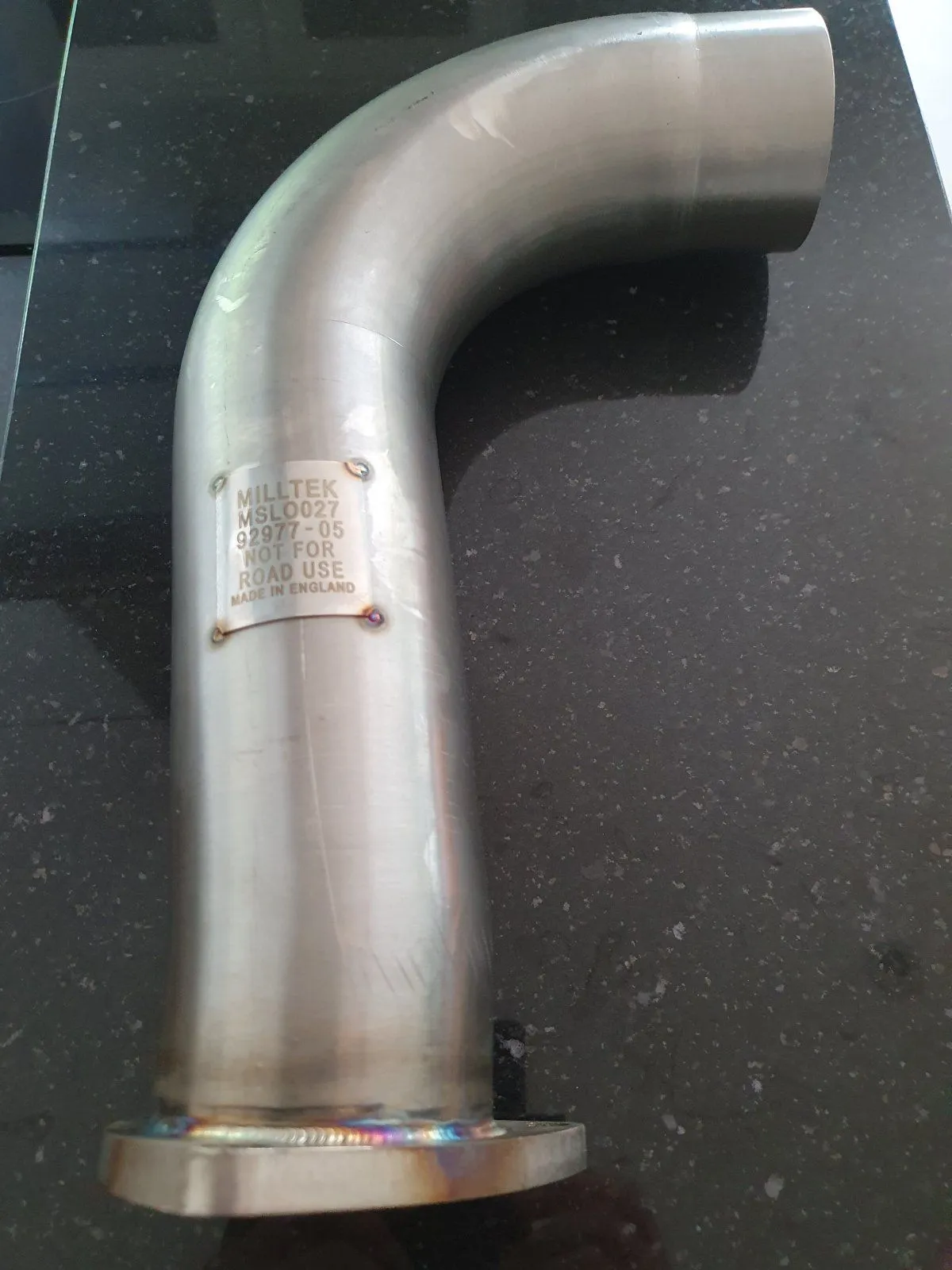

@Joel fingers crossed your source is correct. Tempted to get one if it’s a bit louder, lighter and gives a small power boost
Just talking to my exhaust mod guy, obviously he's never done one, I'm right in saying there no opf/gpf ?
Correct, just a third catalytic converter, it also has no o2 sensor.

Yes the cats integrated with each of the exhaust manifolds has an o2 sensor in each.
A lot of the street full header back exhausts for this system will remove the two cats and replace the third cat with a low cell count cat and plug both o2 sensors into the third cat with extension cables.
The race exhausts will delete all the cats and a check engine light will be present.
Street “axle back” exhausts will just remove the third cat and they’ll likely be just fine. Most exhaust systems will fall in this category.
Not for road use. As we say in Scotland, aye right :)
I’m thinking of getting this for my Emira. Would you recommend it? How’s yours sounding now?
How does it sound? Hilarious :D Raw, rorty, much louder in Sport, especially at high revs when the exhaust howl now drowns out the supercharger whine. Recommended if you would like the car to have a more raw, visceral edge, with the caveat that it might be a bit much if it is a daily driver.
