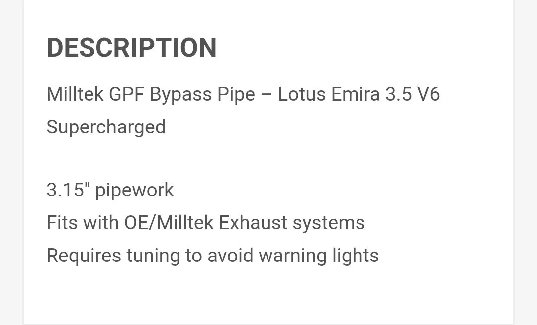

Anyone with a 3rd cat delete tell me what/if warning lights were thrown up?
None at all in several months.

I've got a back box mod and the valves fully open and wonder if cat delete would be too much 🤔
This is why I asked btw
Yeah not sure why Milltek say that. The stock catted pipe has no sensors. It is downstream of the o2 probes.
Yeah thats what the guy said when he did my back box. I might give it a go, not a huge investment if it turns out to be too rude

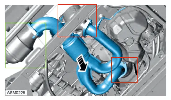

Does anybody knows we’re the OPF is located? Is it located on/at the 3rd cat? What does the 3rd cat finally do?
There is no OPF, there is a primary catalytic converter located on each bank of the V6 coming off of the headers. Finally there is a secondary catalytic converter with no upstream or downstream oxygen sensors that Emira / Evora owners often call the "3rd cat".
2x Red = Primary Cats
1x Green = Third Cat
Blue is the downpipe which combines both bank's exhaust flow together and merges to a resonator and then to a single pipe that feeds into the 3rd cat. You can slightly see some of the sensors in this photo as well, there should be 4 oxygen sensors total, 2 in each primary cat, 2 after each primary cat.
Finally to address what the third cat does -- it reduces emissions -- something this aging drivetrain has trouble with.
