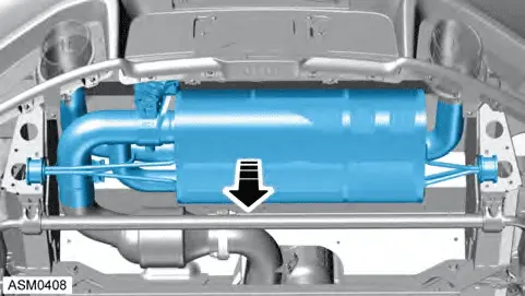

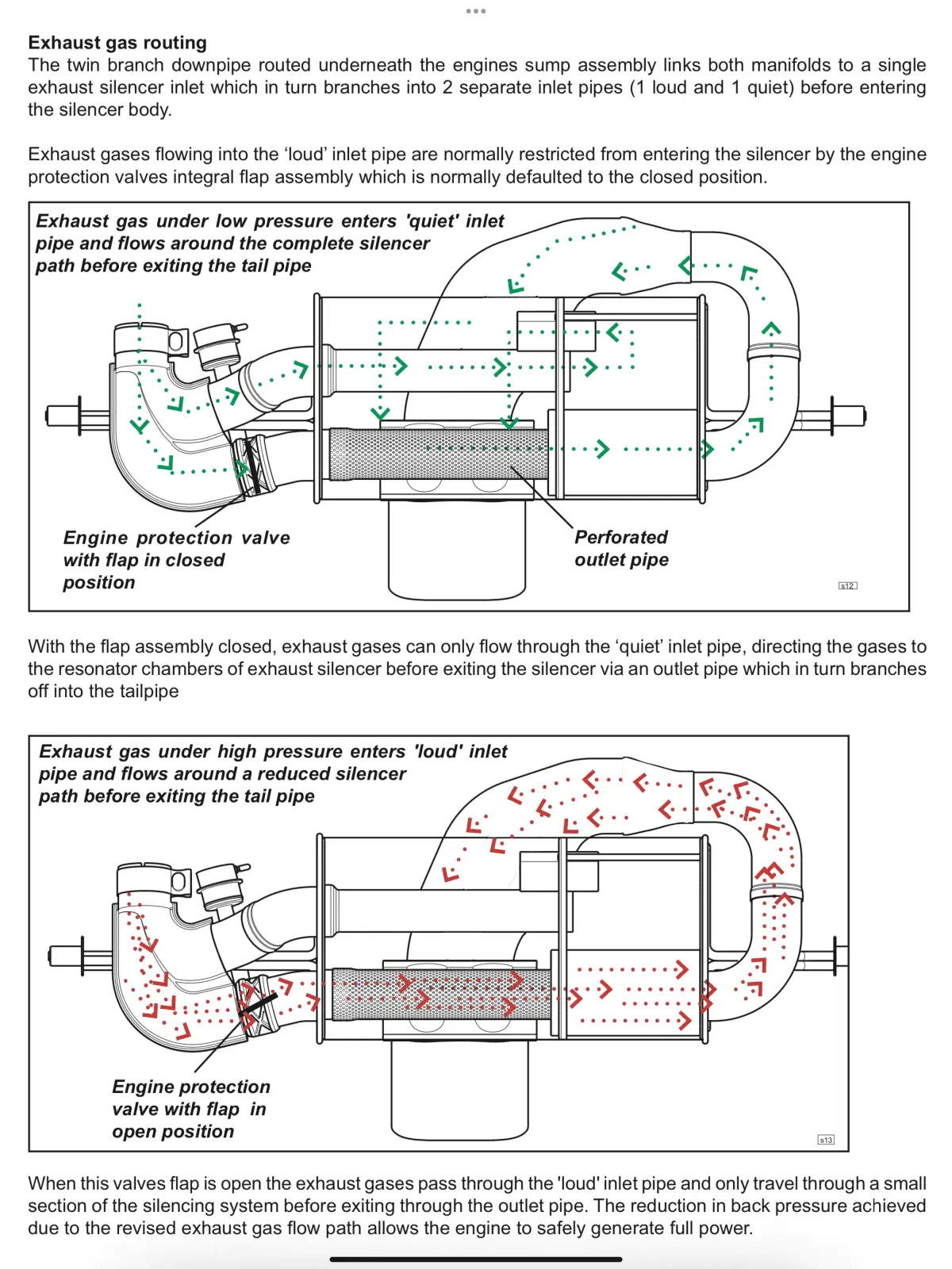

They use a different type of muffler (silencer). The Evora had a single exit in the center, while the Emira has dual exhaust exiting out the ends of the can. That can make a significant difference in how it sounds, and how it reacts to changes.
As you can see above, the Emira also has a split silencer inlet where the main exhaust charge coming from the engine is diverted to a narrower input tube, or the valve opens to allow full exhaust flow through. Very interesting design.

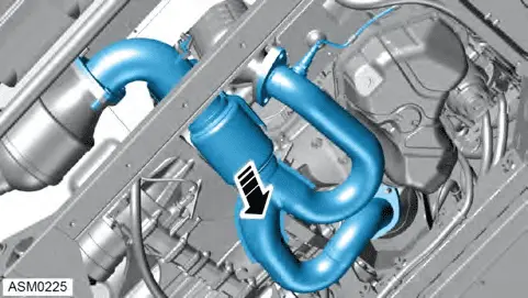

For more info on the cat layout... here's the downpipe itself. It looks like each bank has a pre-cat closely coupled to the engine, followed by a merge and a wider section that is either a flex joint or a resonator. This is followed by the "secondary" (as described in previous posts) cat after the downpipe, between the downpipe and the silencer.

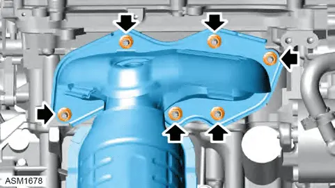

Close view of one of the pre-cats, closely coupled to the engine in the exhaust manifold. There's one of these per side, and the design varies slightly.
Ignore the black arrows throughout these images, those are parts removal instructions, not relevant to the flow direction.
[edit] Fixed above description to clarify cat routing
For more info on the cat layout... here's the downpipe itself. It looks like one bank has a pre-cat before the merge, and the other bank has no cat before the merge. Both sides then flow into what appears to be a primary cat, followed by the "secondary" (as described in previous posts) cat after the downpipe, between the downpipe and the silencer.
Ignore the black arrows, those are parts removal instructions, not relevant to the flow direction.
@Porter , thanks. Too technical for me, but it appears because of this silencer design, removing the secondary cat could prove to be futile. You may need an entire silencer change to make a significant difference
As this is CAD print I think what you refer to as primary cat could well be a flex joint which isn't shown properly (only outer dimensions for digital mock-up). I assume this as there must be a flex section in order to compensate the engine movements.
On the picture above you can almost see both pre-cats which are flanged to the merge pipe.

There is a ‘primary’ cat in each manifold (just not quite visible in @Porter ’s pic above.)

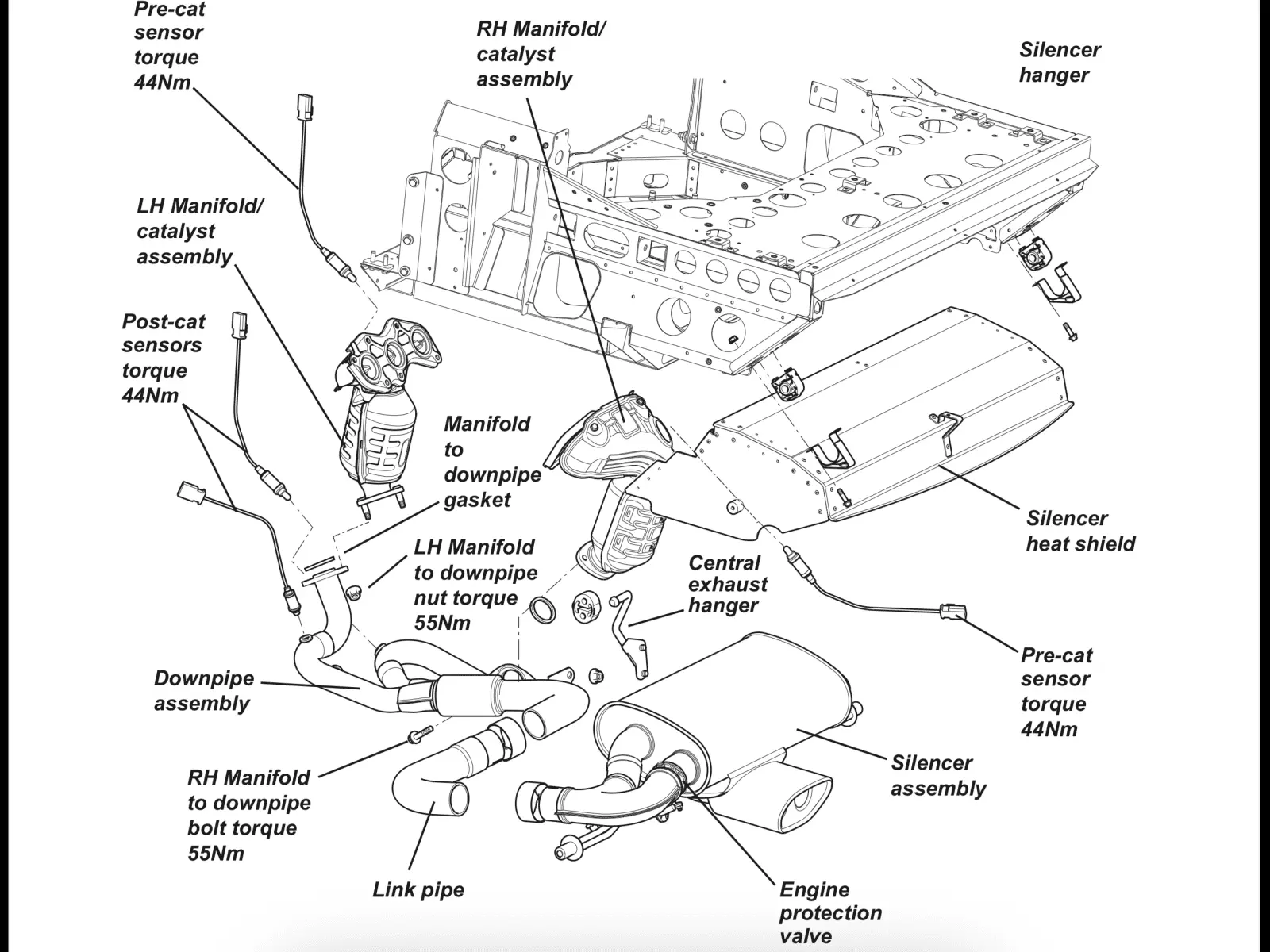

Edit: here’s the Evora setup.
Where it’s labeled “link pipe” is where the ”third“ cat goes.
Thanks, I fixed my description. You're absolutely correct.
I also added an image showing the pre-cat location in the exhaust manifold (per side).
