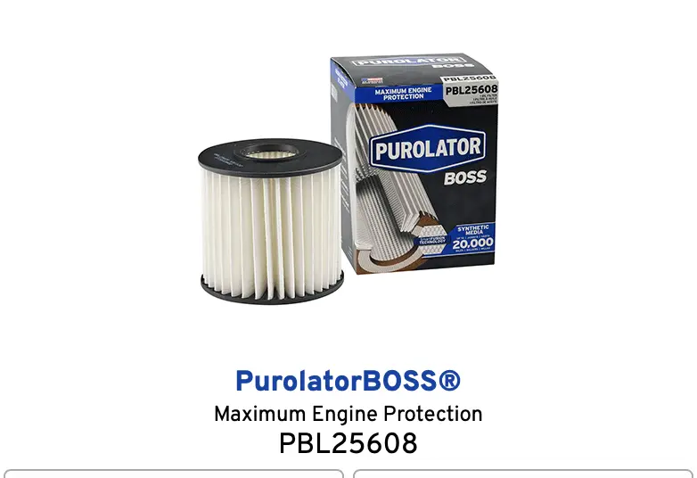

Get this filter (you can get it on Amazon):

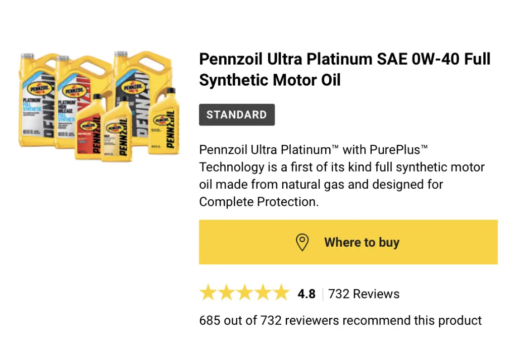

7 qts of this oil (though the manual says 6 liters, that's actually 6.2 qts).

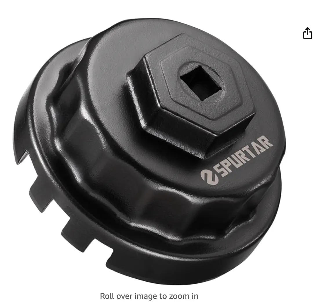

You can get the filter wrench from Amazon for $8

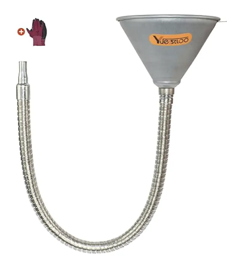

You'll need a drain pan and funnel which you can get at any auto parts store. I got a metal funnel with a flexible spout, because otherwise it's difficult to pour the oil into the engine. It helps to have a long spout if you're also going to change the trans oil at some point in time. Amazon has the one I got for $17.
The Amazon links are below the images. For some reason the site won't let the Amazon links show the images.
