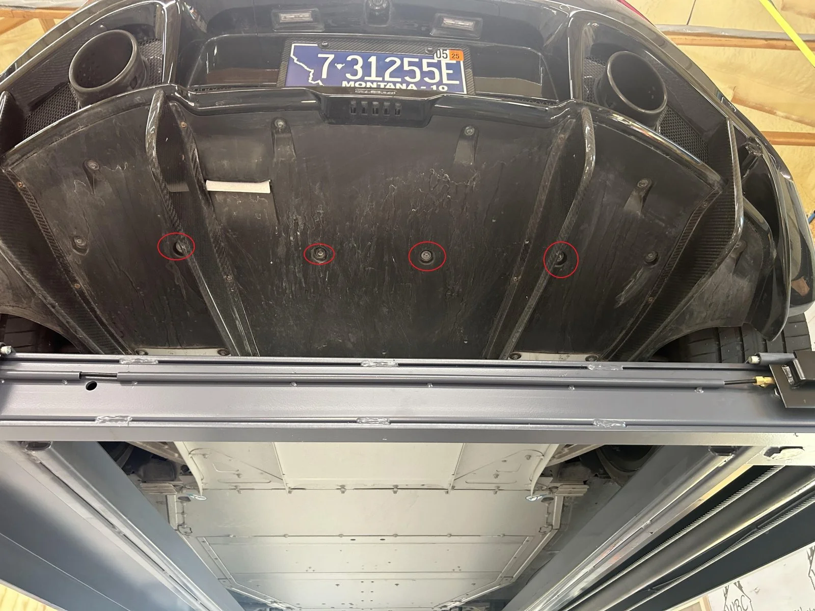

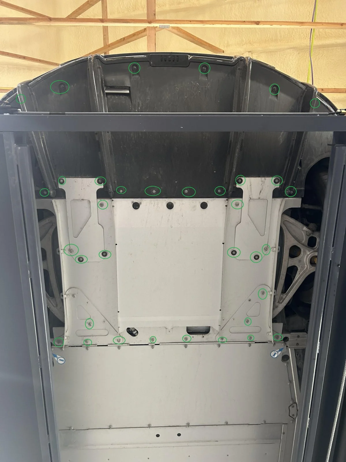

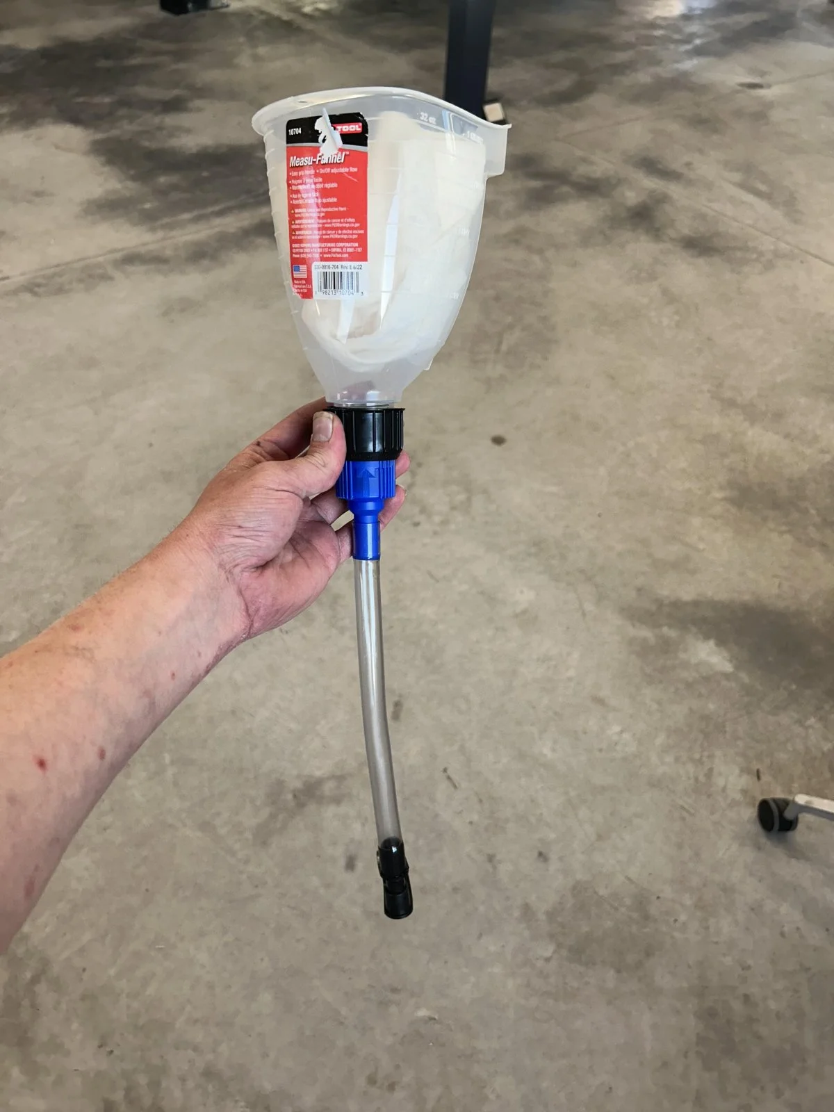

We did the oil change at 1k ourselves, you'll need to remove the rear valence, and rear skid plate. I have a picture of the diffuser with red circles, do not remove these, they hold a bar that stiffens the valence, removing them won't do any harm, it will just unmount the stiffening bar. The other picture with green circles are the bolts you need to undo to get access to everything, they're 10mm, and 7mm 6 point hex heads. We had an issue with some of the nut inserts where they bent and wouldn't allow the screw to go back in, just need to be careful to not bend them when removing the bolts. Last pic is the funnel you'll need to put the oil in, it's tucked under the right in the engine bay and a traditional funnel cant be used to get the oil in. Other than taking off skid plate/valence it's the same procedure for any car to do the oil change. Tomorrow we're putting on a new exhaust so I can take some better pics of everything uncovered.
You don't have to remove the diffuser for an oil change. There are also 3 bolts under the black rubber caps in the center by the diffuser. I marked the bolts that do need to be removed in red

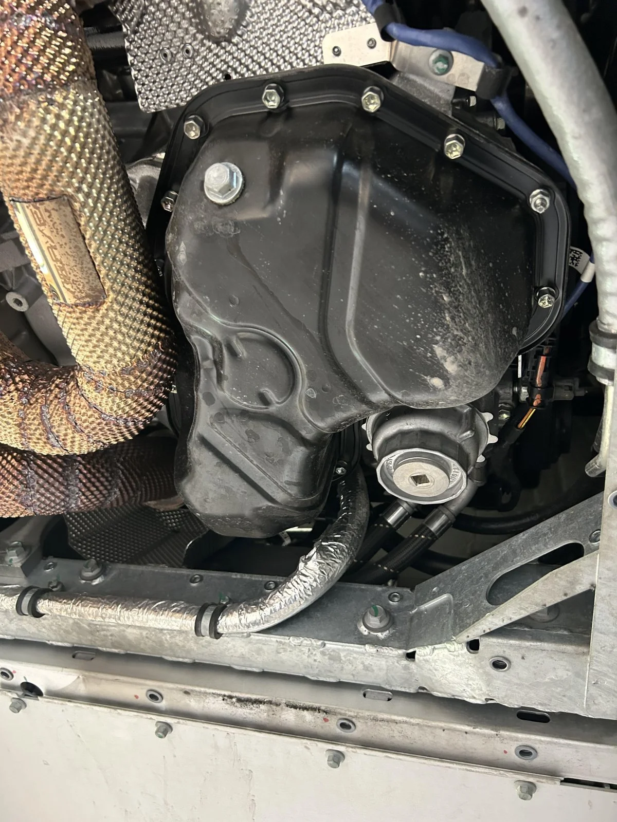

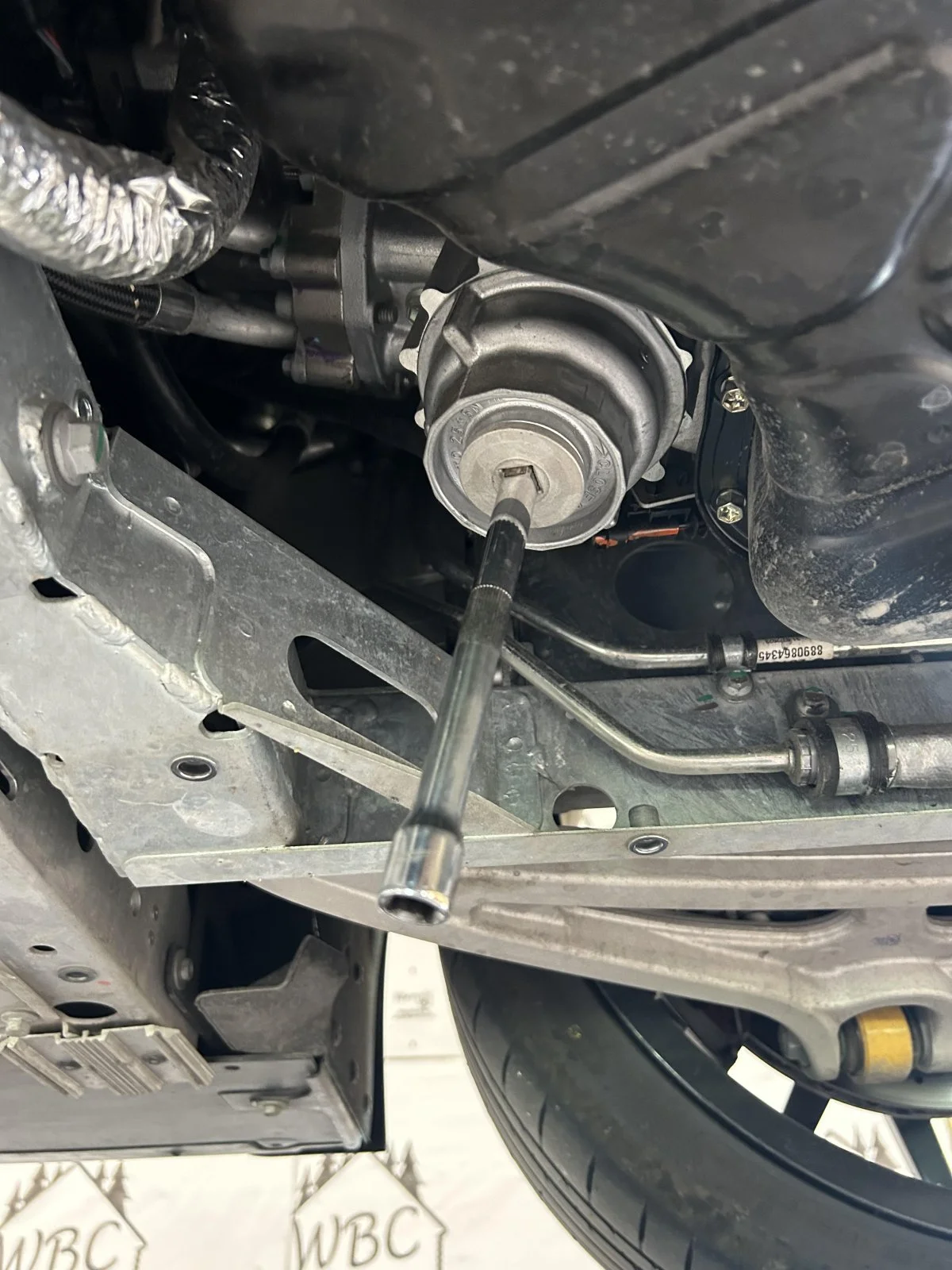

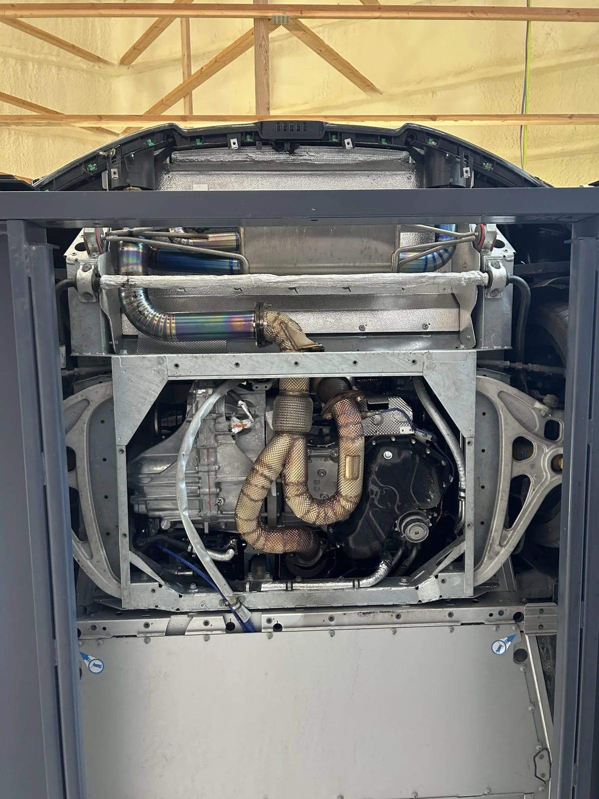

Thanks for correcting, it's been a bit, added pics of the tray removed, 14mm hex for the drain plug, 3/8" drive for the oil filter housing.
