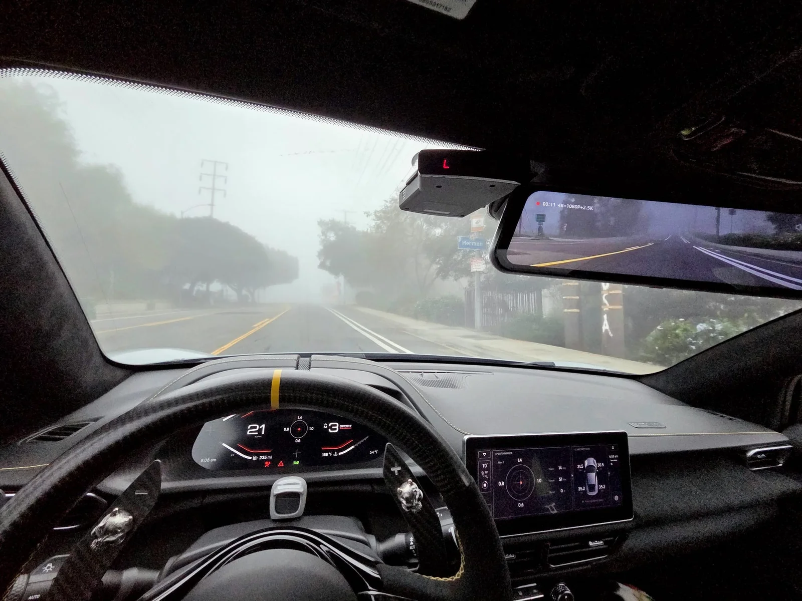

I got the three camera G900 Tripro on Amazon was $329. This was all due to me seeing some very nice and convincing OEM digital rearview mirrors in Asia in the Alphard vans. Very high framerate and surprisingly realistic field of view.
It seems there are a ton of similar products using the same panel and electronics...this one comes with an additional cabin camera but you can opt for a front bumper camera as well but that's more for trail runner vehicles. The main unit has a camera pointing out front and then you have to attach the rear camera somewhere. On our cars you have to place it outside not through the two layers of glass due to reflection issues. I placed mine next the the stock reverse camera.
Pros:
-Very wide field of view gives you 3,4,5 lanes of view that can go even past your side mirrors. It's very good for lane changing and knowing what's near your car.
-The main screen attaches via rubber straps to your stock mirror so you don't have to do any major surgery. The major surgery is routing the rear camera wire from the rear bumper through the firewall into the cabin.

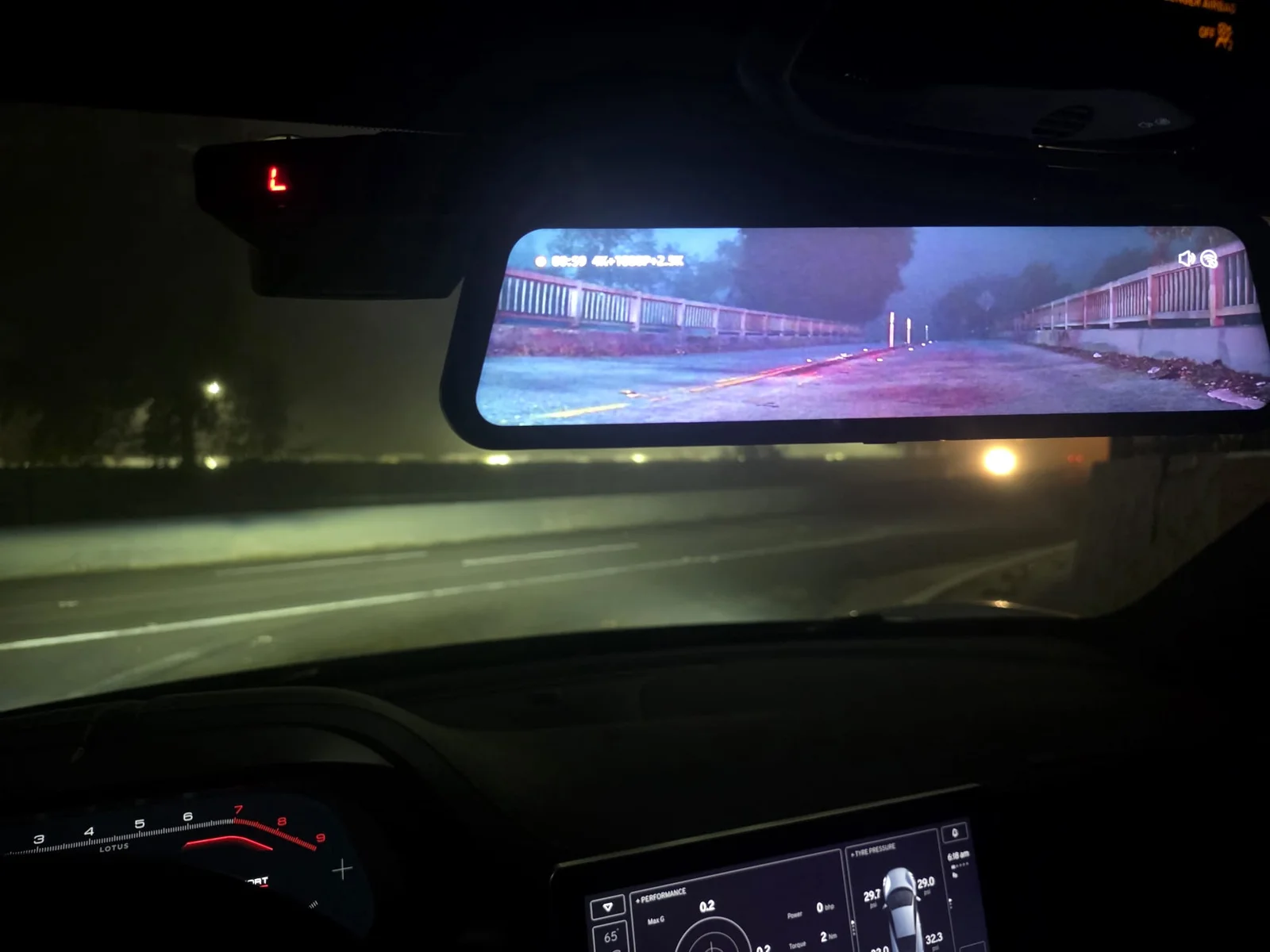

-As seen in the photos in pitch black and dark conditions you actually get a very usable view of what's behind you that is very nice - yes it's super high gain and full of noise but the image is moving so it doesn't matter. If this is a use case you need this is a great solution.
-You get a three channel dashcam that records front rear and interior so you can detach the dashcam you already have.
-You are able to digitally move the image up and down (since the sensor is probably 16:9 and the mirror is skinny) as well as digitally zoom in to get a tighter field of view.

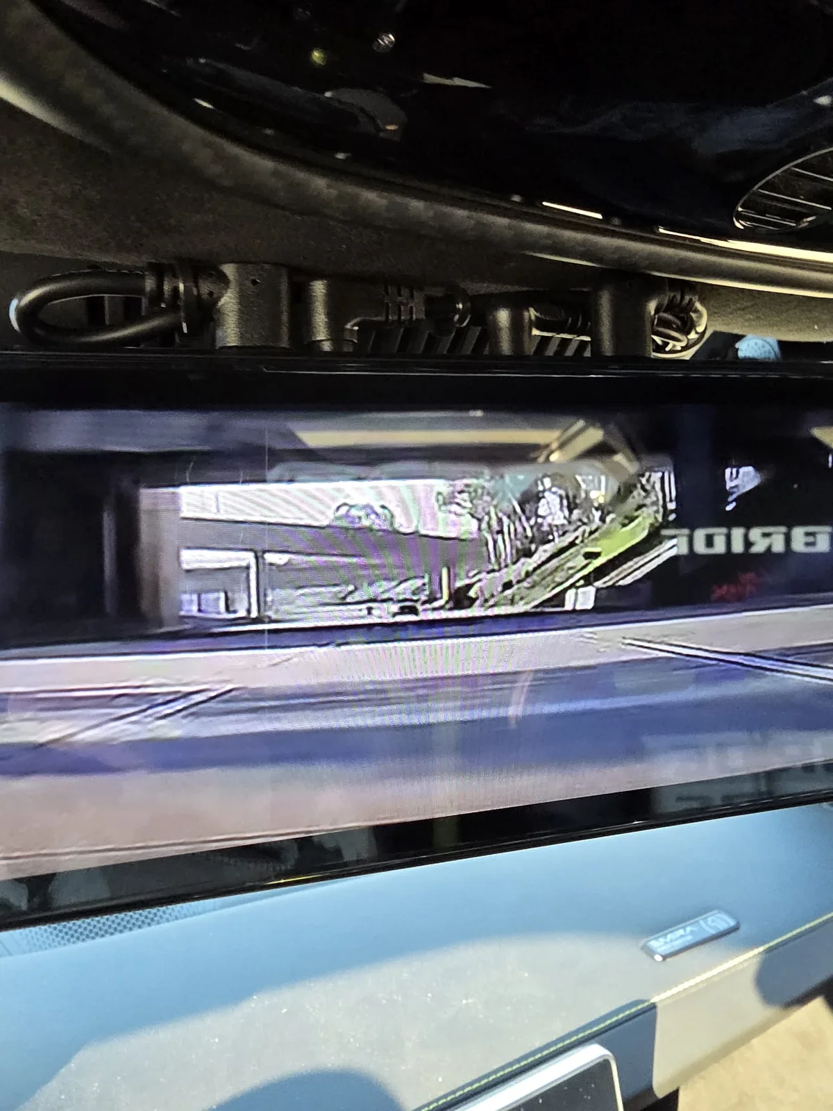

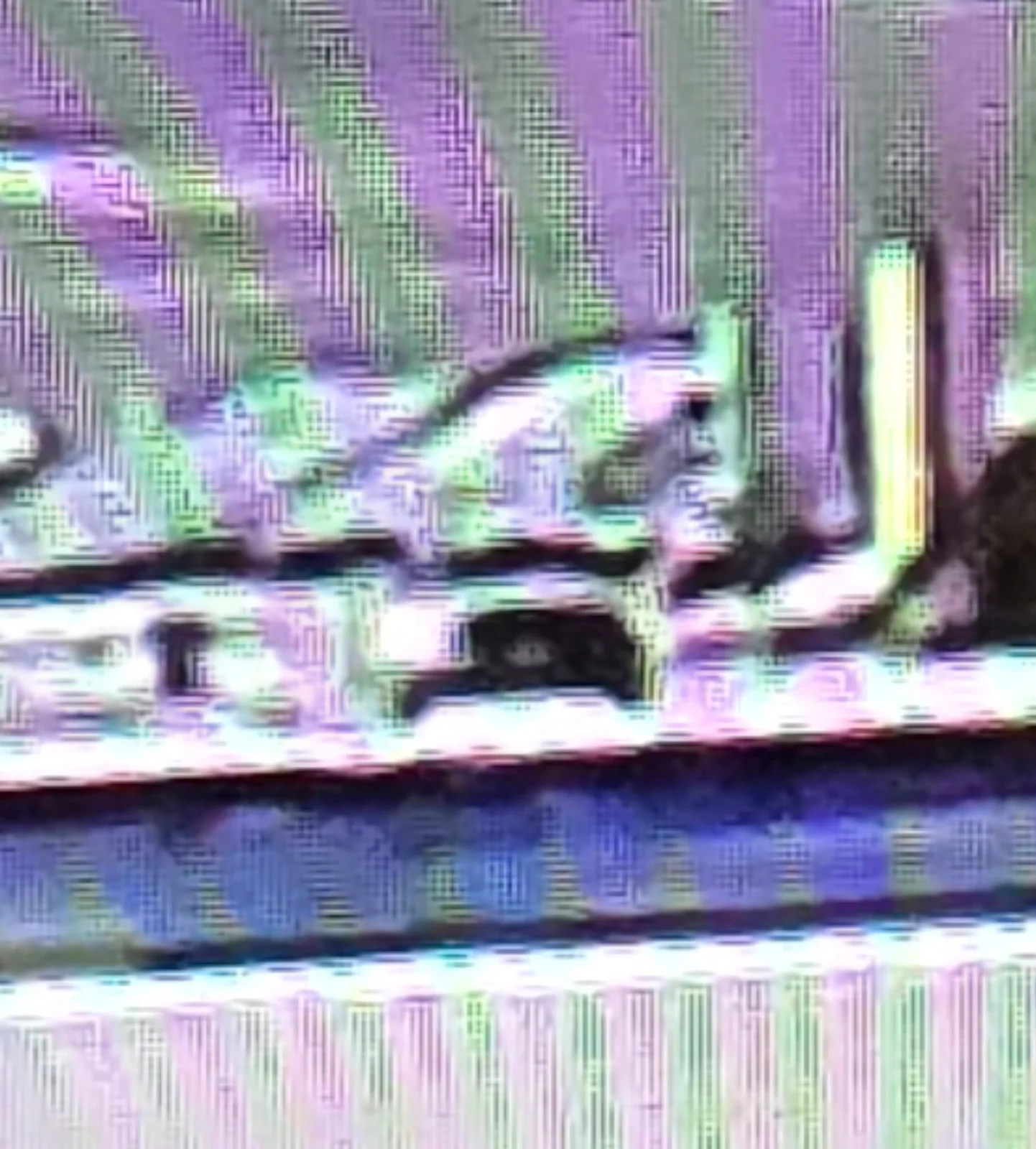

Example here:
Not even zoomed in that much but can you tell what kind of car is behind me? That car isn't that far actually, in a normal field of view you would know what it is:
Service truck? Police?
It was a white Camry lol
