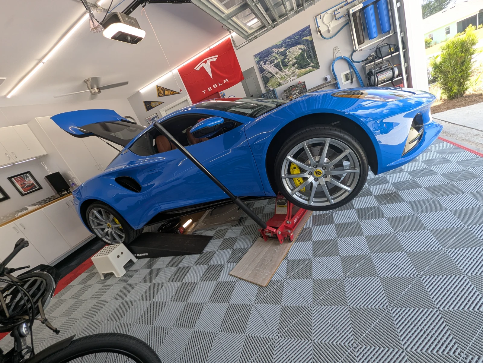

I back the car up my race ramps, then while the oil is draining, I raise the front of the car with floor jacks to level out the oil pan to ensure all oil is drained due to the rear placement of the drain plug.
With respect to a service log, I put together a binder specifically for the car which holds items such as my maintenance log, window sticker, and all receipts.
