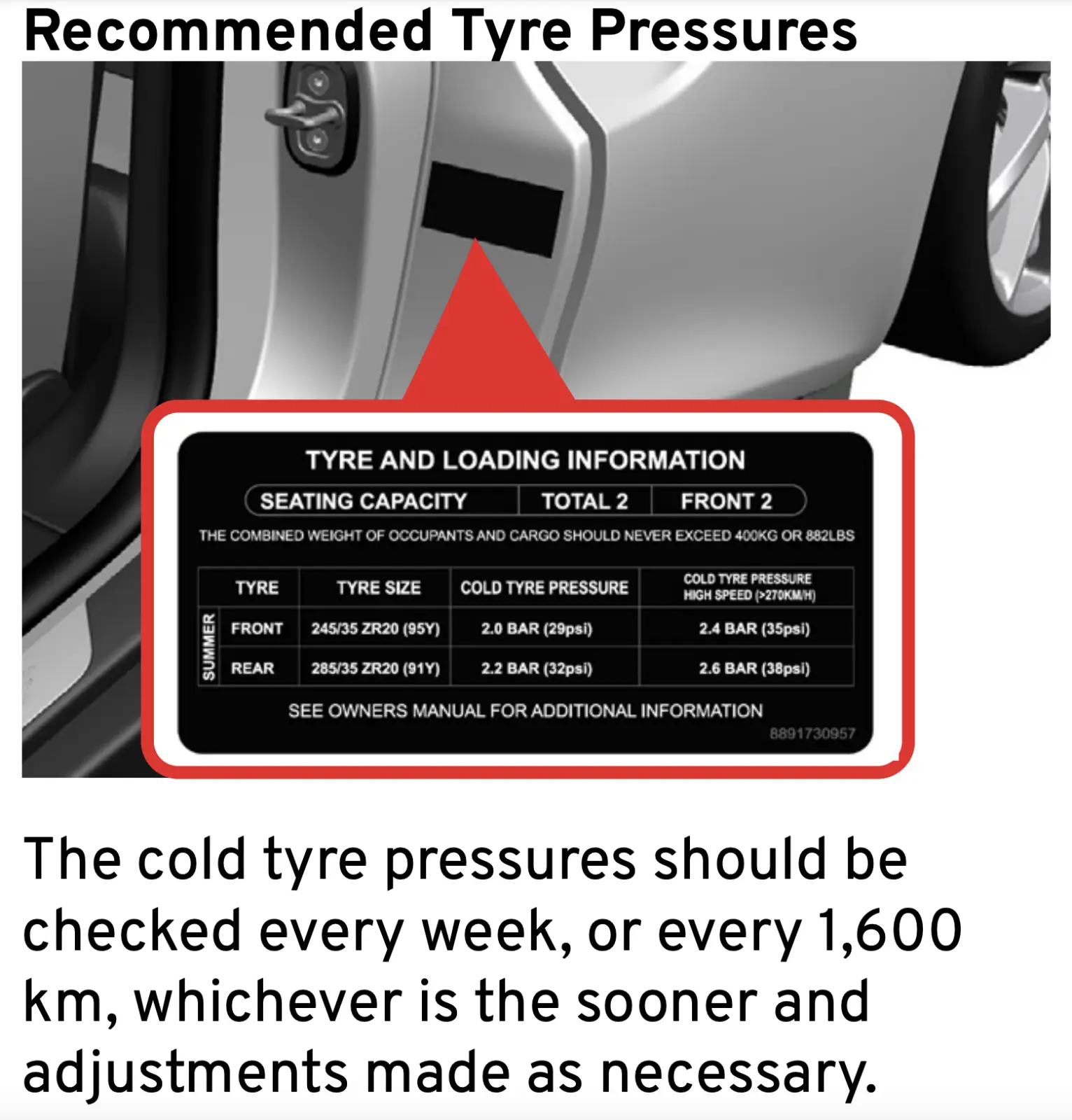

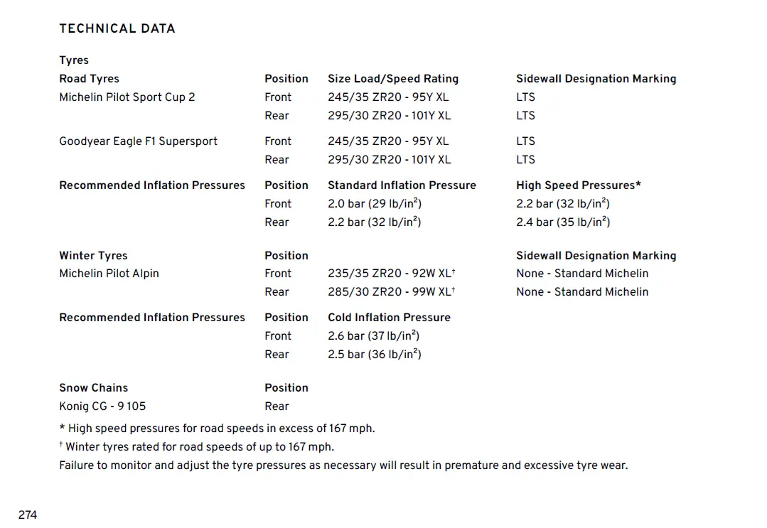

You should go down to 29/32 as a starting point. Then it’s kind of a salt to taste thing right now.
Dealer probably not paying too much attention or not wanting tires to be under inflated setting off TPMS warnings.
There's an old acronym: RTFM. :)

That seems way to high, I lowered mine to 29.5 front 32.5 rear cold.
When I took delivery of my Emira, the tires were over inflated. I have decided to run 30 psi in the front and 32 in the rear. To me, 29 in the front just seems lower than necessary. Just my opinion, nothing factual. The recommended tire pressure for tires on my Porsche Boxster is 32/34.
I will further add that the tire gauges most of us use are not likely spot on. I have two tire gauges (both relatively expensive) and each gives me a slightly different reading of about 1/2 lb. difference in PSI.
