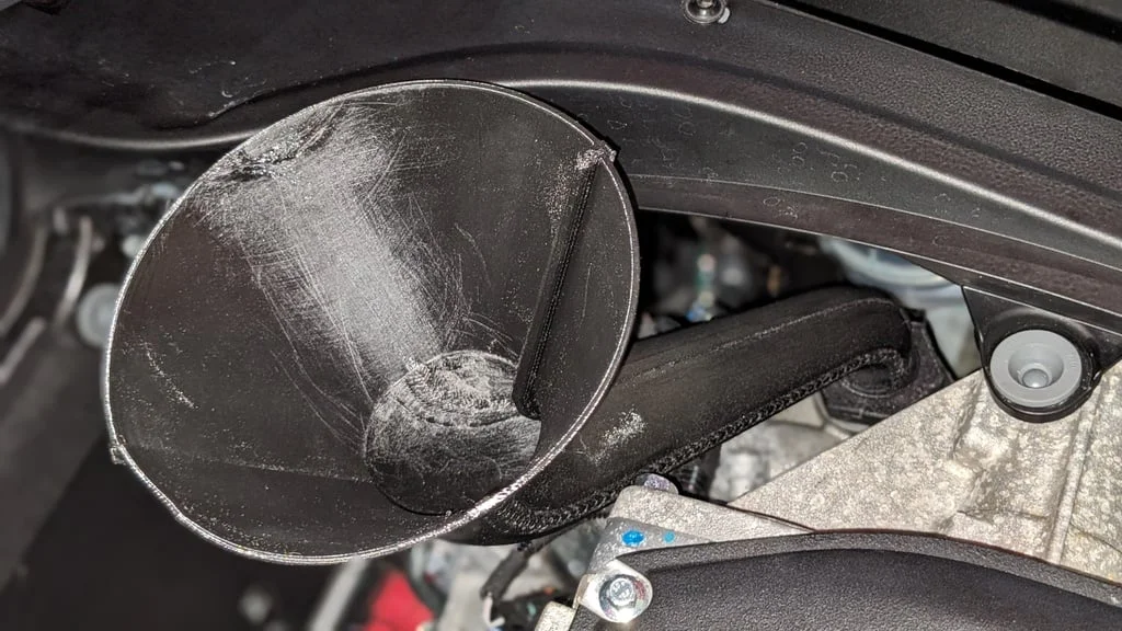

I wasn't happy with the options I found in offset oil funnels for changing the oil in my V6. I designed one that threads into the fill hole. I also added an air release straw just to avoid any glugging. It's here on thingiverse should anyone want to print your own. I used PETG.

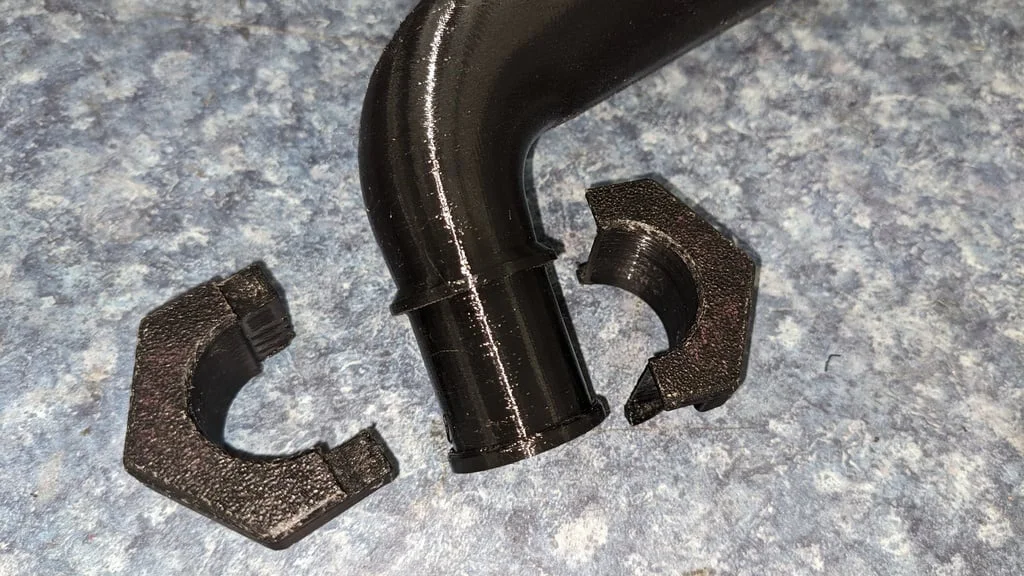

The first one I printed in two halves. It was a little rough but fit was good.

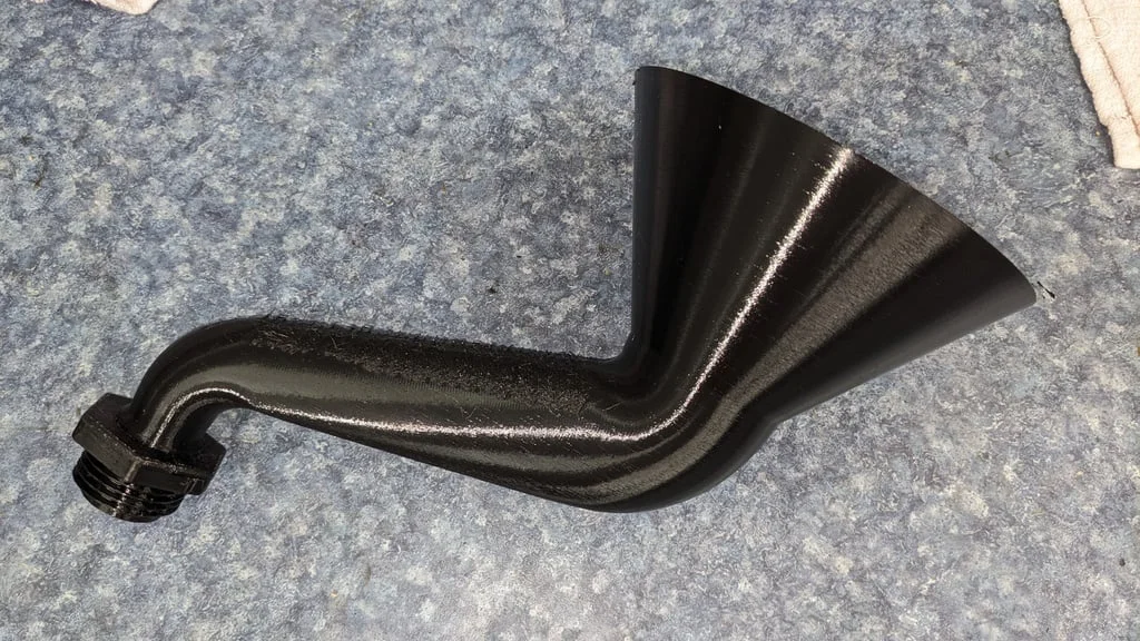

I then printed one in one piece. Turned out pretty decent.
So you use the "collar" part in "emira_funnel" and the "funnel" part in "emira_funnel_1pc" ? I wonder what the safest orientation for the funnel part would be (definitely needs supports)...
I printed it with the mouth of the cone setting on the bed. It only needed supports to hold the horizontal run externally. No internal supports needed. I put in some nuanced chamfers to help print either like this or on its side.
Do you have .stl file for the collar only, or should I just extract the relevant portions from the other .step file?

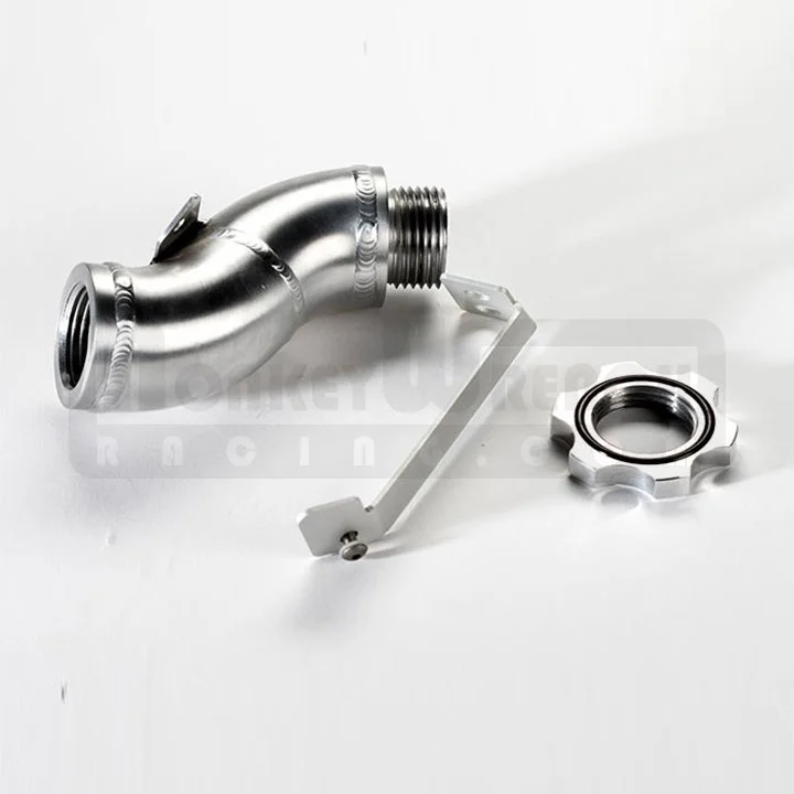

This is great. But I think what we really need is a neck extension that you can leave attached to the car. Like this one for the NA Evora:
So that way there is zero reaching around to screw anything. Just remove cap and insert a funnel.
This is great but I can't print that on my 3d printer :)
