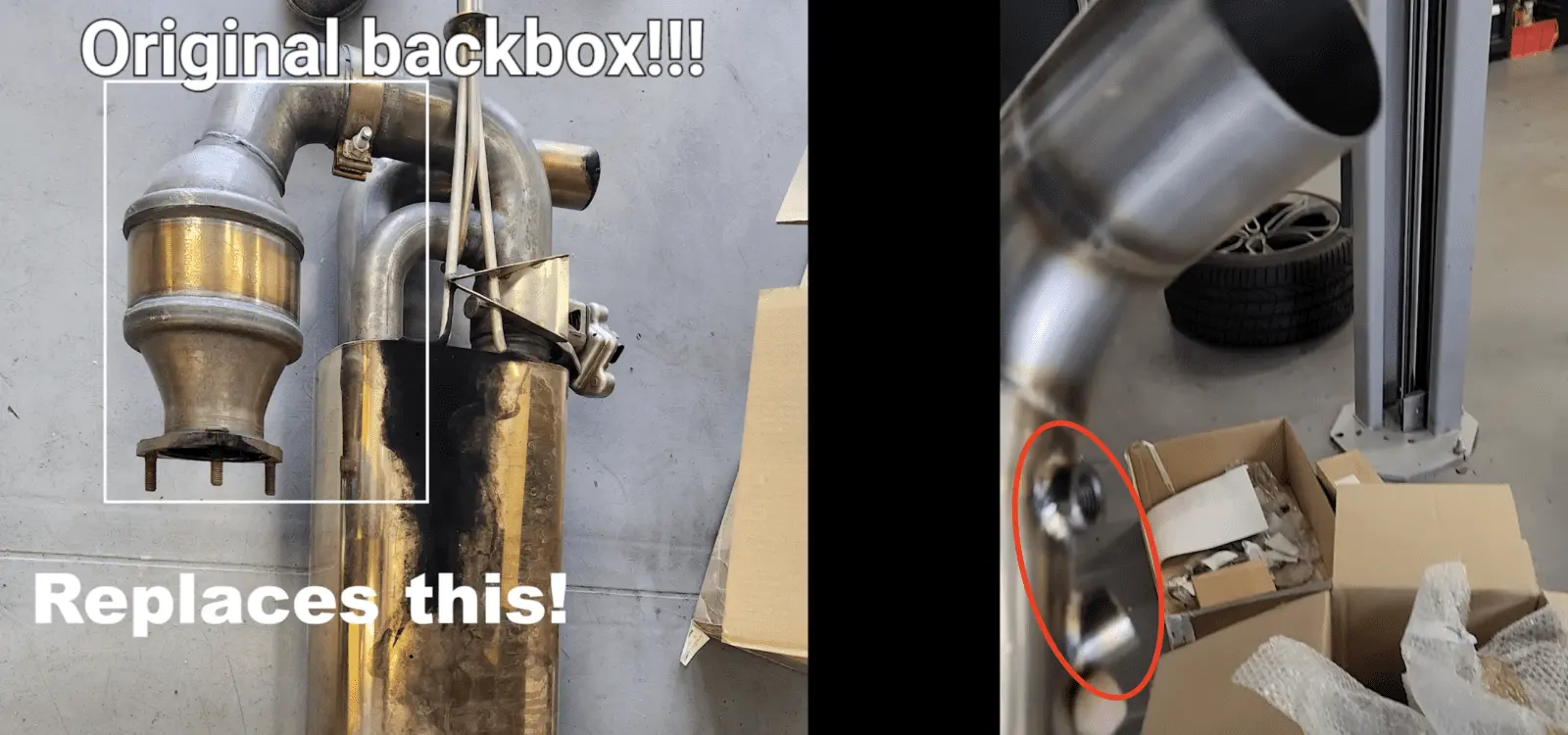

I noticed the decat/3rd cat delete pipe has openings for lambda probes. I don't see any in the stock pipe with the cat. Did you just plug those ports? I don't think the Milltek alternative has those bungs either.

No idea! A good question to ask Larini directly.
This is likely for cross compatibility with a full on race exhaust that includes new headers. I forgot who had plans for this type of exhaust but I remember seeing it a while back.
In this unreleased exhaust you would make new headers for the V6 and remove the integrated primary cats from the headers. Instead the headers would join together and see a singular low cell count catalytic converter with the oxygen sensor cables lengthened and relocated from the headers down to right after the singular catalytic converter.
You can then run this same cat delete pipe on 3 types of exhausts:
1. OEM like exhaust where it just deletes the secondary cat with the oxygen sensor ports capped.
2. Race headers with only 1 catalytic converter at the collector with the oxygen sensor ports plugged into the OEM ports.
3.) Race headers without any catalytic converter at all with the oxygen sensor ports capped.

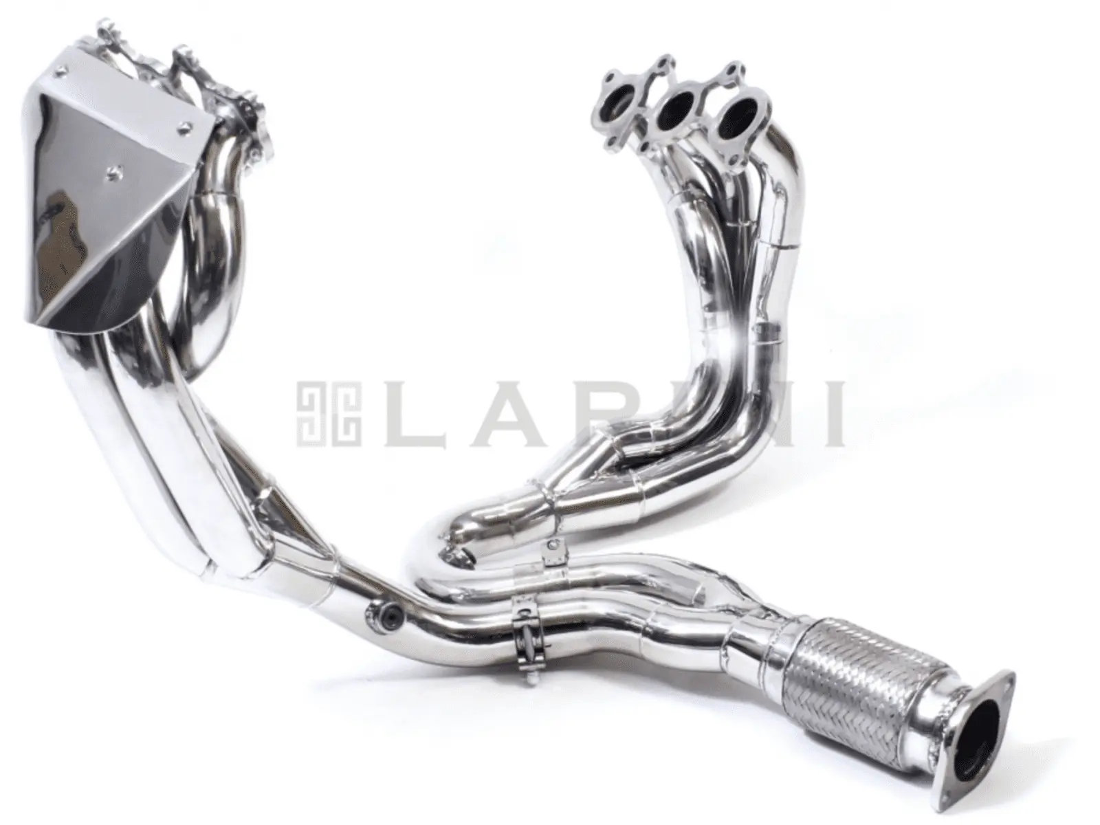

Larini actually offers this for the Evora:
This is part of the problem Larini had I think.
They had my car for 5 weeks and did create the manifold, completely decatted, on my car.
However, there is an issue with something (I believe electronic) whish has needed some part from Lotus, who obviously are not playing ball.
Possibly not worth going for the manifold without having access to the ECU to remap everything for maximum gains.
