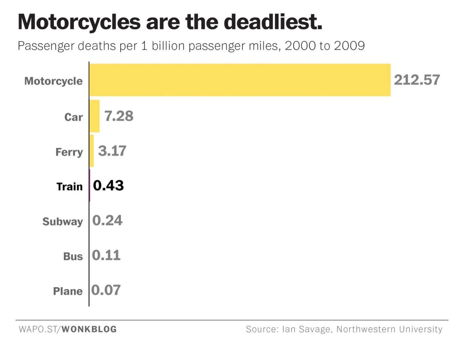

If I want to go really fast - I'll take my R1 out for a spin (if you don't know what an R1 is spoiler alert it's got half as many wheels).
Taken off bikes twice, both the fault of car drivers not looking.

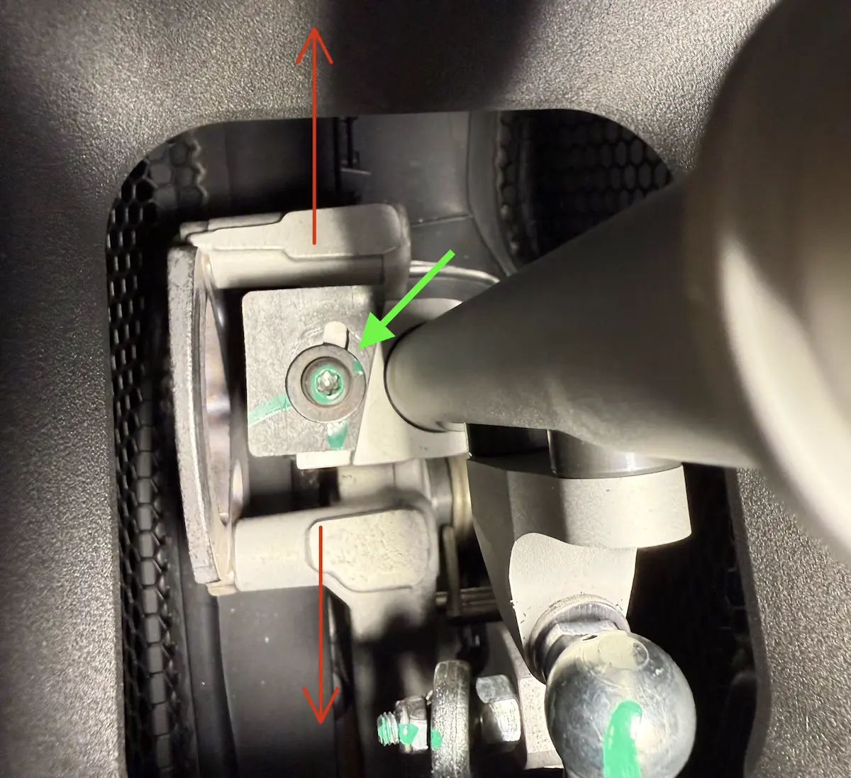

What exactly do I say to the tech when I ask him to make a tweak?For those with 1st - 2nd shift problems, see if you can get the gear linkage looked at. A small tweak can make a difference. I’ve had mine done, as with my Elise previously and the result is much better both 1-2 and going into reverse.
It is the same issue in the automatics too only on 1st to 2nd. Not an issue on the DCT on the 2L though. I really think it’s an issue of the transmissions they chose on the V6sFor those with 1st - 2nd shift problems, see if you can get the gear linkage looked at. A small tweak can make a difference. I’ve had mine done, as with my Elise previously and the result is much better both 1-2 and going into reverse.
There is a shift plate adjustment.What exactly do I say to the tech when I ask him to make a tweak?
This is a slightly different issue.There is a shift plate adjustment.
DIY: V6 Manual 1st, 2nd & Reverse Adjustment - Hard To Get Into Gear
Ever since I picked up my car I've found 1st and 2nd pretty difficult to get into, especially 1st, I'd often have to get into 2nd and then get into 1st making taking off from a stoplight embarrassingly annoying. This also makes downshifting from 3rd into 2nd difficult as well. If this sounds...www.emiraforum.com
