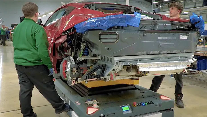

Anyone have a clear screen cap of the rear Emira suspension control arm and pickup points?
Does this help?
He's operating the foot pedal that raises the car.
Talking of foot pedal…… anyone got a photo of the sports pedals in the Emira!? Not seen anyone mention that yet! Are they metallic?
Good enough, none of the control arms are direct carry over from the Evora. Was trying to see if there was a different damper/spring mounting point to account for a discrepancy between the rear spring rates in the Emira vs. the Evora.
