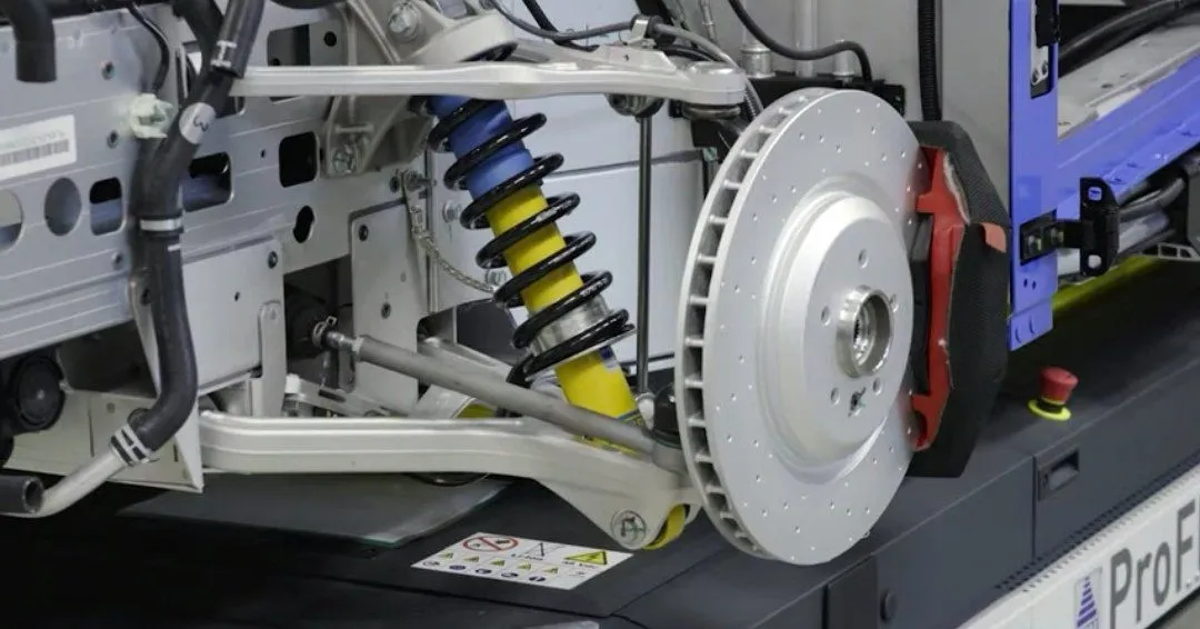

Emira front end showing front suspension

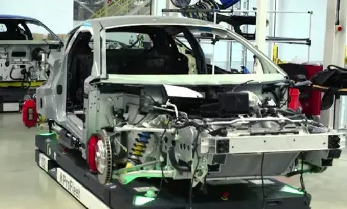

Emira suspension close up

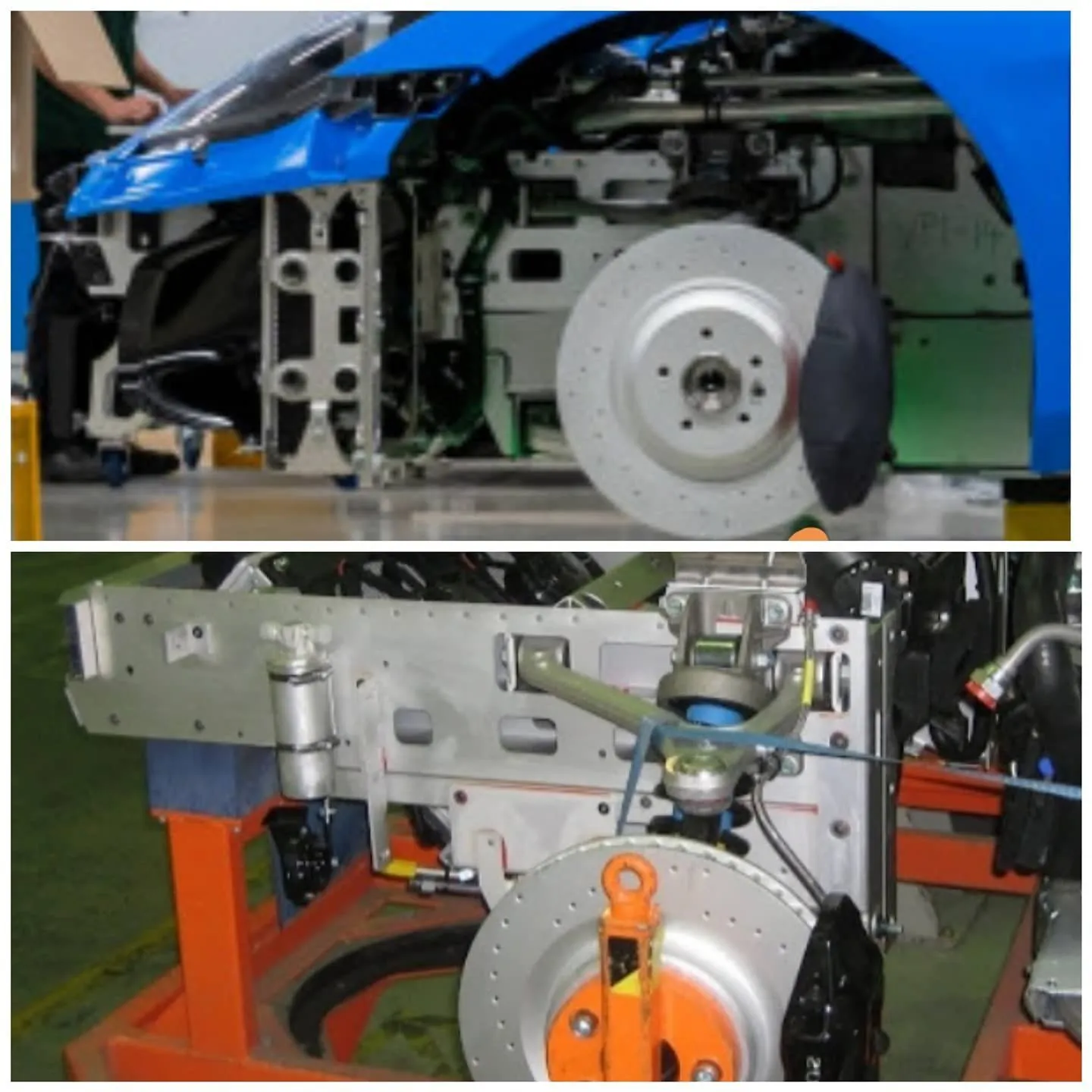

Emira and Evora suspension compared

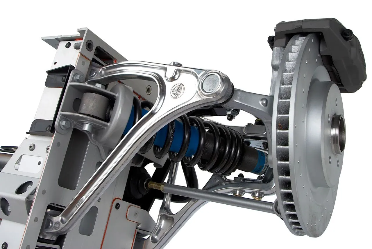

Evora suspension close up - look at those beautiful forged aluminium wishbones!
