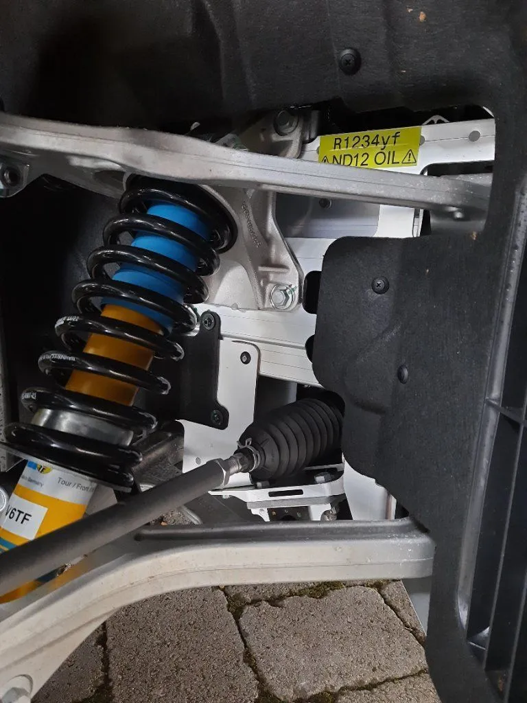

can I see that when the car is on its wheels?
That's a front wheel, so yes, you should be able to turn the wheel all the way to one side and see the damper assembly.

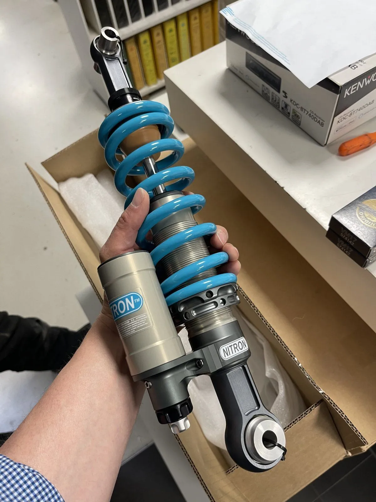

I am going this way…3 way Nitron set for Emira…brand new
Niceeeeee, can you report back on how those solid bushings affect the ride quality when you get them installed? Curious to know how much NVH and or knocking sounds those add. I've heard these all aluminum solutions from Nitron are quite noisy from a few people -- sure looks fantastic though.
Do you have any information on what spring rates they picked and what wheel/ride frequency they tuned the car for? Would save me the hassle of weighing all the unsprung parts if they did it already.

During the testride I found the Emira’s overall impression disappointing. Absolutely loved the Exige on Nitrons. People tend to forget that manufacturers employ beancounters, they need to to make money. So stock shocks are on a budget. When talking to Nitron they have set high expectations on how much this will improve the ride of the Emira. NVH wise, the Nitrons don’t change anything I think in the way the shocks connect to the chassis. One presumption people often tend to make is, is to associate aftermarket shock = bumpy and uncomfortable harsher ride. They don’t have to be and often improve comfort and ride quality since they are such higher quality.
What I want…more sharpness and wilder Emira that comes closer to my GT3 but at the same time offers a lot more comfort vs my GT3.
Has anyone driven an MC20? Then you know what I mean.
I'm strictly talking about the solid metal spherical bushings on your Nitrons located at the mounting points of the damper.
The OEM bushings that come with the Emira are rubber.
Didn’t know they were rubber on Emira. That explains. You don’t need to develop a good shock knowing there is rubber at the ends of it.
